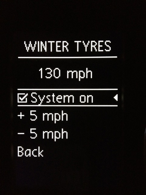

Does the "45" measurement change the circumference? I suppose it does. MAXIDOT has a setting for winter tyres, +5% and -5%, which I think is cool. I suppose that Nankang tyre would be +5%?
I've got these too! But in 15" on steelies. I find them terrible in wet conditions! Twice the back end has come out on wet roundabouts and I mean at 10-15 mph, one good thing is the TCS does a good job at straightening it back up, but I suppose if I was doing 30mph it would be a different story lol
It's not to adjust the speedo/ tyre size difference, it's a speed limiter incase you winter tyres are a different speed rating it's +5mph / -5mph
