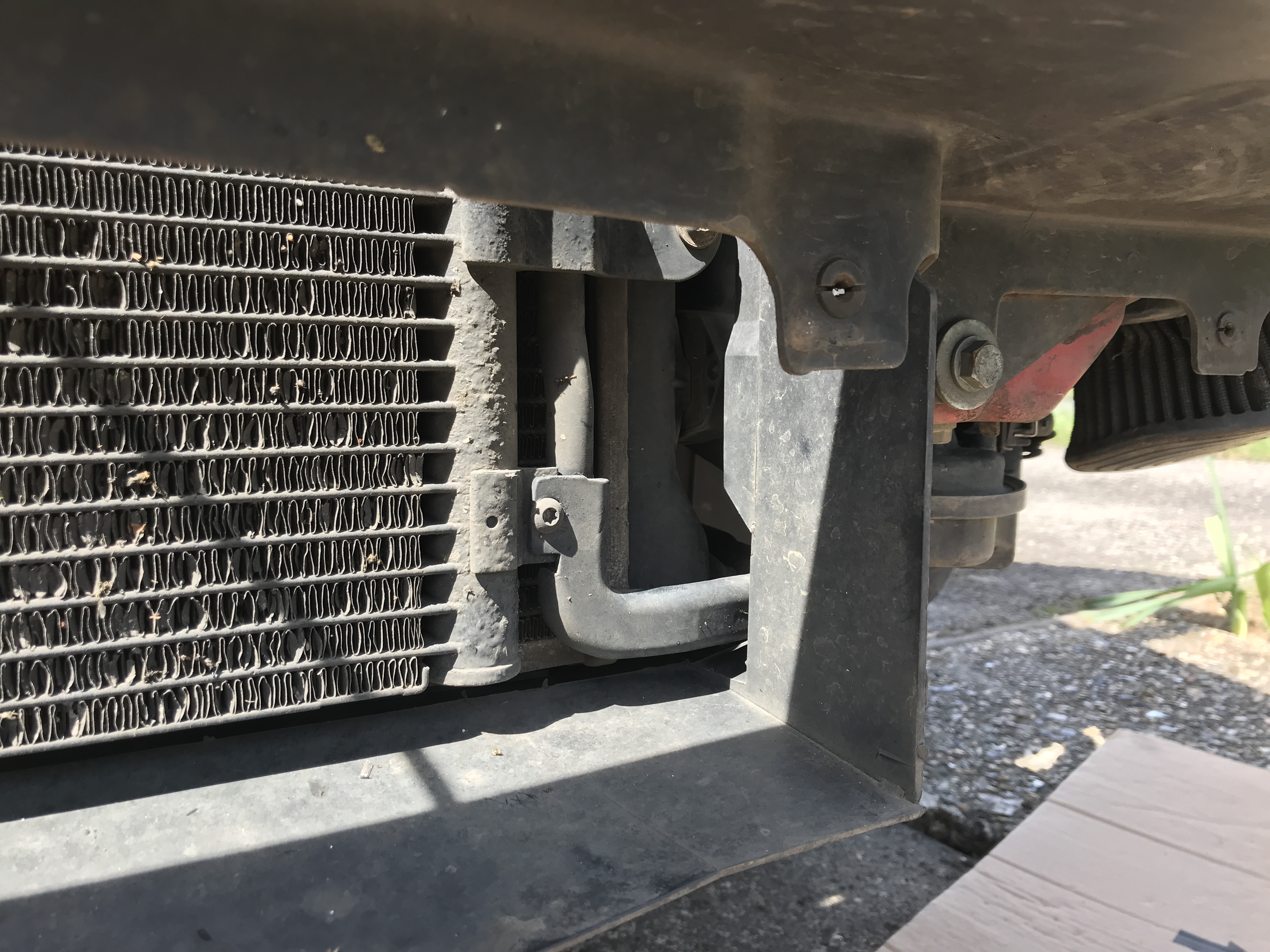

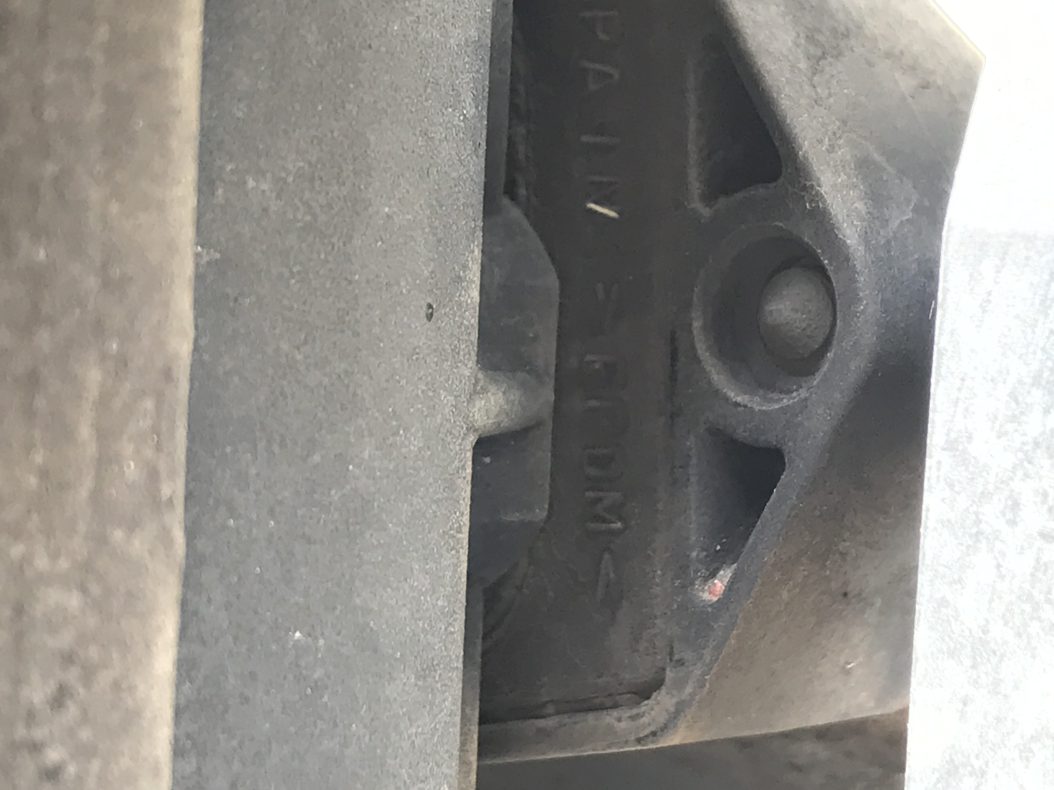

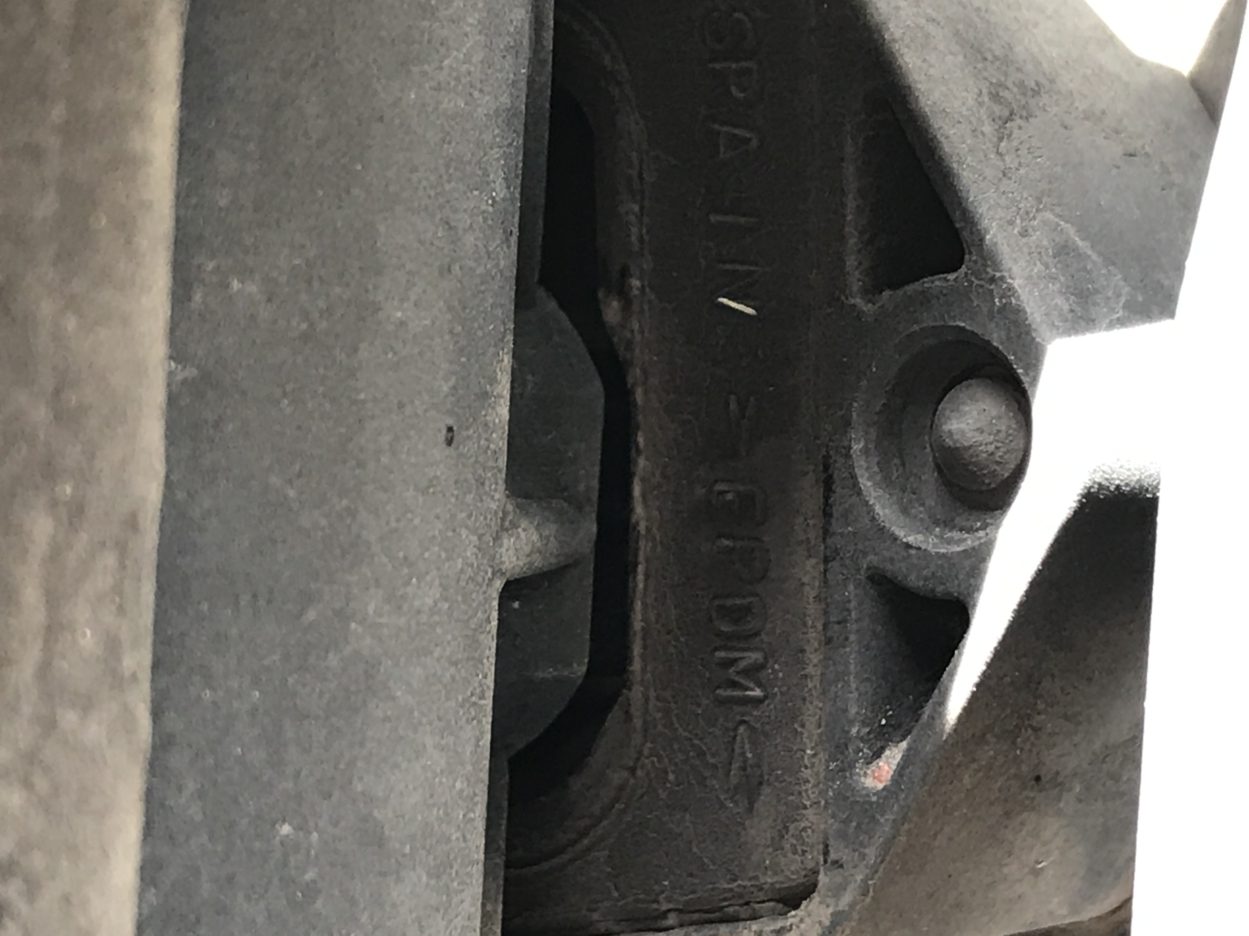

I know this is an old topic but just in case anyone else is suffering from knocking noise, I notice that I can push my radiator and it’s moving which has then knocked on something else. Finally finding the mounts they were shot.
Pushed back;
normal:6329D6A4-9C9C-48B6-B780-5B0A9A85BE3C.thumb.jpeg.b55da76bd81db96d218f8809dc219e63.jpeg
worth checking this for anyone who cannot find the knocking sound.
Mount is found to the right of the radiator:
