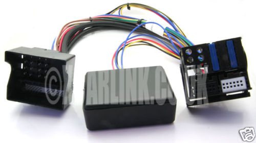

ive brought one of theses . Video in Motion for VW SKODA SEAT MFD2 MFD3 RNS510
Unlock your VW MFD2/3 RNS510 Factory system so you can view while driving.
If you have a factory fitted TV tuner you would be familiar with the scenario where you can watch TV/Video on your system while the car is stationary but cuts outs out and prevents you from using it when the car is in motion.
Our TV in Motion interface provides a simple and effective solution to this issue by unlocking TV/DVD system and allowing you to make full use of its features while driving. The interface simply connects to the back of your existing head unit and is 100% plug and play, no wiring cutting so there is no risk of voiding the warranty. Installation is as easy as removing the main wiring plug into the back of your radio system and then connecting it to one end of the interface, then connect the other end back in its place and your ready to go!
The harnesses are made using factory connectors to for complete compatibility and reliability and we also supply a 1 year warranty.
http://www.xcarlink....0&cat=30&page=1
Not sure that will work, all that does is block the speed pulse via canbus getting to the headunit, if your Zenec does not use canbus then it will do nothing.
zenec mc5600 dose have cambus fuctions
i no its alot of money but if it works il be happy if it dosent work it can go back
Gee Whizz £80 for that!
My Pioneer unit I just grounded the H/B wire.
BIG Nick :)
but your Pioneer AVIC-F30BT cost £978.00
i havent got that sort of money hanging around this time of year . my other half would kill me :thumbup: :thumbup:
WELL that xlink dident work http://www.xcarlink....0&cat=30&page=1
when i conected it up i lost all use of my mfsw and the radio wouldent turn off at the ignition :'( :'(

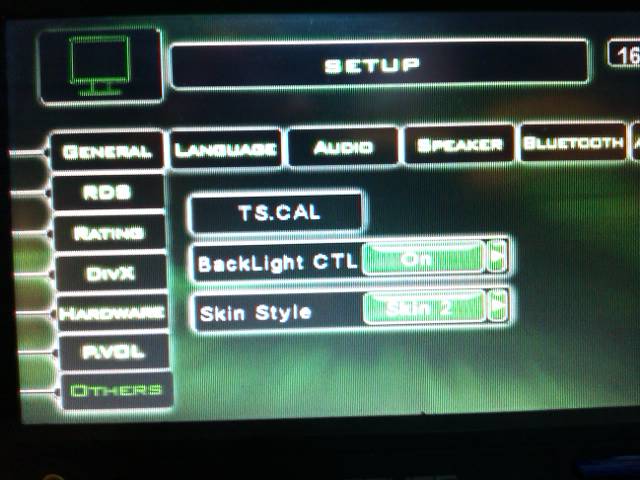

ZE-MC5600 parking brake bypass :
1. On touch panel select Setup - Hardware
2. Now on remote control, set mechanical switch on the side of remote to FRONT position.
3. step by step press 1, 2, 3, 4 buttons on remote (every pressing will be confirmed with tone)
4. New menu item now appear - with parking brake bypass option.
