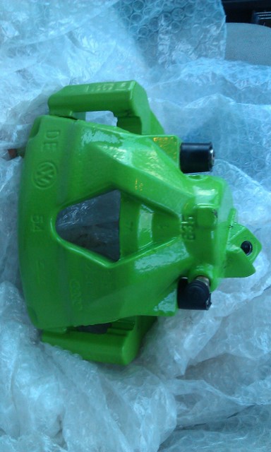

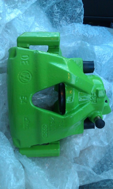

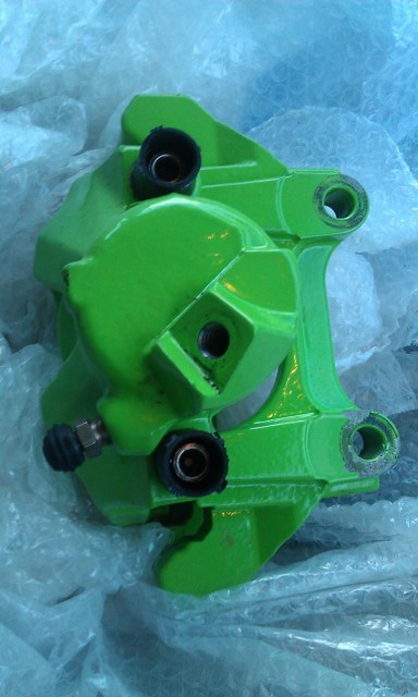

Just to make sure I'm not going to look like a Tw*t - this is the caliper they tried to fit on the offside
dose this look right to you
cheers
That looks like the passengers side mate.
cheers mate - will the bleed nipple be on top then - no expert on brakesas you can see
bleed nipple needs to be at the top. The pic is of a nearside caliper.
bleed nipple needs to be at the bottom. The pic is of an offside caliper.
getting confused now as just found this which is stated as left caliper for Octavia which is exactly the same as mine

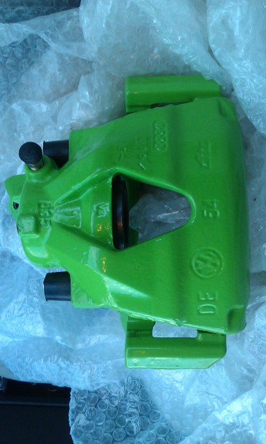

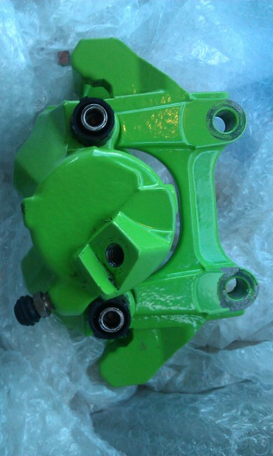

heres mine

this is an offside caliper, the nipple will be at the top.
Ignore my post as i edited it after you quoted it! Got confused myself!
Your post #15 which shows your caliper would have the nipple at the bottom if fitted to the offside. which by deduction makes it the nearside caliper, so theyre fitting it to the wrong side. Theyll also be impossible to bleed up if the nipple is at the bottom.

Bleed nipples are always on top as you wouldn't get the air out fully if it was on the bottOm
