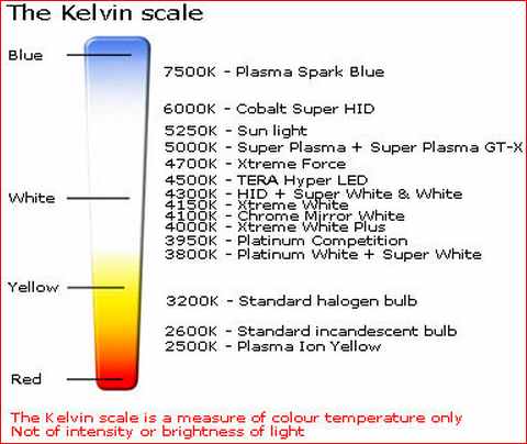

The wattage is always seems to be the same, but what you can get is a different colour range. Standard ones are 4300 ?? and then you can get more white/blue ones. However there have been several reports elsewhere of people failing MOT's when they go above 6000 because the output is too blue.

You don't gain "light on the road" by upping the Kelvin...... Look at all the London boys in the Bema'z and E-classe'z with 8000k+ Blue lights :@ ...
Good for showing up reflective paint or police cars or scorpions, :rofl: But pointless at helping you see where your going.
Human eyes respond best to true pure white light (4300K).
