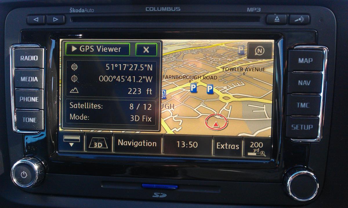

Where is everyone looking at the Satellite info? Ta.
Sent from my iPad using Tapatalk HD
Turn on Columbus.
Press 'Map'
Press 'Map' again to bring up split screen.
Press the header on the new window.
Scroll down to the last item.
Press that.
See attached file for a picture I took earlier...
