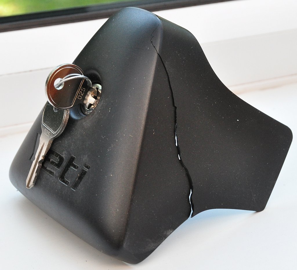

I assumed as much, so wasn't going to bother getting in touch with the dealer...
- but -
...when I finally got round to fitting the bolts I took the second roof bar out of the box (sat in my garage since collection in June) to find this:
Dealer says they'll need to swap the whole package unless they're told otherwise.
