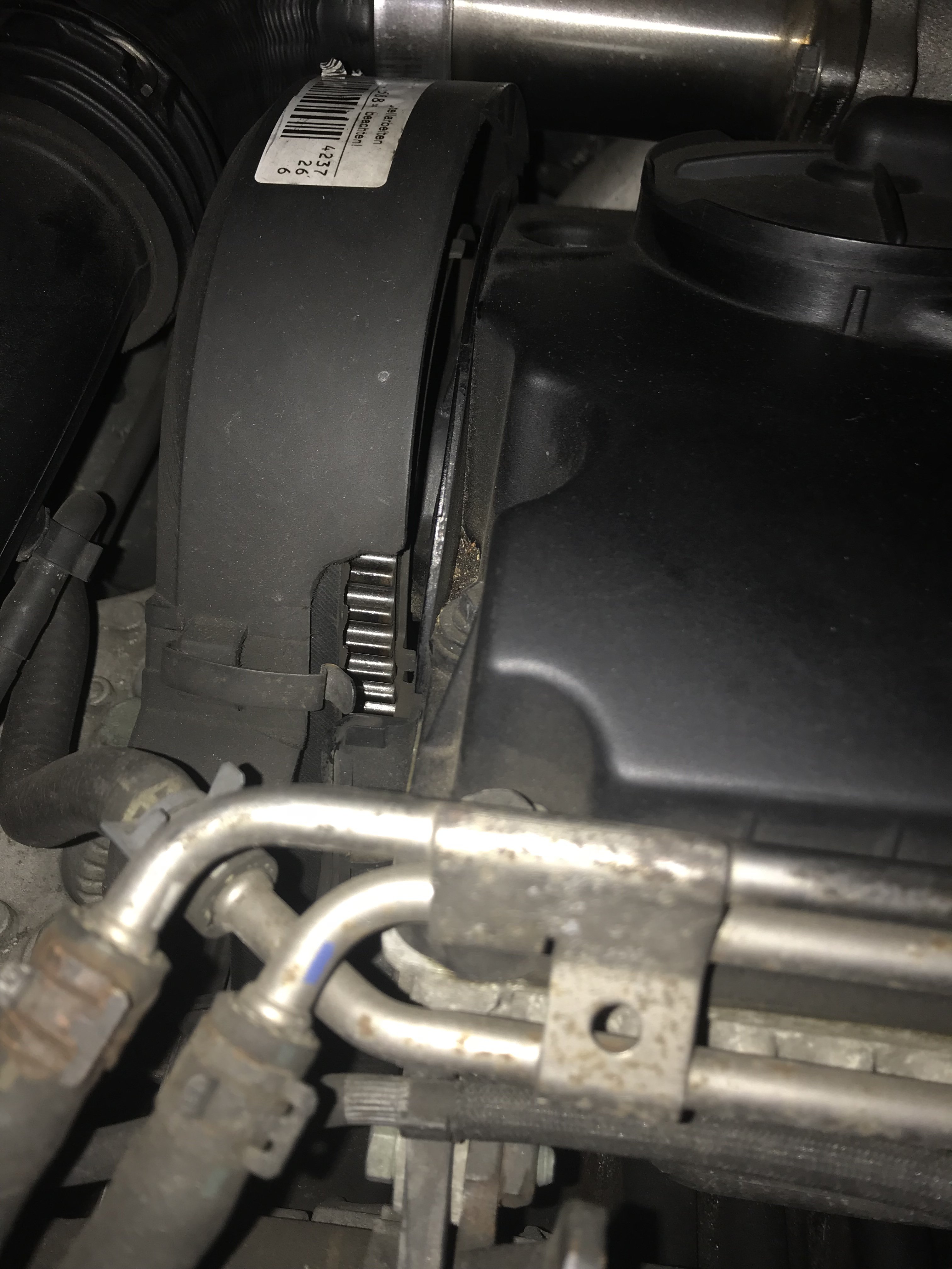

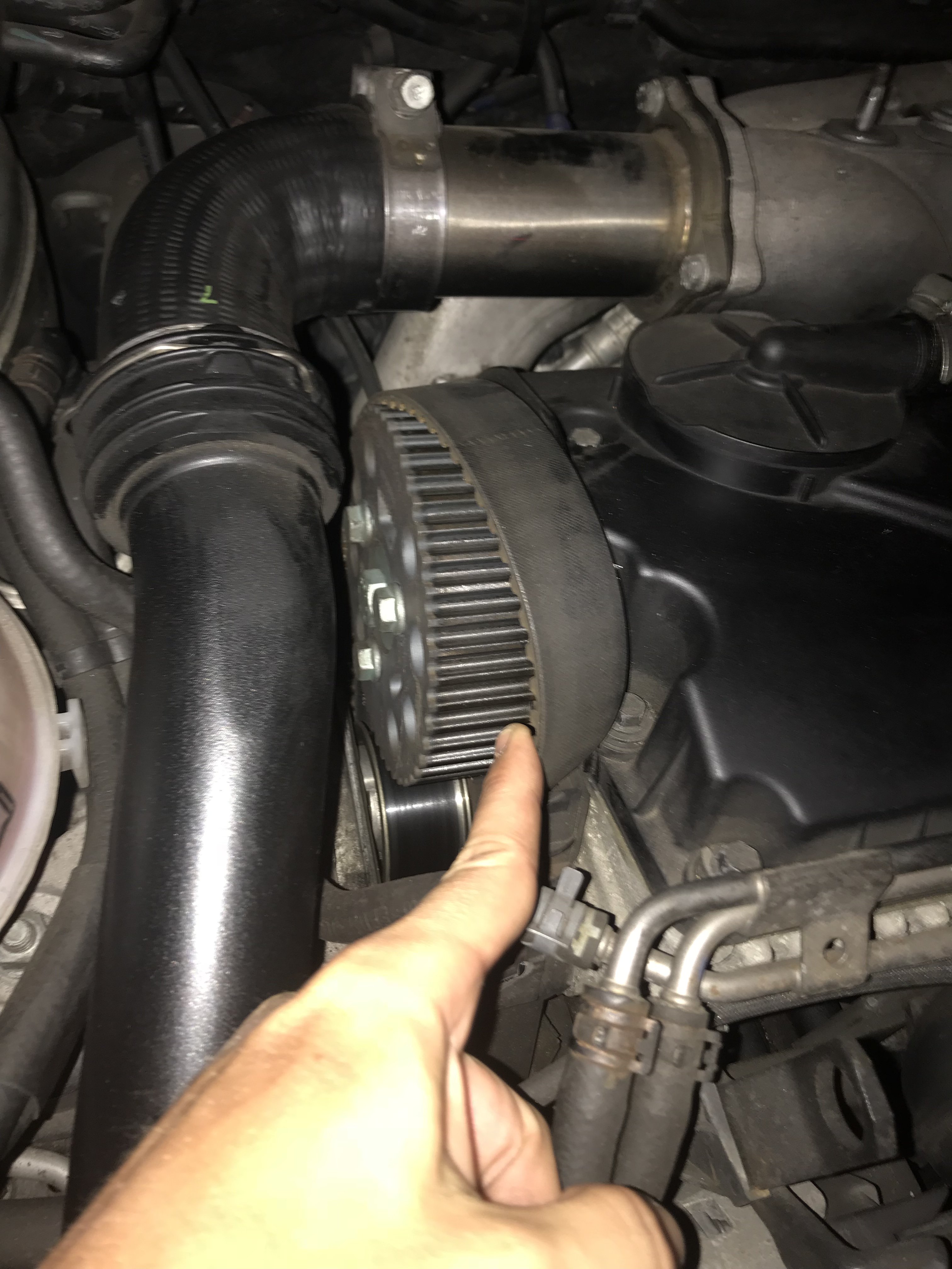

Was on my way to see my mate grr666, accelerated off a round about, into third gear then pop. Lost power. Initially thought I had popped a hose, two seconds later realised I literally had nothing from the engine. Clutch in then she died. Clearly more than a popped hose.
After checking the other basic things decided the only thing left to check whilst I was waiting for grr to arrive to tow me was the cam cover. The second it popped off I could see the belt wasn’t in sight :o
Once the cover was removed the belt had clearly lost all tension. :crying:
At this point I have no idea what damage has been caused or what has failed, belt or tensioner, but she’s at my mates garage ready and waiting for him to arrive in the morning.
Checked my records.... cam belt changed 3 years and 360 days ago, although the dayco tensioner failed within a few days after so went back in.
Annoyingly, she was serviced January just gone and when I asked for the belt to be changed I was categorically told three times by the chief mechanic it was not due. Despite my fairly good knowledge of this car, I bowed to their professional advice, after all I am not a trained mechanic or engineer (after three times telling him I disagreed with him)
I’m hopeful that as it is my mates garage this will get sorted FOC, but worst case I have to drop in the engine from my doner car.

Well, she does lives on.... My mate had her in for two weeks to slowly take things apart and see what was damaged. I got very lucky.... four bent valves and that was that :dance: £500 later and she was back with me.
Lesson learnt .... from here on in I will stand by what I want for my car regardless of what I’m being told it needs by a mechanic.

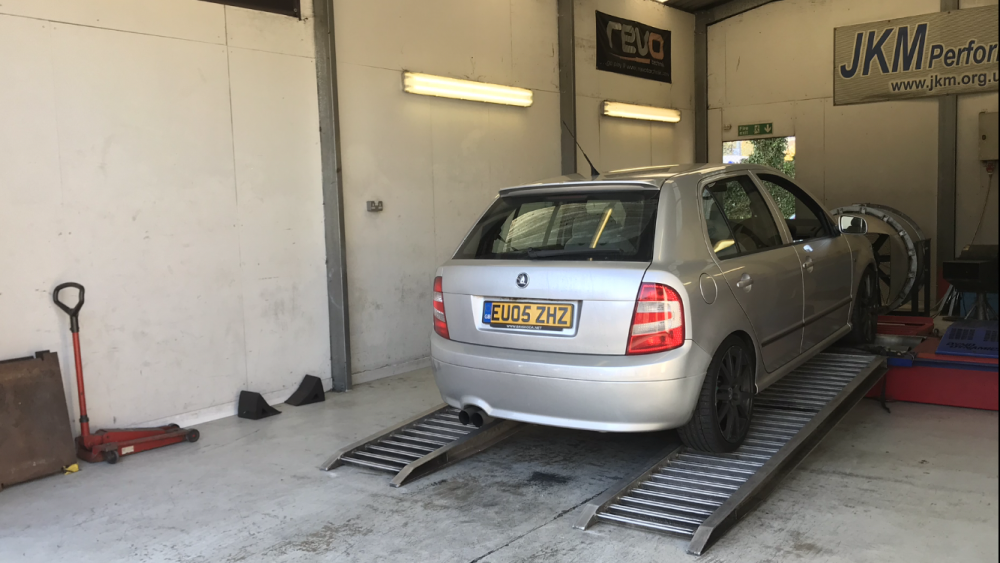

The one thing that has happened.... finally put her on a rolling road :clap: Been trying for the last two / three years to get down to the JKM sessions but something has always come up. This year I was adamant it was happening.
A quick offer of a night in a hotel and an appointment on the Isle of Wight for wedding stuff got Zee on board, although to be fair she loves it as much as me and has been known to encourage things car related.... she’s a keeper :heart:
Anyway, set off at 6:50am yesterday morning for the 2 hour drive from Bristol as I needed to be one of the first to make the crossing early afternoon.
I’ll be honest, I was nervous! I don’t spank my car everywhere, I’ve still never properly launched it from a standstill and can’t recall taking it anywhere near 5k revs. Smashing it right to the end had the potential for something to go wrong, but it didn’t :rock:

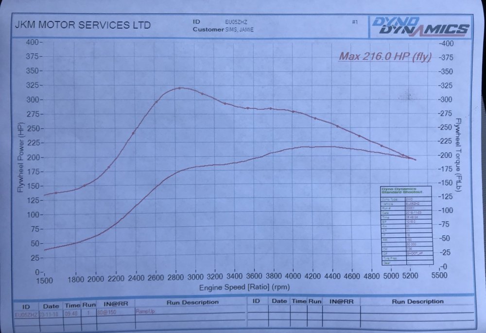

Dirty Torque plumbed in the turbo and mapped it in and reckoned it was running about 220/300 but didn’t have their rolling road installed to check. I was not worried tbh, I just wanted a car that went well that also preserved the new-ish clutch.
So, after four years I can now tell people what she’s got when asked :giggle: a decent 216 bhp and 325 torque.
I say decent and not healthy as I’m not sure the graph shows a healthy car.....
A little surprised to see a dip in power between 3k and 3800 revs. In the last four years I had picked up that there was a slight surge in power and big puff of black smoke when I was giving it some, so was expecting to see a sudden jump up at about 3500 revs because that’s how it was mapped to look after the clutch. I guess this is not the case and I need to check pipes for holes, loose connections etc?! Not the end of the world and not concerned though.
