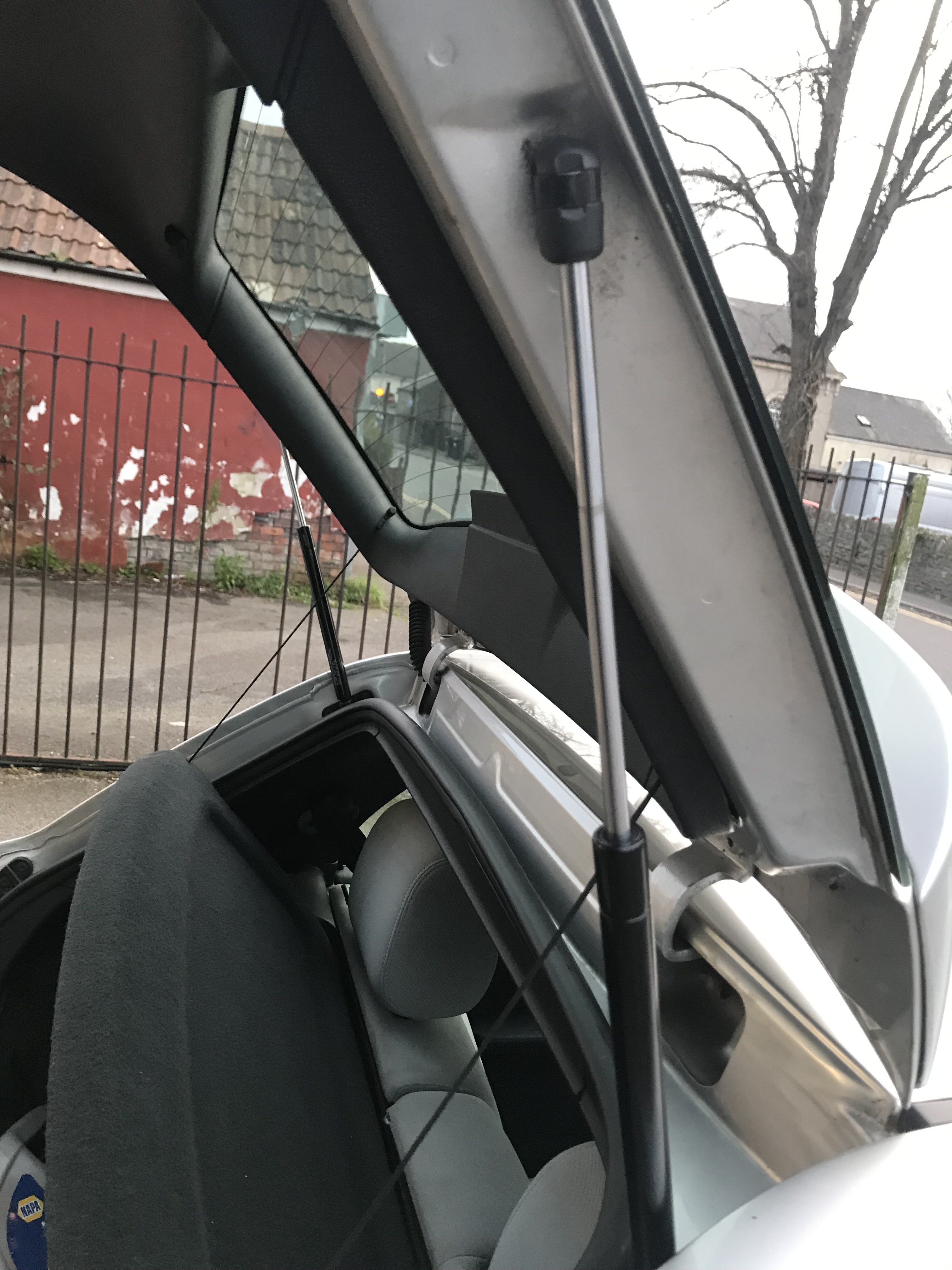

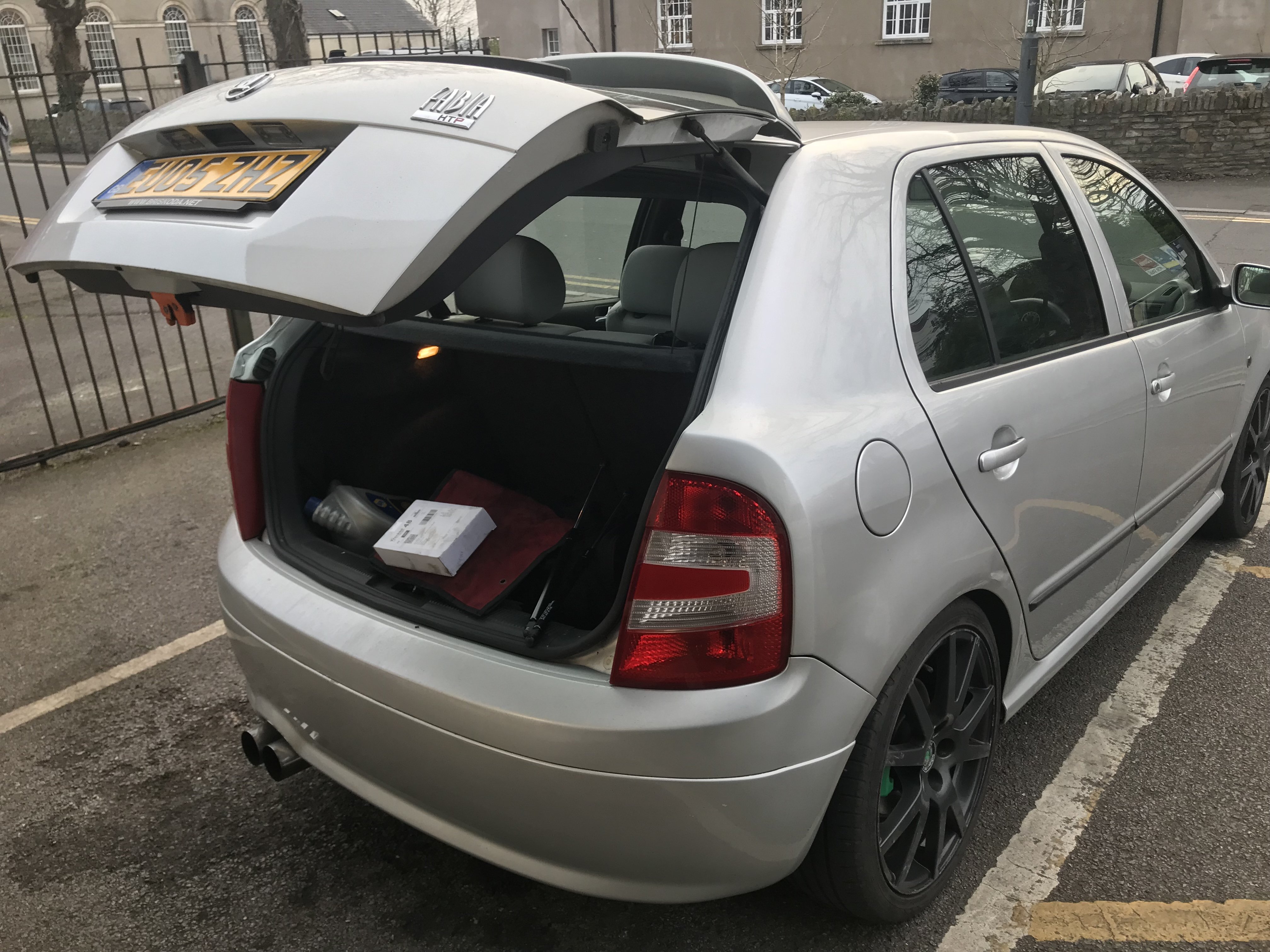

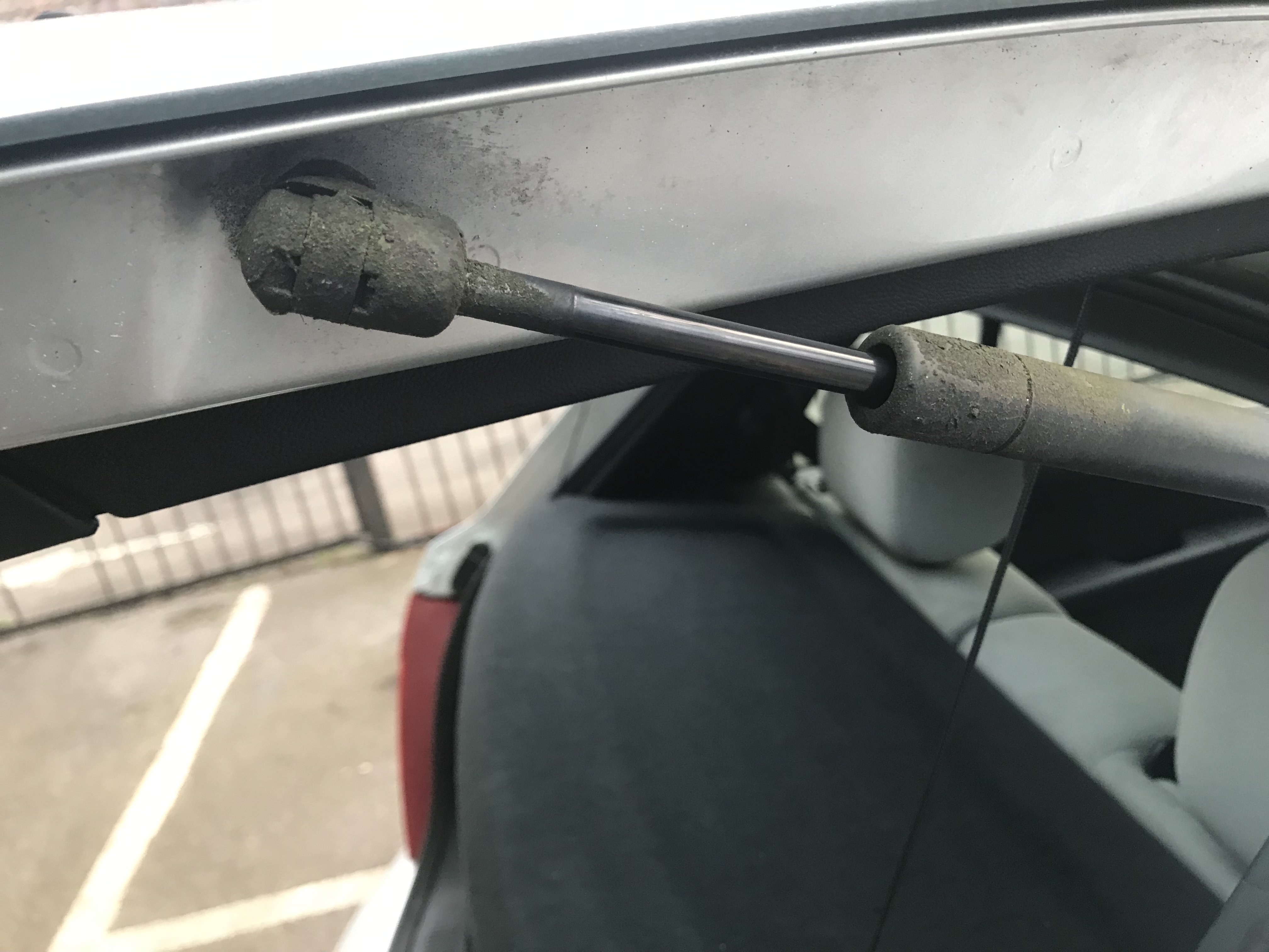

I have now managed to replace both of my tailgate struts as mine have been goosed for a wee while now. Found two on EBay for £15 that come with a life-time guarantee. Decided on these as I’ve fitted several different brands from differing motor factors at work and I’ve never really been impressed with how they felt…. A little cheap to be honest.
Gotta say, the eBay ones feel really well put together and strong.

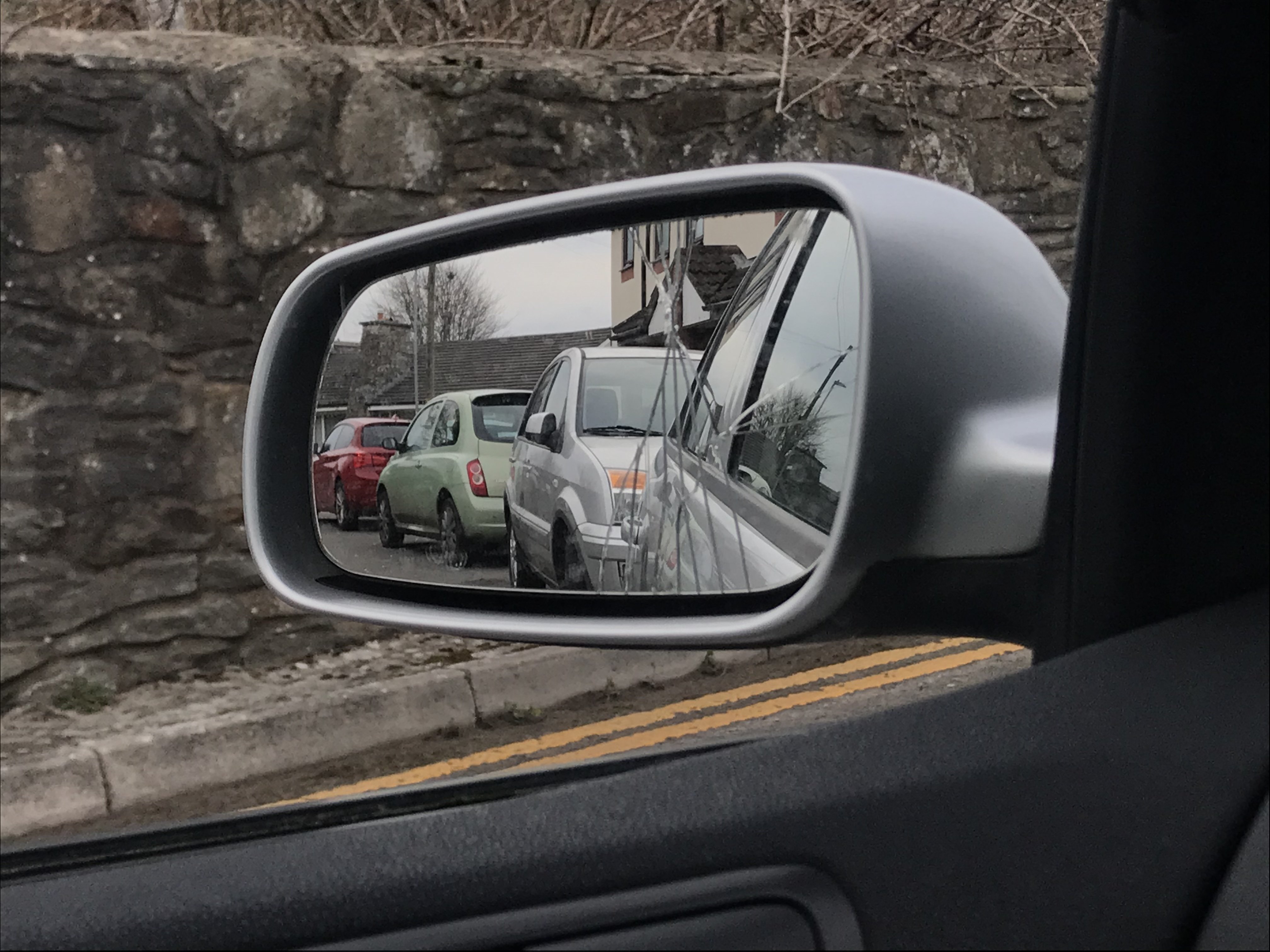

I also went to replace my passenger door mirror as some **** smashed it, but the numpty seller sent me the drivers side. Not even apology from them! Gonna be few days for another one arrives, from a different seller!
