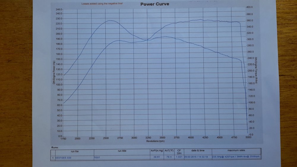

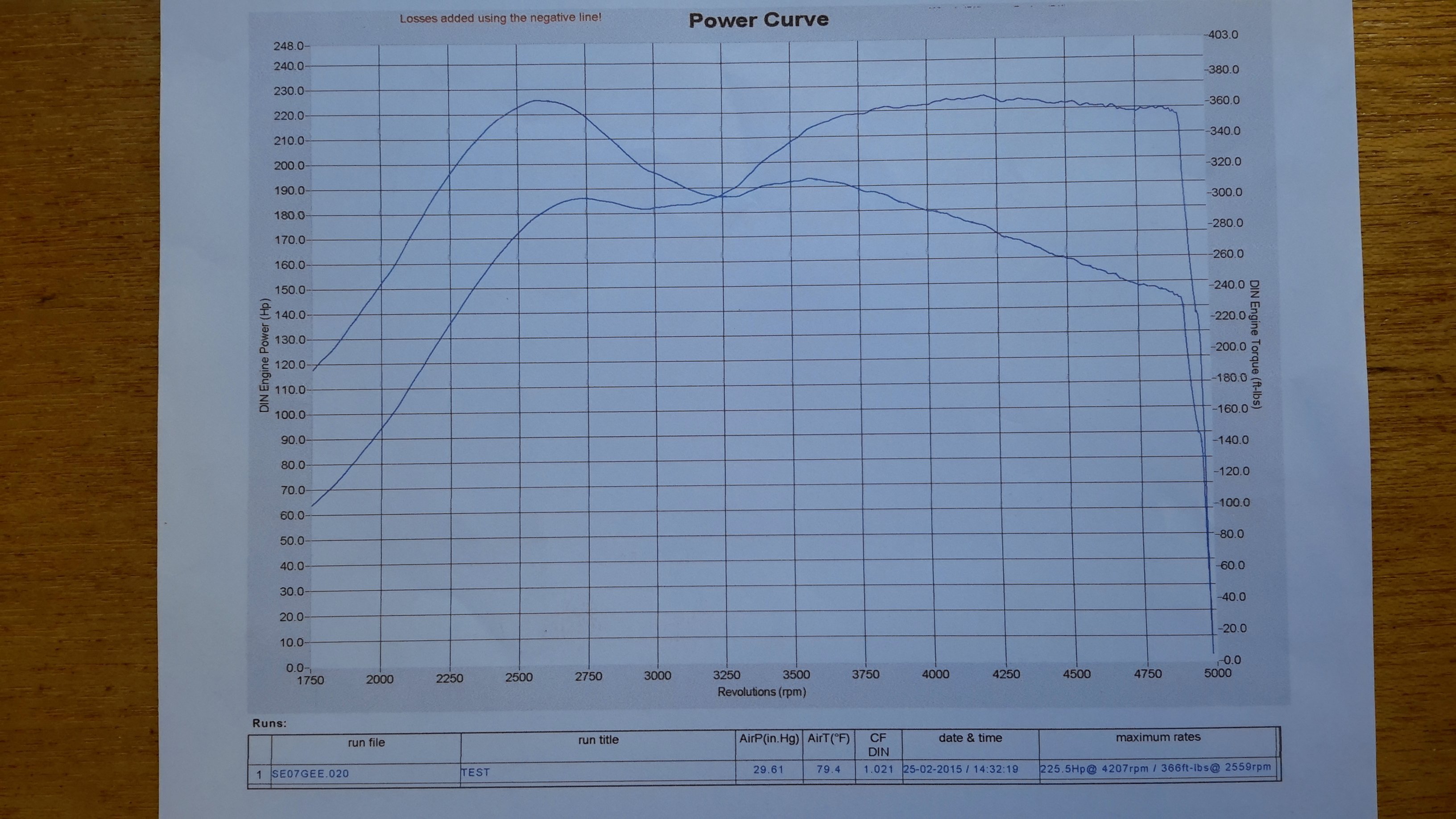

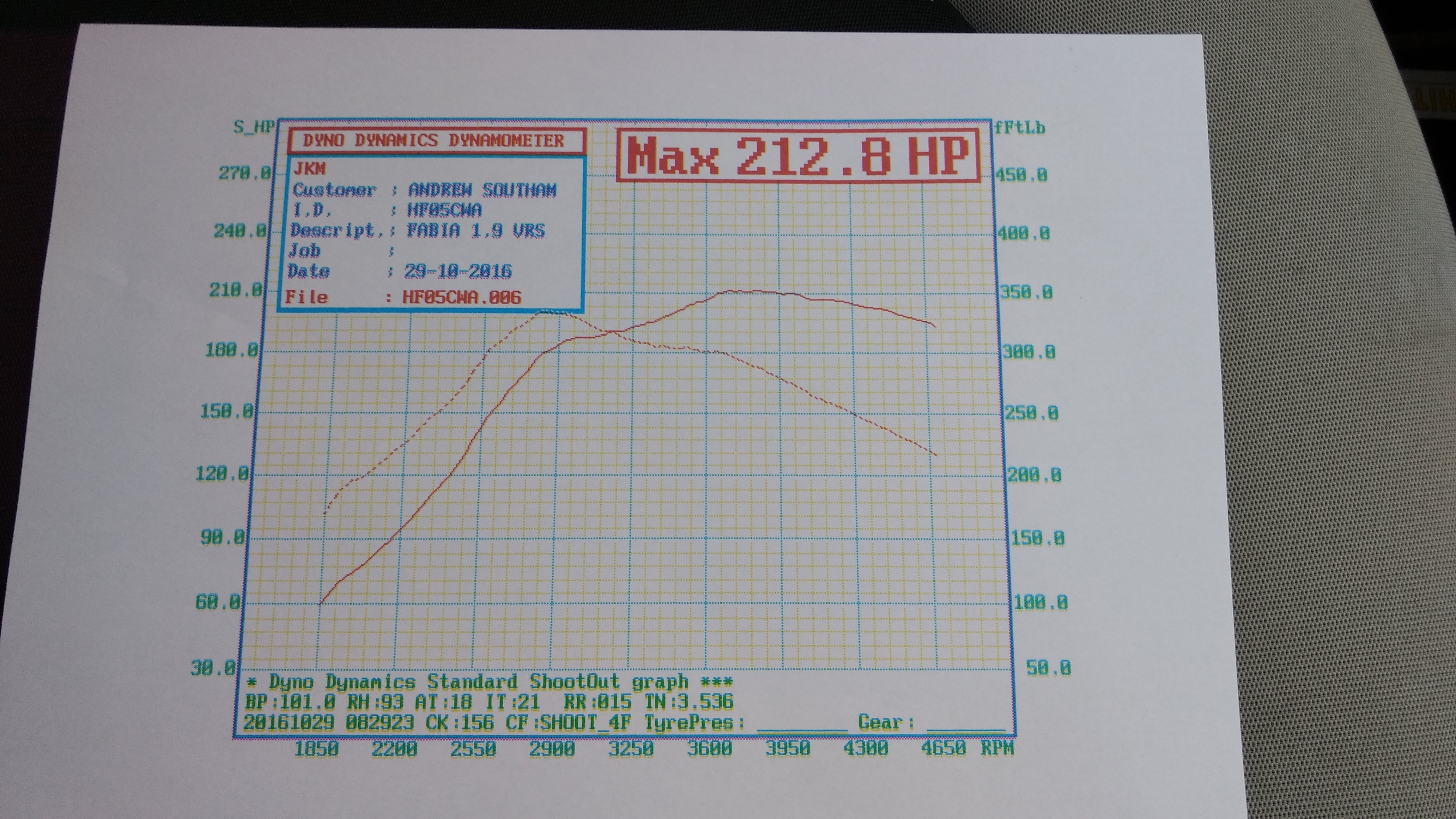

I’m not sure what turbo you have fitted as I read your complete project back in Jan, but I believe it was a PD150 Hybrid? I also have the exact same dip and had mine mapped to save the standard clutch. I believe it’s quite common for these hybrids to have a dip. See my dyno below.

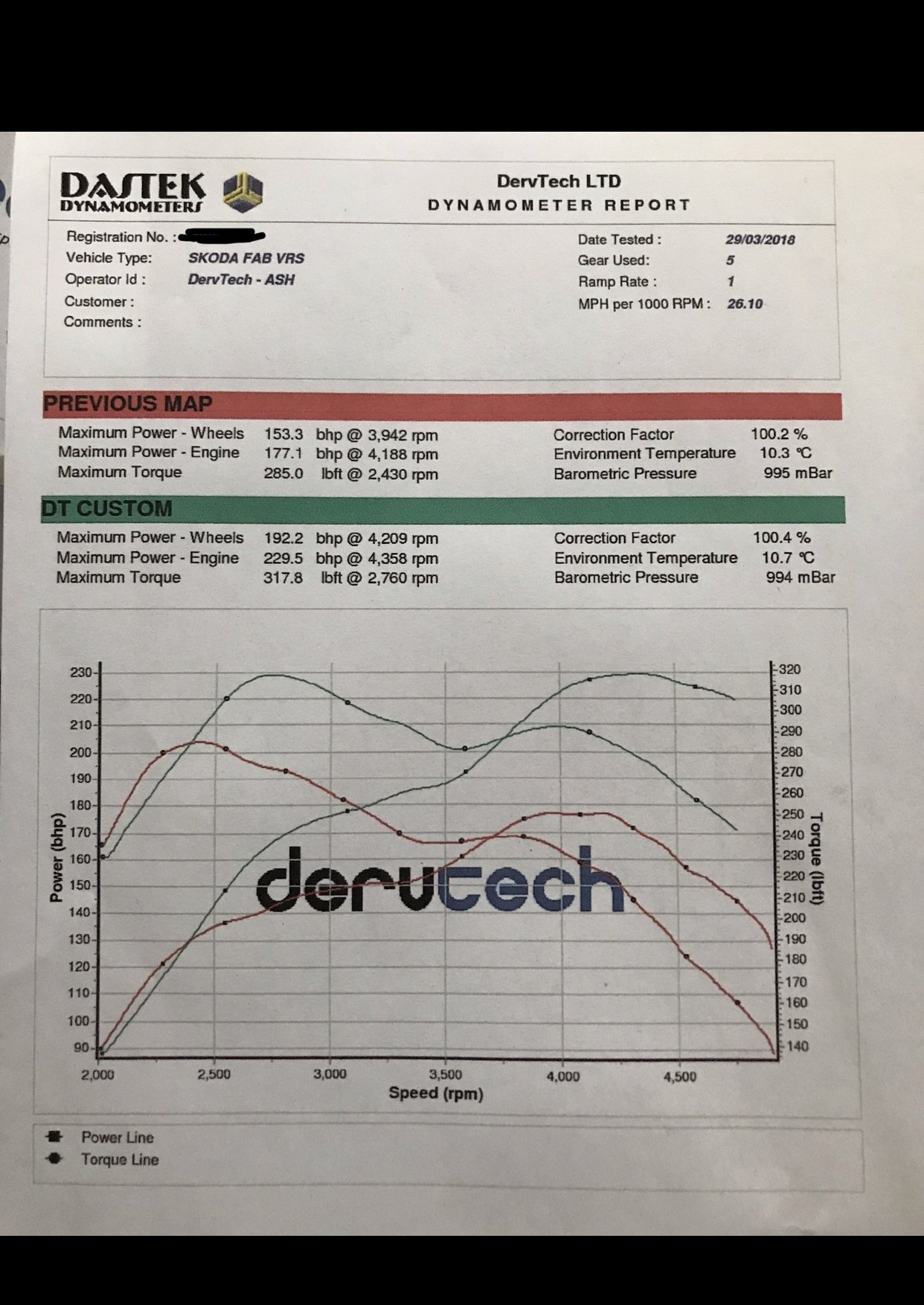

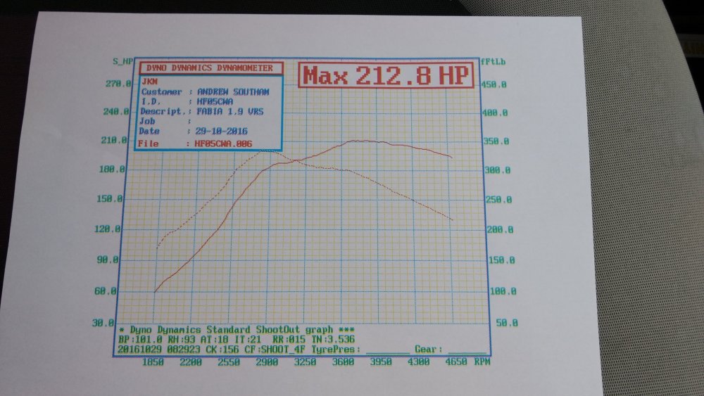

Interesting. I have a pd150 hybrid and has a similar dip as well
Interesting, AJ! Yeah, I'm running a PD150.
I did take a bit of comfort when I saw your graph, Charlie.
I’ve decided to take today off work, so will see if I can find other pd150 dyno runs and see if they’re similar, but I can’t feel the dip and no concerning boost spikes so won’t look too hard!
That power figure and graph looks identical to my Hybrid 150 as well on my black vRS. More than punchy enough for a daily!

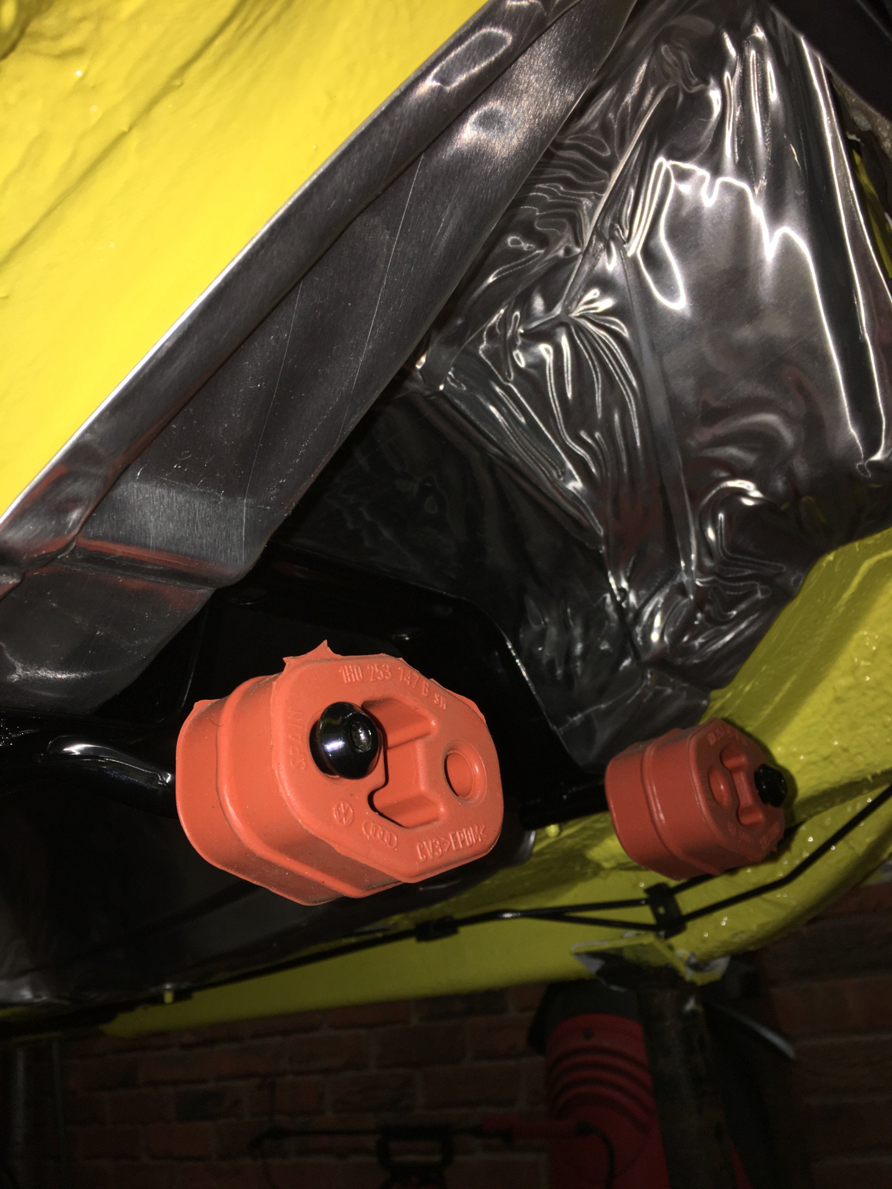

What was the rattle you had diagnosed then???

That’s enough for me. Not gonna chase shadows as that’s four of us with similar graphs :)
Yup, not gonna set the world alight but plenty there to keep me entertained on the way to work :angel:

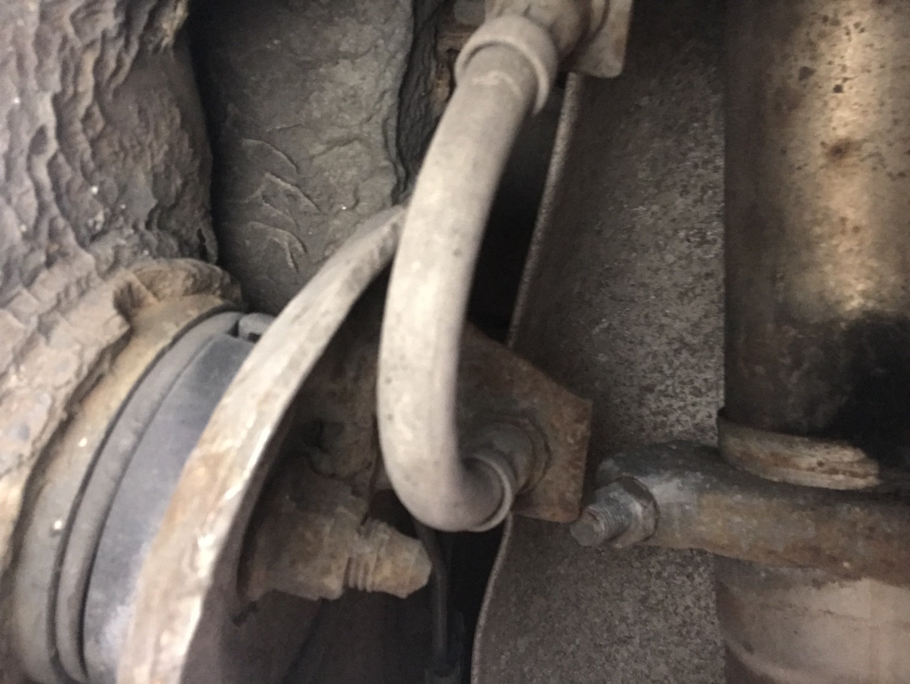

If I heard him correctly and understood what he was saying (I now wear hearing aids, which haven’t solved all my problems) there’s a silver, metal brake line running close to the exhaust that he reckons has somehow gotten close to the exhaust and has bent or moved after getting really hot?
As as I say, I had heard it a couple of times these last few weeks, but was never able to replicate it to try and find it.
It must have gotten REALLY hot on the dyno as it was a constant the minute he reversed off. To that point i had only ever heard it when reversing, but it was happening as I was driving away to park up. I left an hour or so later, by which point it had completely stopped and hads not been heard since.
I’ll pop out and take a pic of the offending pipe later this morning and post it up.
The hard brake lines should be clipped against the chassis rail which is almost under the passangers right foot, then comes out into the engine bay against the bulkhead up to the ABS pump. It's probably popped out of one of the semi rigid fixings and is touching the healshield above the exhaust. Ball ache to get to tbh but you might get a hand in above the heatshield from inside the engine bay if you have really small hands??
I lied... that's my old memory for you!! The brake lines are alongside the heatshield, as you can see here on my yellow one, so you should be able to get to them easy!!!
I have massive hands for someone so slight (symptom of congenital heart disease) so I’m glad it looks like this fix is out in the open :biggrin:
As soon as he got out he went round to under the rear passenger door as that’s where the noise was coming from and pointed out the pipe that was knocking. That said, Zee contests that she could feel it under her feet before the weekend, so also ties in with what you reckon.
Mine too had a dip. Good to hear the cars running well after the cambelt snapped.
Well, I think that solves that, a quirk of the PD150 it is.
Popped out earlier and took the added picture of what the JKM tech said was knocking..... I believe it’s the exhaust clamp knocking on the brake hose clamp, but only when really hot.
Yep, my PD150 hybrid also has the dip (from a couple of years ago) :D
Was a good day :thumbup:
Just wants slackening off and moving round a touch. Job done
That’s what I was thinking / hoping :thumbup:

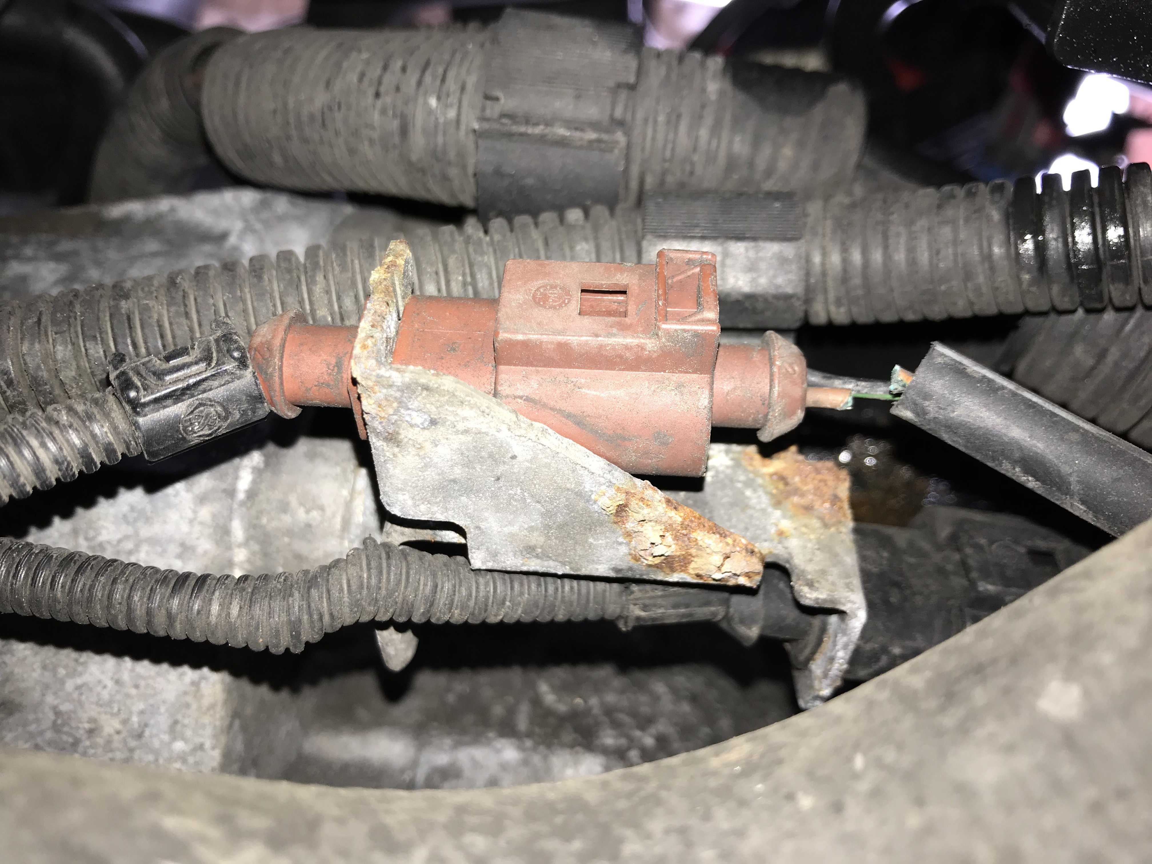

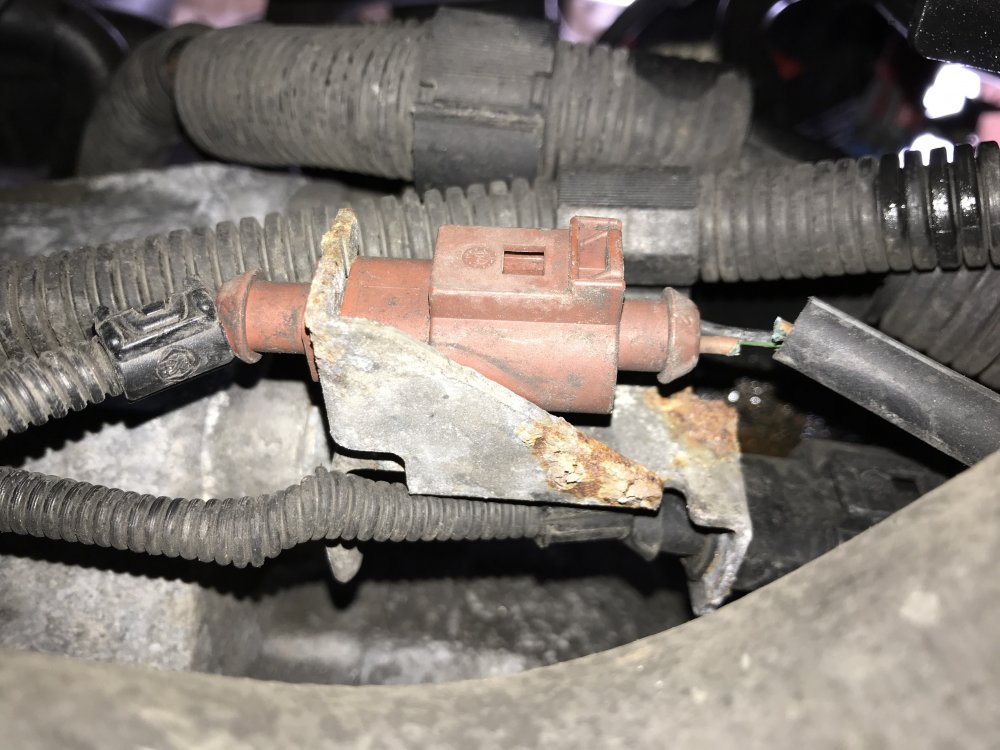

Not long after my cam-belt snapped in March 2018 I woke one morning to go to work to find my battery was flat 🤬 After taking a look at the alternator load signal wire in front of the gearbox, which was not broken, I noticed the A/C control wire had snapped.
I recharged my battery and fixed the wire and not had the same issue. Fast forward to the next hot day and noticed that despite not having A/C for the last 5 / 6 years, it now works 🖖 Just need to re-gas it now.

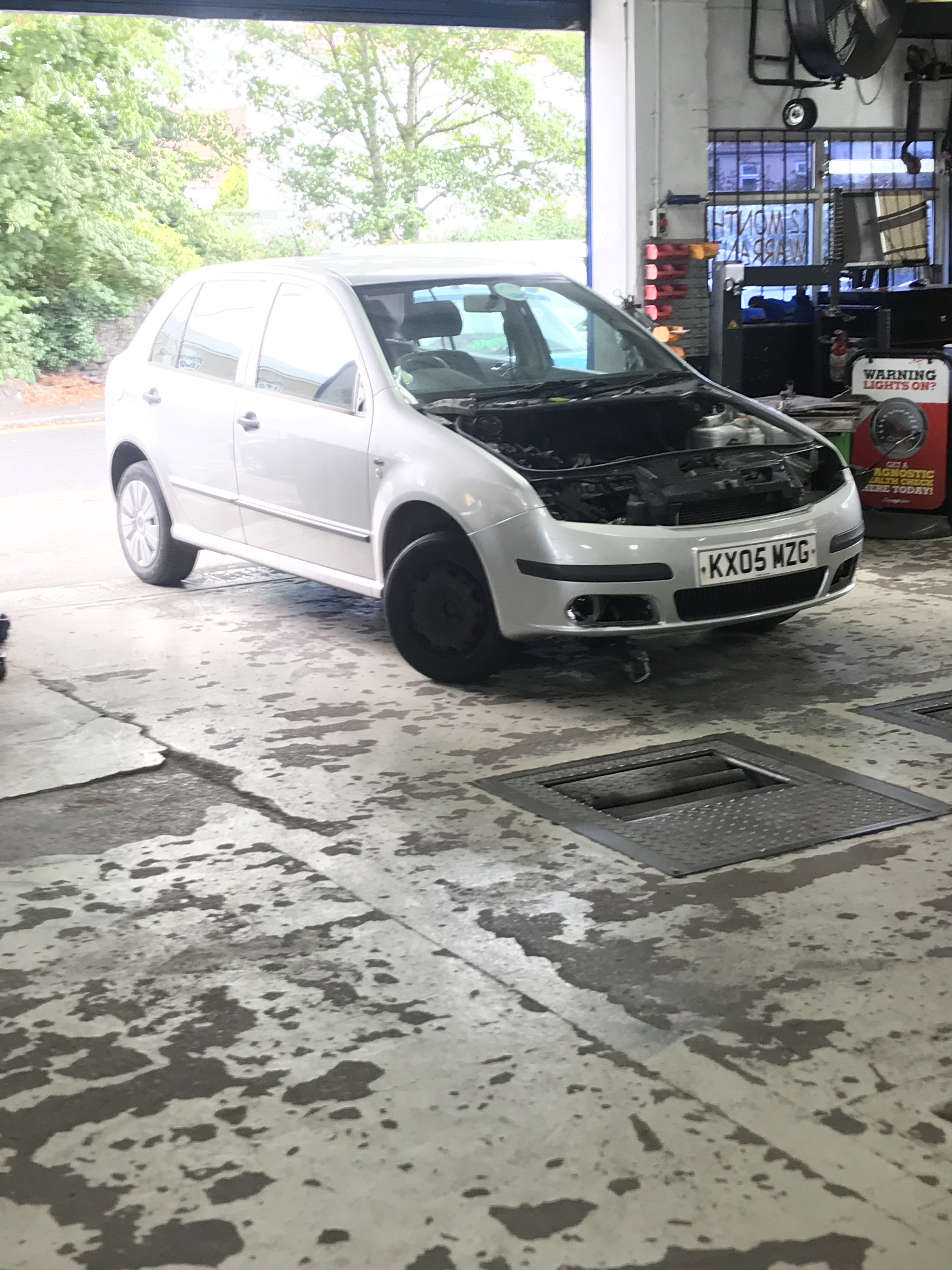

However, we did have a silver Fabia with a failed cam chain come in our garage two weeks ago. We took the head off and came to the conclusion that all the valves were bent. The customer didn’t want it, so sold it to one of the other mechanics for £50 as he was going to fix it and sell it on. We did make a start, but he gave up on the idea as he wasn’t gonna make enough money on it.

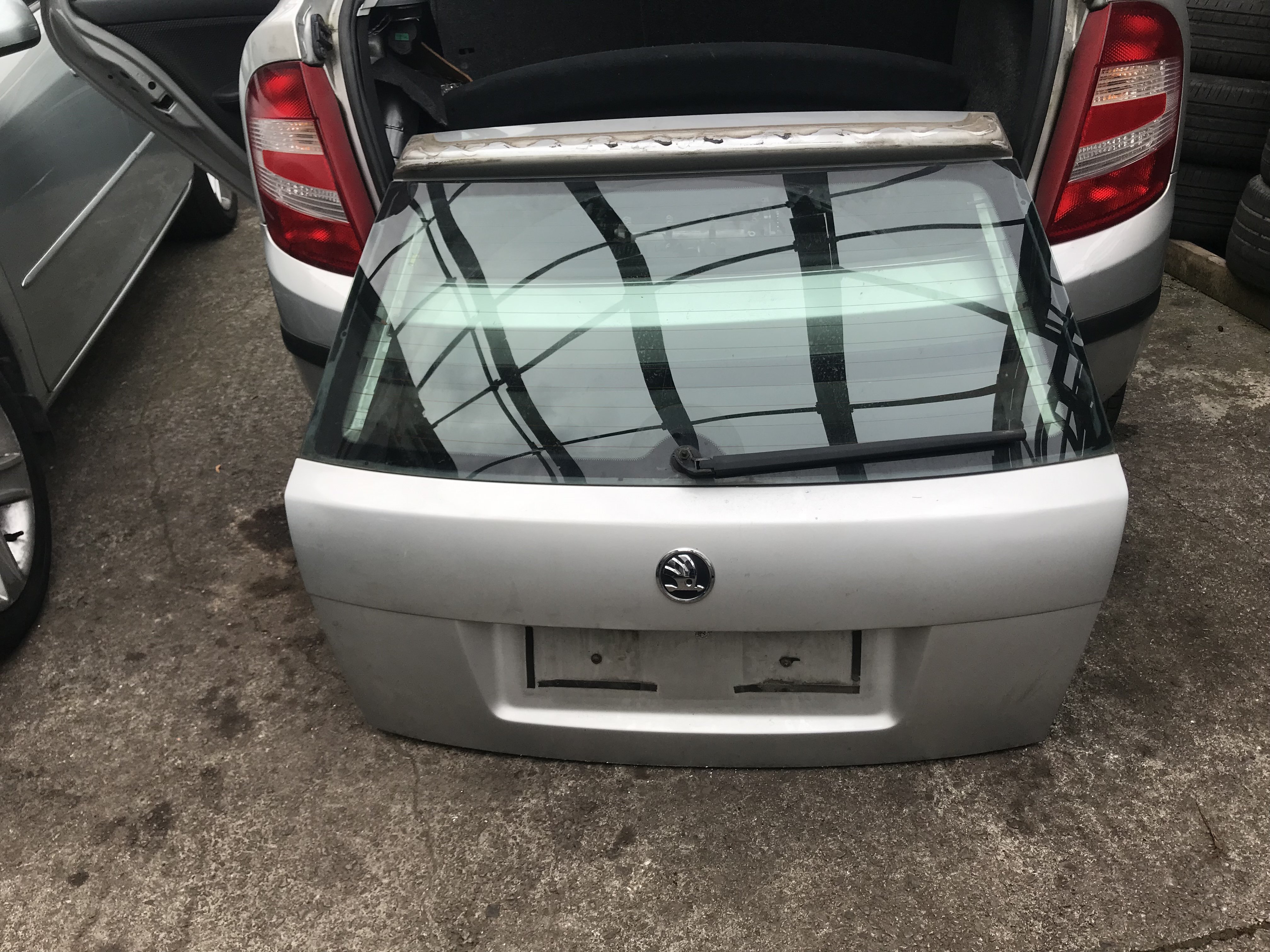

So, I’ve taken the halogen headlights, A/C pump, heated door mirrors, the alternator, bonnet and tailgate as the rust on my tailgate has reappeared!
Edited by jars

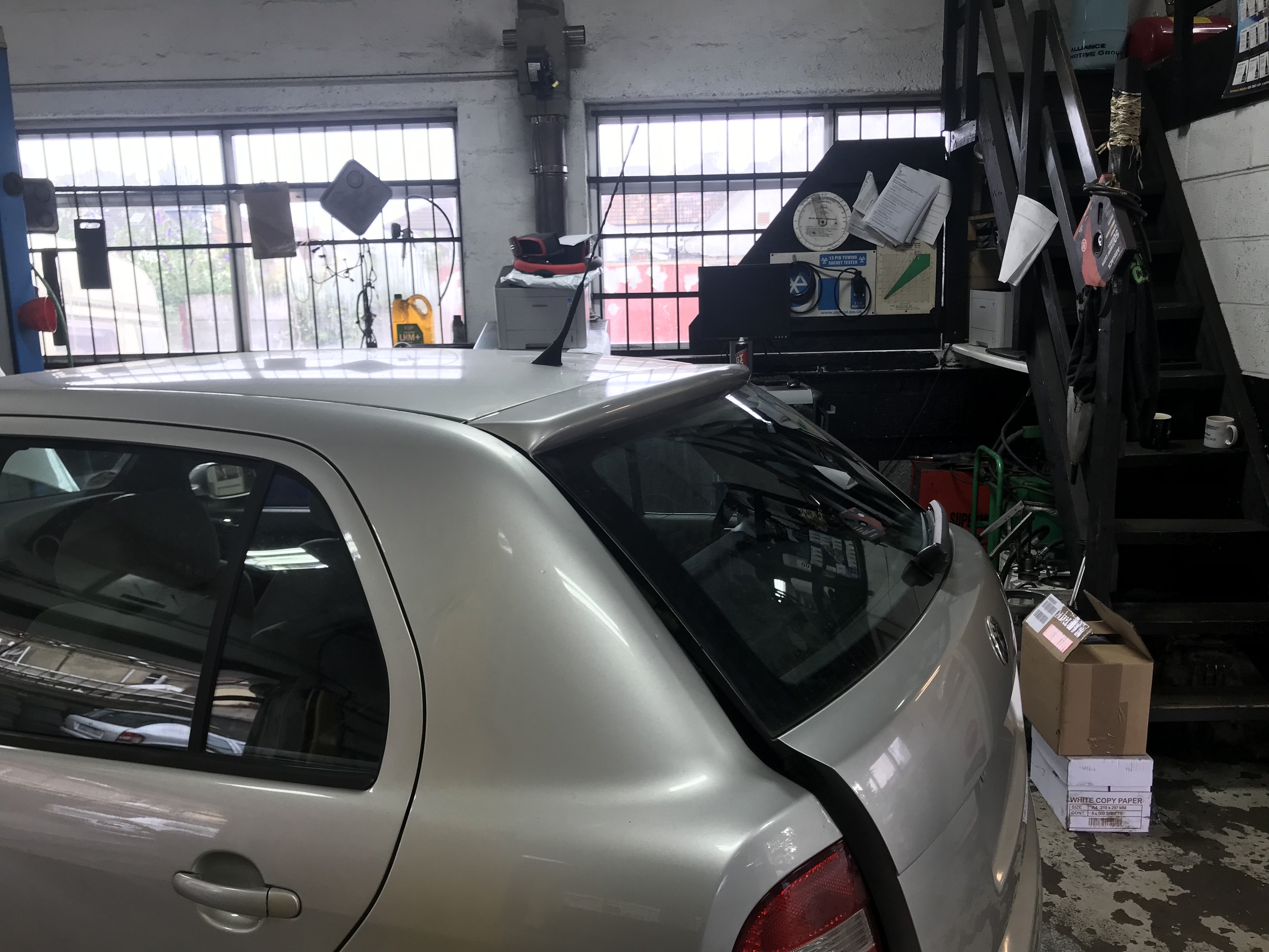

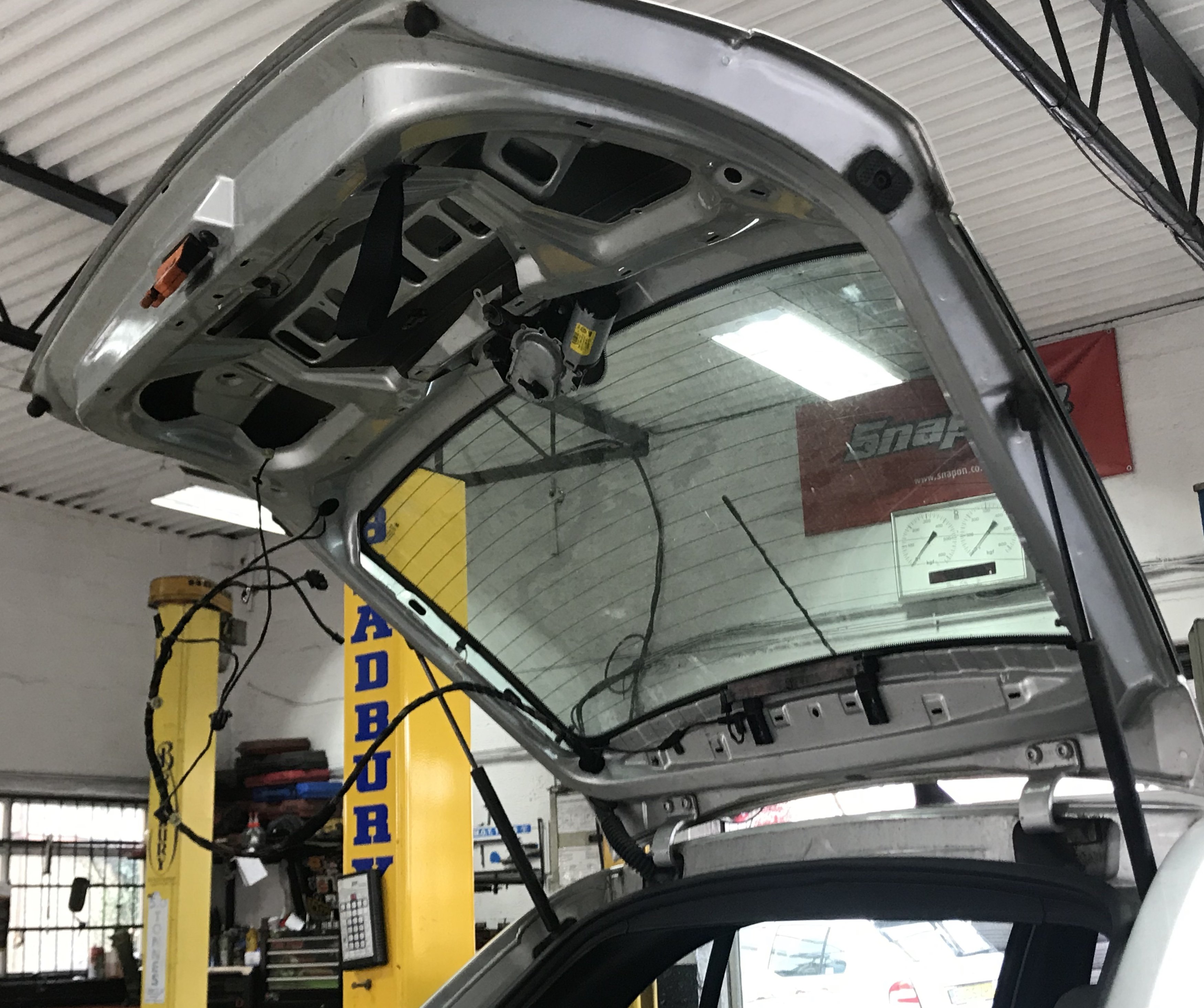

.... it was a 1.2, which of course does not have the vRS tailgate spoiler, so had to take it off mine and re-bond it to my new tailgate.
I simply cut the wires on the tailgate on the 1.2 Fabia and pulled them out and used the wiring in my own car as felt this was easier than the alternative.
Edited by jars
I’ve also changed my bonnet as I had two nasty rock chips(!) that have gone rusty.
As I've still got the HTP badge on the tailgate I’ve been considering keeping the 1.2 bonnet grill on without the vRS badge 😇 but may change it at a later point?!?
