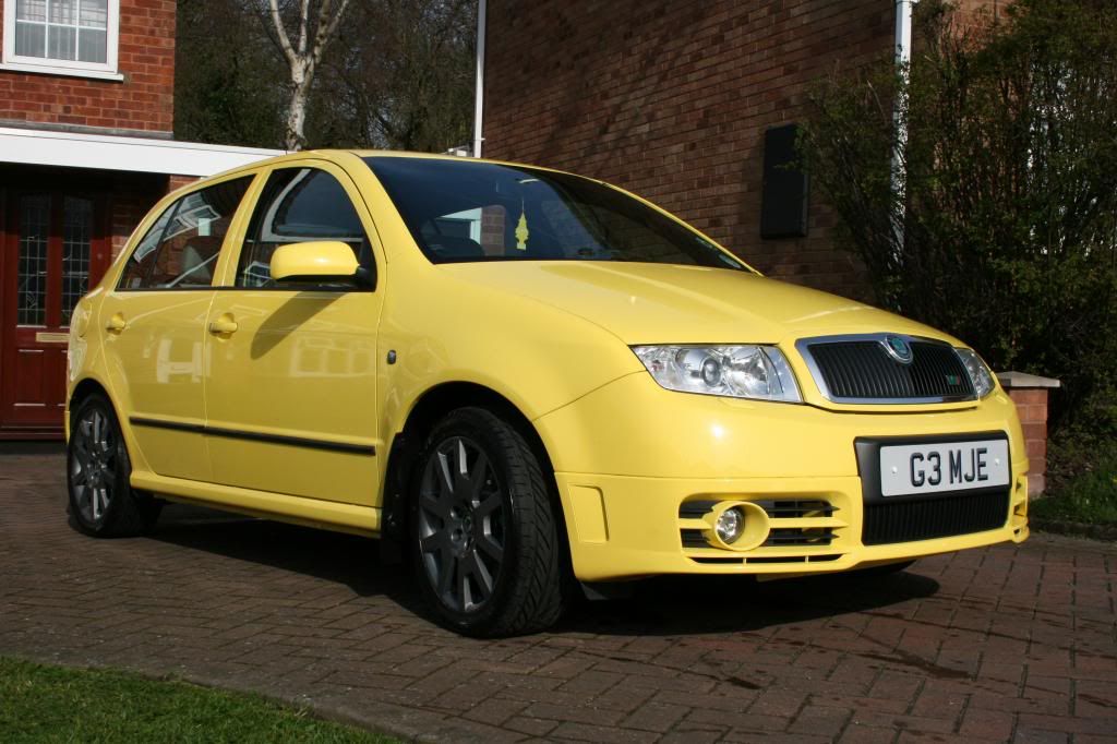

First pictures when I got it home..
The more eagle eyed amongst you will notice the rear door cards missing in the last pic, yes, first job on day one was to reseal the rear doors with plumbers gold and dry the rear carpets out.
The car was at this point utterly and totally standard, due a 100k service, needing rear brakes, a couple of tyres and the wheels refurbing.. being a fussy old bugger means if its worth doing it's worth doing right.

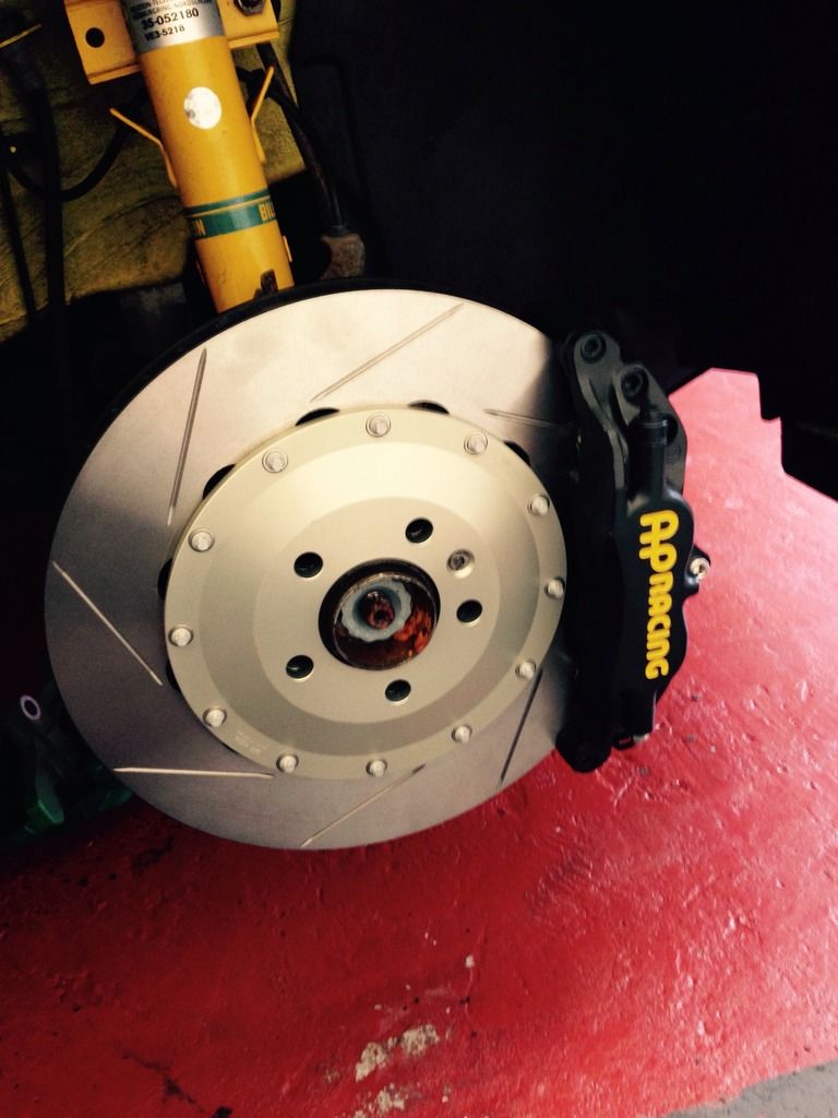

Braking wise the 312mm conversion was the most obvious upgrade so I sourced a set of low mileage Octavia mk1 VRS front calipers, got a new pair of genuine VW 312 front discs and a set of OMP road and sport pads which I have used for many years with good results.
The rears were treated to a new pair of Genuine skoda green rear calipers, new VW 232mm rear discs and gen skoda pads.

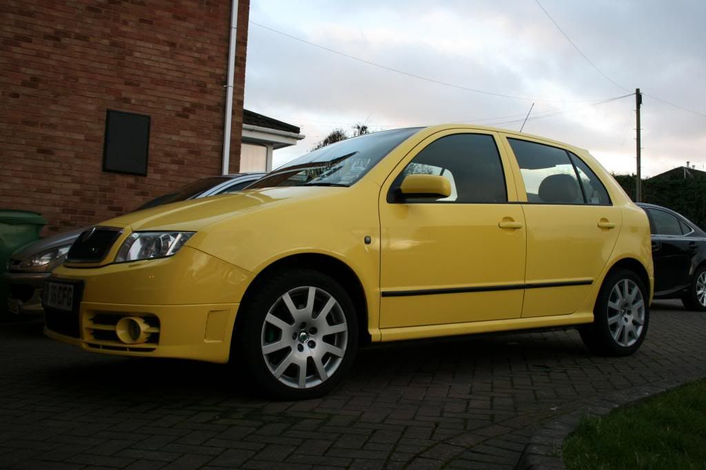

While the car was living its life on 4 axle stands the wheels were taken to City Powder coaters in Birmingham for a full refurb in Light Gunmetal, and a set of new 205/45/16 Hankook V12 Evo2 tyres fitted.
I had also bought new genuine alloy centre caps and a complete set of wheel nut covers in black from TPS.
End result after a few weekends of skinned knuckles and swearing..

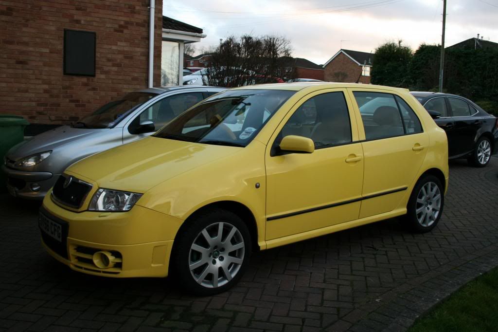

The car drove ace, handling was tremendously improved, ride quality was spot on and it wasn't too low and chavvy!!

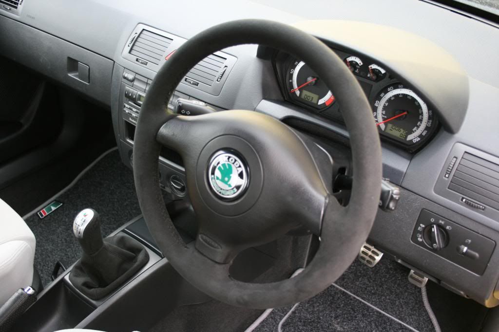

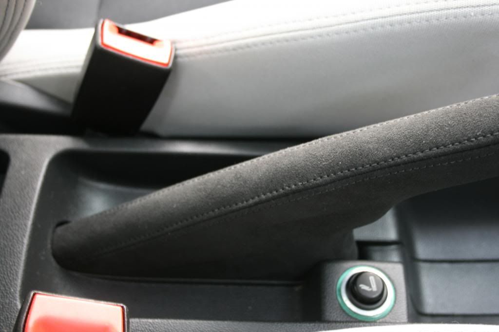

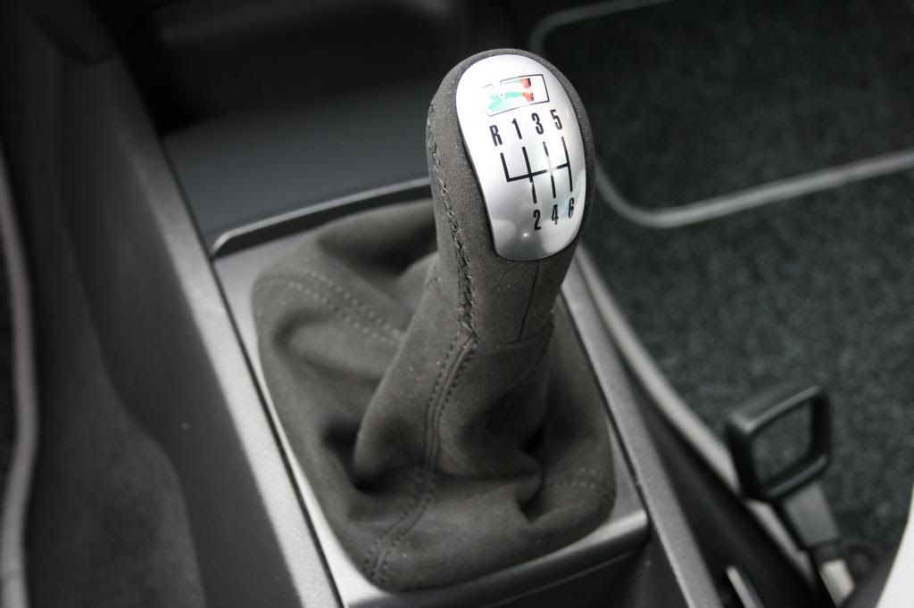

To liven up the interior and to add some quality to the touch points, I decided to enlist the help of Jack at Royal Steering Wheels down in Aylesbury to retrim the following in Black Alcantara with Black Stitching.
Steering Wheel
Handbrake Lever
Gear Knob
Gear lever gaitor.
Awesome feel, fit and finish. The plastic gear lever insert was replaced with new and the whole car feels much nicer than the dated perforated leather that I hated.

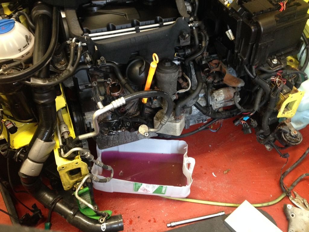

Before I even attempted any "tuning" the basics have to be right so, I bought an EGR cooler delete pipe from Darkside, and removed the EGR cooler completely, I also stripped of the inlet manifold, acid soaked it in the parts acid bath at work and painted and zinc plated the component parts before refitting with new gaskets etc. The EGR was actually spotless inside, testament to the service history I imagine
The car was then remapped by P-Torque in Wombourne, made a healthy 183bhp on the rollers, was 151bhp out of the box (BLT + Miltek), and drove ace, was so pleased with it!

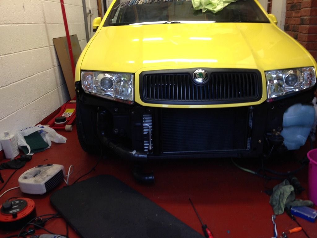

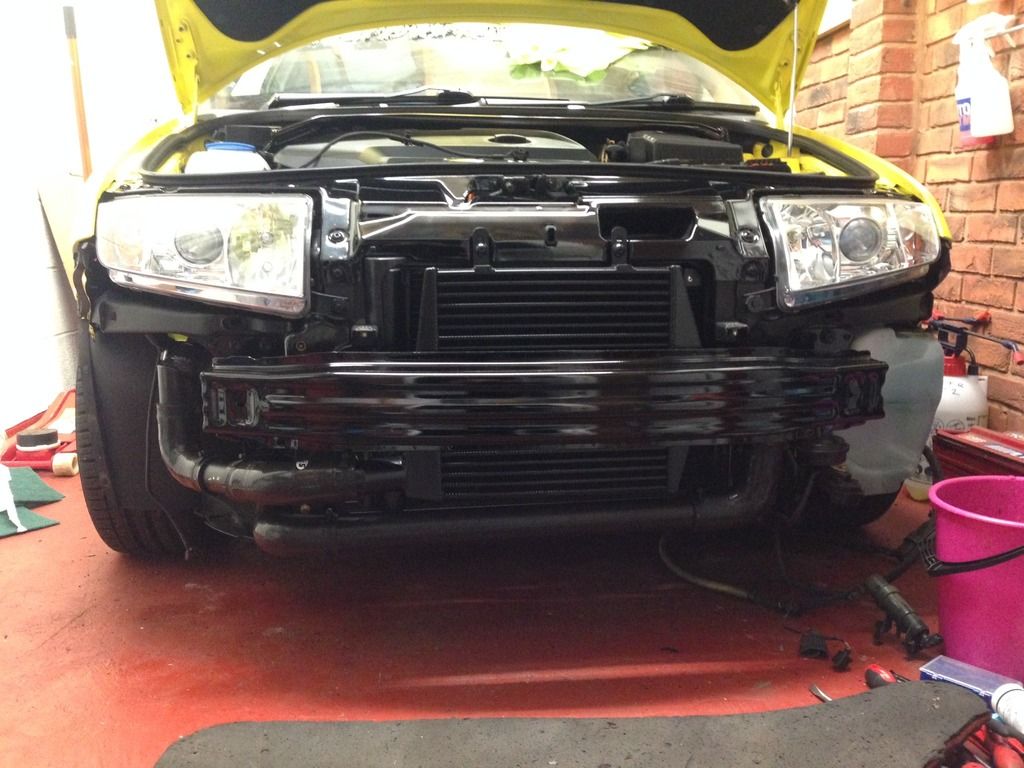

I did a trackday at Donington Park and hit the wall (not literally) of heat soak on the standard side mount intercooler. Would do nor more than 10 mins before dropping into limp mode due to intake temperatures, so next job was a Forge front mount..
No pics of this but I had it all painted satin black with black hard pipes and black silicon hoses, even bought black hose clamps - stealth FTW

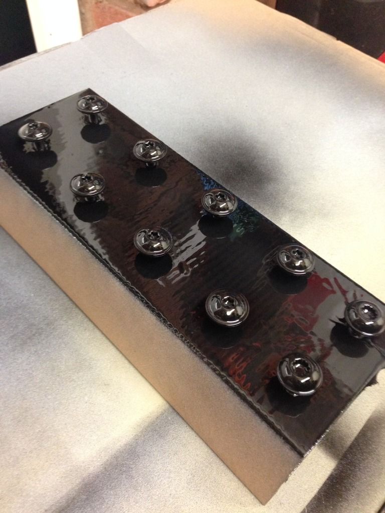

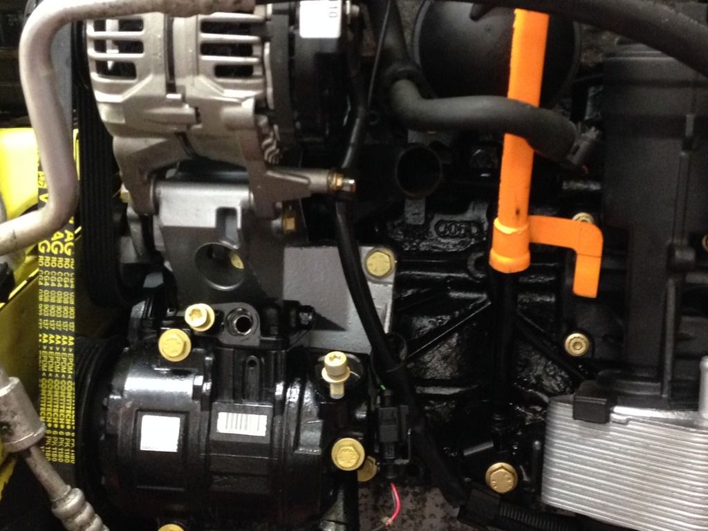

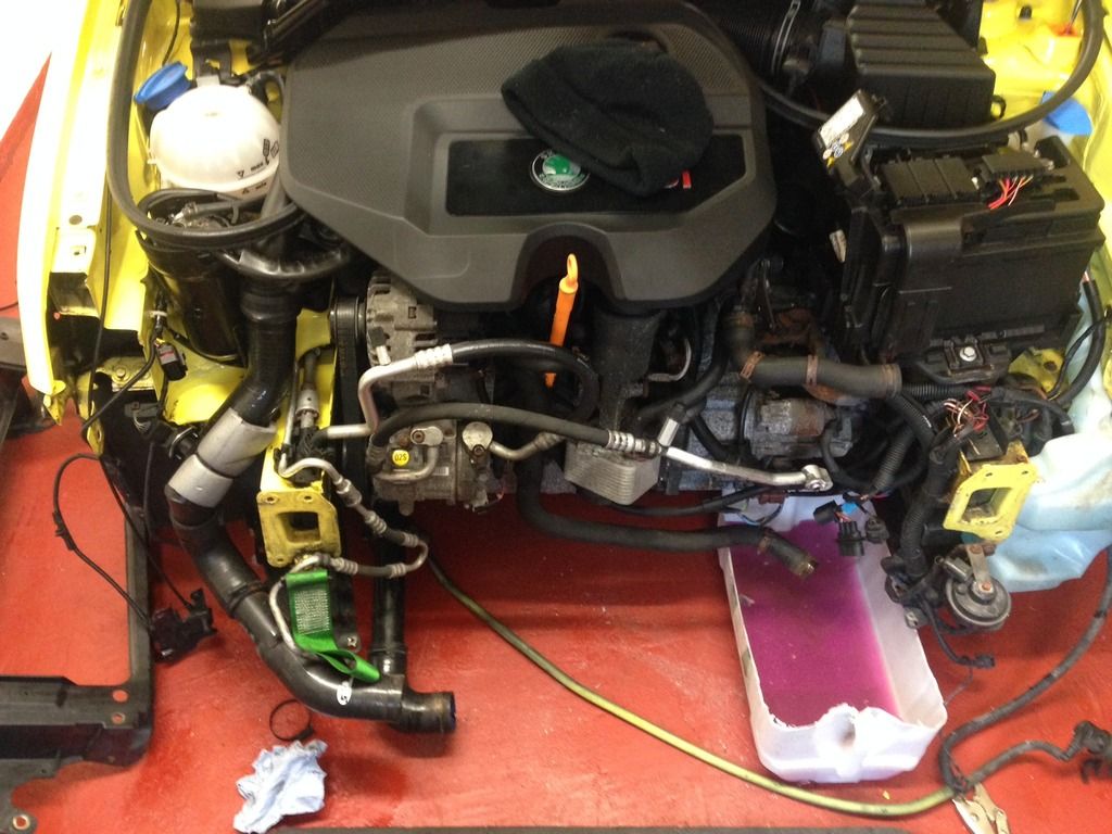

Not much else to report, this winters project was an engine bay refresh, stripped it all out apart from the major mechanicals, powder coated loads, painted loads, zinc plated loads, new radiator and new air con rad went in for good measure..

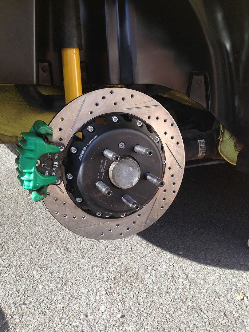

Excellent build thread. The rear brake upgrade looks great
Seen photos of this before and looked tidy! Great thread :thumbup:
Love it! My favourite mk1 on the forum! How much was the ap brake kit if you dont mind me asking? Was it an off the shelf job including the brackets?
Muchos jealous of rear brakes!
It's the unwritten rule amongst my mates etc, everything is £25 if the women ask LOL
It was £1400, the same kit essentially as for a Mk4 Golf 1.8T or Audi A3 1.8T, nothing is listed officially for the Skoda Fabia so we improvised

Phenomenal! Loving the stealthy FMIC install especially.
Cheers folks. I'm much happier with the subtle things that it takes fellow geeks a while to spot, hence not having a cavernous hole in the front bumper filled with chicken wire...
