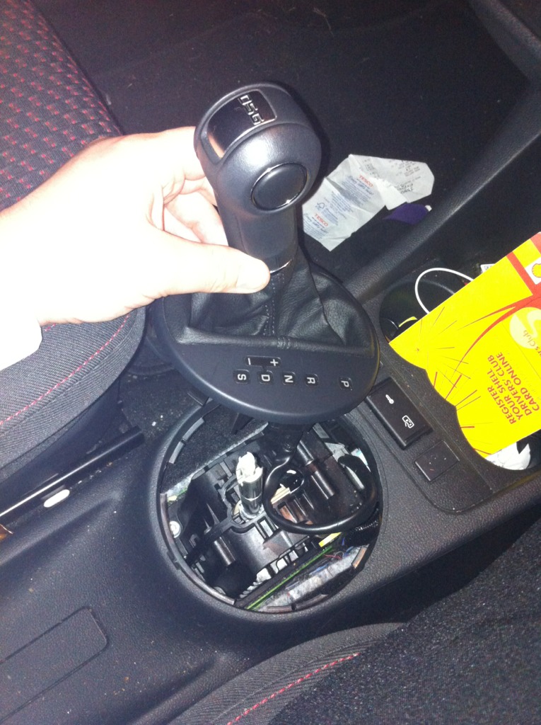

Hi all had a bit of an acident wile hitting a very deep patch of water on a corner -.- lovely how no one warns you now day
Anyway i somehow managed to rip off my gear stick and now the button on the side is stuck in and detatched from the actualy gear stick below it.... Does anyone know how to fix this? As cheaply as possible
This is what it now looks like
Surely that should be an easy replacement, however you'll might need the whole new unit " the bits that loose" as it wouldn't be repairable, on the other had that gearlever must be made of marzipan

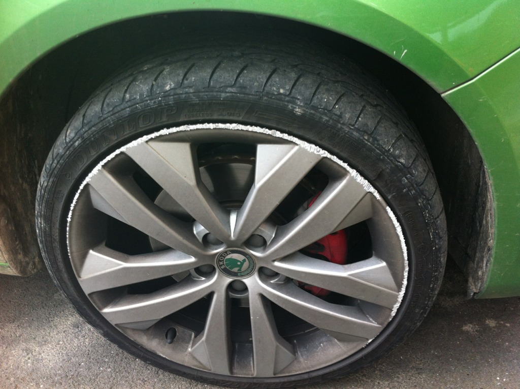

A picture of the aftermath that i just found :( heartbroken
Ouch!
Wondering if its worth refurbing as their booked in for powder coating next week :(

Ouch! Didn't think the gear selector lever on the Fabia vRS was that fragile!
How did you kurb ur wheel going through standing water?
Sharp water?
No point getting it refurbed, might as well buy a new one in my opinion. I looked at getting a couple of mine done, and they said because they're diamond cut, they can't get them back to how they were originally. They wanted around £100 a wheel I think, and you can get a new one for £136 from skoda.

That's the drivers side alloy?
Assuming the standing water was on the inside of the corner (where is normally collects?) have you aqua planed onto the opposite side of the road and into the kerb? Or did you spin out?
Either way a wonky knob and scuffed alloy means you are a lucky lad!
That doesn't look like a diamond cut wheel. Some of the other finishes available for the vrs alloy are diamond cut though.
You should be able to get it refurbed for less than the cost of a new replacement, but you might want to look at how much you could sell it on for as is & consider offsetting the proceeds against the cost of a new one to see which option works out cheaper.
For those with diamond cut wheels, they can still be refurbed but it will cost more to do than a std alloy wheel.
Fwiw Lepsons.com are highly regarded for refurbing m3 diamond cut wheels to a high standard so should be capable of doing a good job on vrs diamond cut wheels too. See there website for prices
The spokes are not touched, so what has that to do with anything?

All who are wondering about me ripping the gear stick off, basicly im used to manual cars and always have my hand on the gearstick it just feels natural to me, when i aquaplained i just locked up next thing i know im holding the gearstick at shoulder height.... All is fixed quite a simple solution realy, split the gearstick in half at the seams and remove... Then depress the button and slide back onto its mounting and it will relocate into the lift pin :)
I was looking at getting it refirbed and buying black vrs alloys for summer and keeping them for winter ones? Bit expensive but il see what people say when i take it to the spechialists thank you all for your help :)
Ps the water actualy covered the kirb stones so i assume it was the outside kirb i connected with (yes it is drivers side) went back earlyer on and its 8inces deep on the corner with no signs of flooding untill you are actualy in the water :(

I snapped the pin that was inside the button to hold it down, thankfuly i had a similar thing in my toolbox, the skoda bloke who came out was amazed he even took a picture because he couldnt belive it... Suppose 3 weatabix in the morning realy pays off :p
