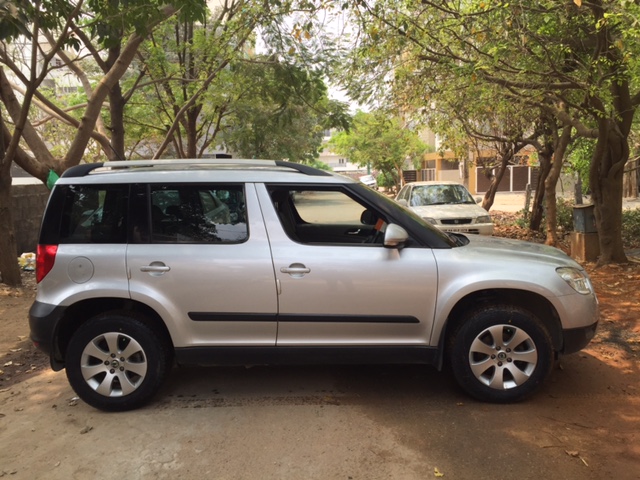

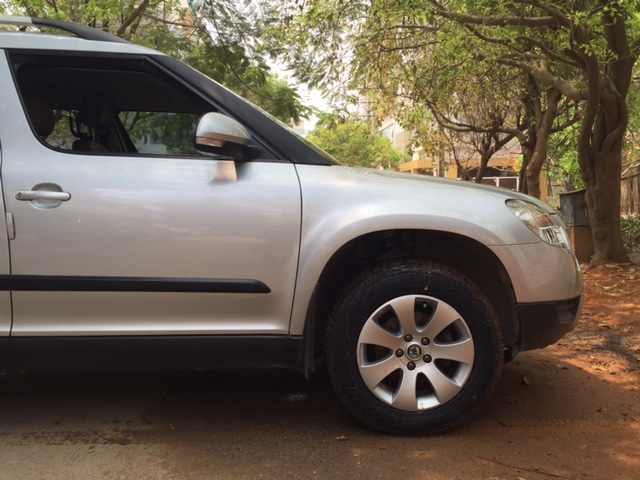

My Yeti 4x4 Elegance 2 Litre TDi 103KW (140BHP) Manual Transmission vehicle is 4.5 years old now. So far it is going strong.

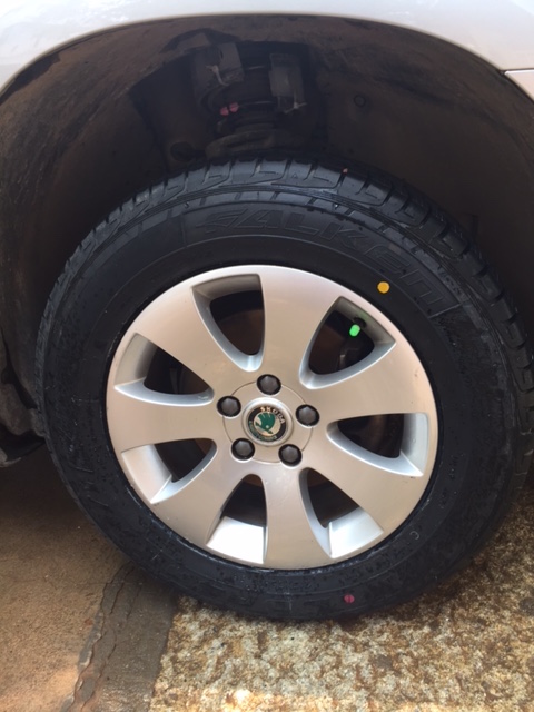

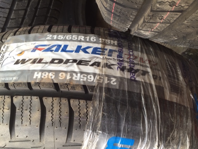

I ve changed the original battery around 9 months ago. I ve changed the OEM  Goodyear Excellence Tyres which were 215/60/16 size, to one size up - I ve got Falken Wildpeak HT01 Tyres on now and the size is 215/65/16. This results in a 5mm difference in sidewall height which help us, especially with our bad roads here.

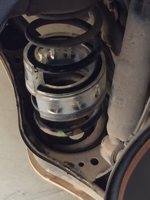

Additionally, I ve added in a set of 4 Rogerab suspension dampers, to help further with the ride quality so that the vehicle feels much more comfortable over pot holes and speed breaker bumps.

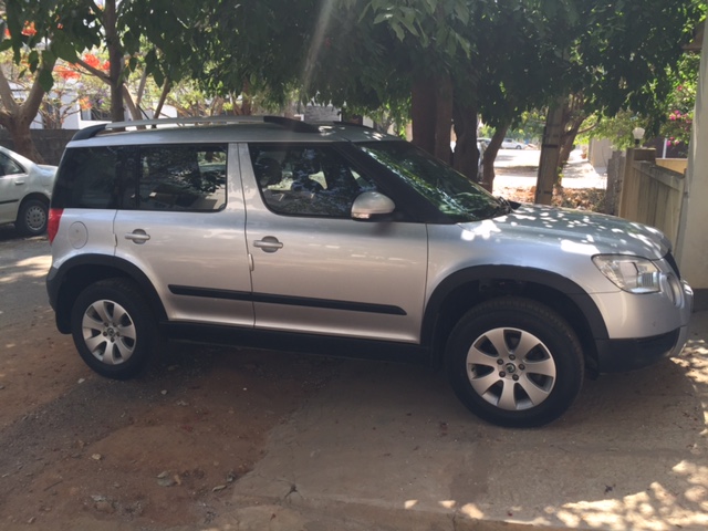

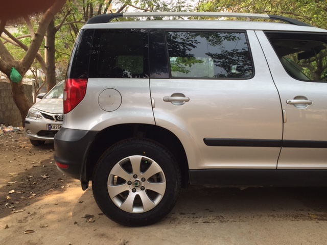

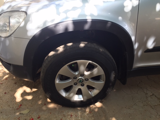

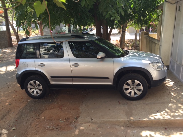

So what Ive now done additionally is have these Wheel Arch Extenders installed.
These are an OEM Skoda Product. Ordered with Vinayak Skoda here in Bangalore, India, who in turn ordered them from Skoda India HQ in Aurangabad, who then brought them in from Skoda Czechoslovakia and had them sent in to my dealer along with the special glue as well.
While I was travelling the whole of last week, the vehicle was picked up from home and these were fitted nicely on the arches.
The total cost, including the product, the fitment, pick and drop service etc came to the equivalent of 18500 Rupees which is about 185 Pounds. Not bad at all, considering!
They do look good, seem nice and solid and I do sincerely hope that they last and give me good service against minor dings and scratches etc!

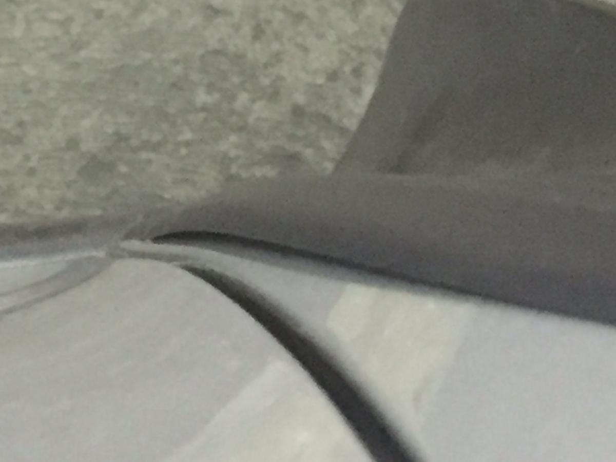

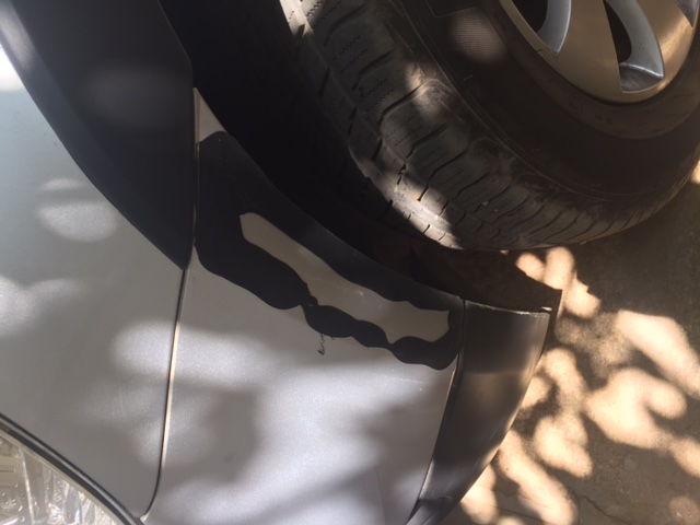

Ha Ha! So I counted my blighted chickens too soon. Today, almost exactly a week/ten days since these were fitted, while I was driving around town somewhere, one of the pieces has fallen off. I have no idea where.
So I have of course raised it with the dealership, with whom I have a good relationship and I am awaiting resolution.
Frankly the Glue that is supplied with these fender extenders isn't of that great quality - especially given the harsh, hot and dusty conditions of India.
Anyway, it is up to the dealership to figure out a solution - and happily I haven't yet paid for the part nor the installation either, so in some sense, I am safe until they create a solution for me, as one of their "valued customers"!
Like most glues it can be as much to do with the surface preparation and how the adhesive was applied, often too thickly. If the surface was not cleaned of all the polish etc. it was likely to happen. I think whatever solution your dealer comes up with should be applied to the other wheel arches.

Hi Yeti, agree about the powers of urethane adhesives and looking at the images of the failed bond it seems to have stuck to the car well. I would guess that they did not adequately clean and prepare the plastic trim. As many of these trims are injection mounded they can often have a coating of release agent on the surface or just the curing film.

Couple of comments about that picture:
1/ They didn't use enough adhesive.
2/ There should be a band of adhesive along the centre of the trim.
3/ It suggests they didn't prime the surface of the plastic.
4/ The instructions also suggest roughening the surface of the plastic, which obviously wasn't done.
Perhaps they need to read the instructions in full next time!

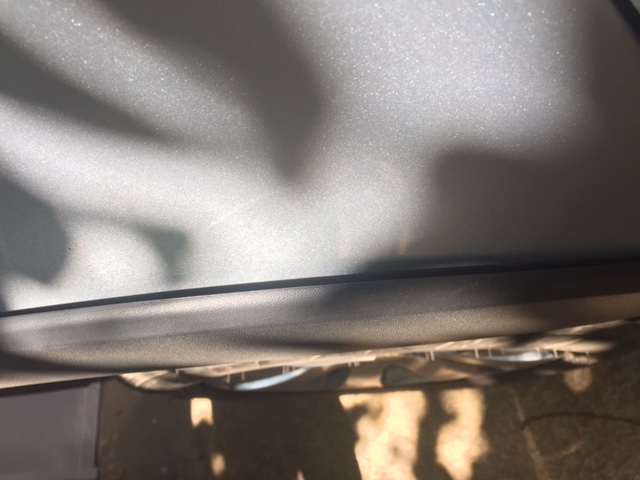

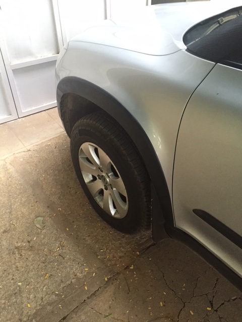

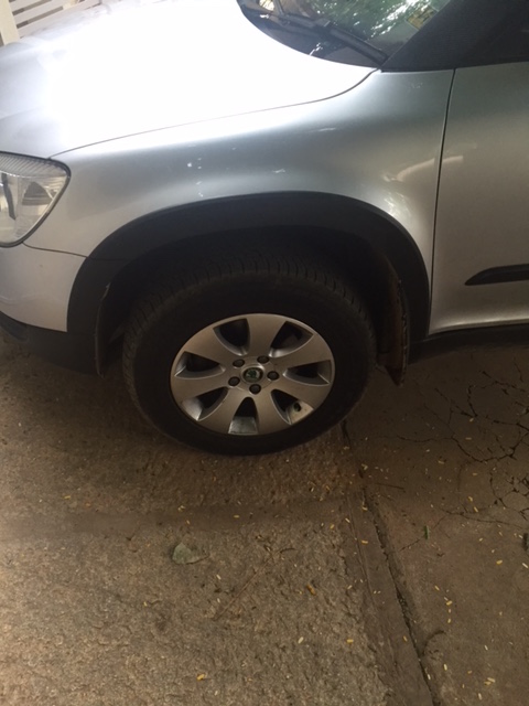

So after all that rigmarole I got the dealer to pick up my Yeti and re-procure these Fender Extenders and re-affix them.
I was travelling much of May and a part of June so all this got done while I was away.
When I got back, to my irritation I still found that there was a minor gap in the installation!
As you can imagine I was livid and blasted the living daylights out of my Dealer Workshop chaps.

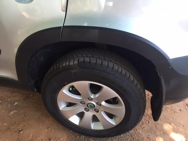

They apologised most profusely, came running, drove the Yeti away again and finally returned it after 2 days with the fender extenders re-fitted yet again.
Now, finally, it looks like a proper job done.
They know very well that if these fall off again, they are the ones that will be liable, because while Im always fair in giving them plenty of time and a long rope, I am equally demanding as their customer and they know that they can't get away with a laissez faire attitude, with me.
Anyway Im now hoping for long service from these fender extenders!

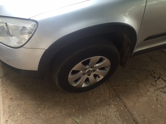

So here are the pics of the defective second fitment which was done between Mid-May and early June when I was away on work.
And the final re-fitment which happened only the day before yesterday.
