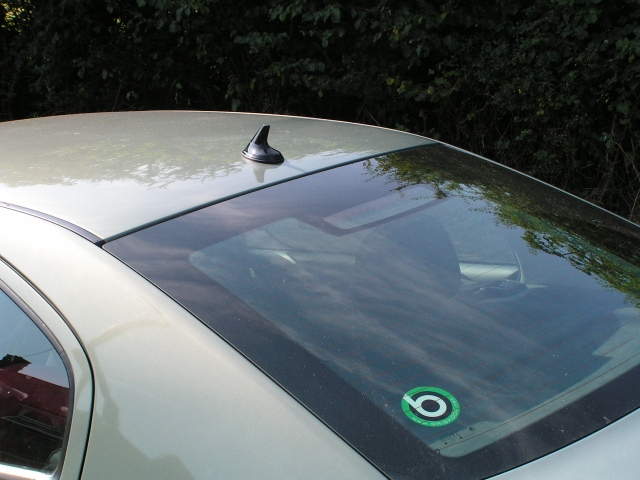

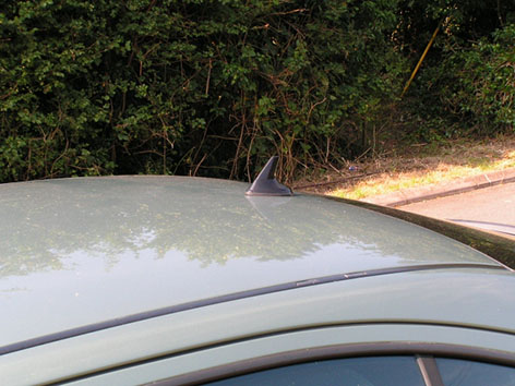

I bought a cheap sharkfin from ebay but when i installed it the radio reception was terrible.
After taking the OEM aerial apart i noticed what looked like an amplifier.
I decided to bite the bullet and wire the amp int the skarkfin.
as you can see, not a great deal to work with.
the amp once removed from the oem base had what looked like an obvious aerial connection and stereo connection. so i soldered cable to each point (green to aerial, grey to stereo)
(thanks to my boy for use of his toybox.
These cables were then wired inline with the existing cables (cut in the middle). a third wire has been soldered in to bridge the shielding gap.
Wrapped in black insulation tape and tucked up behind the headliner, no one is the wiser.
I need to use some sealant around the bottom of the fin due to slight gapping but i like the look it creates.

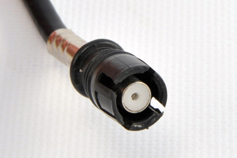

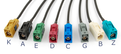

The connector on your existing aerial could be either a FAKRA connector or a RAKU / RAKU II connector.
FAKRA (female)
RAKU
