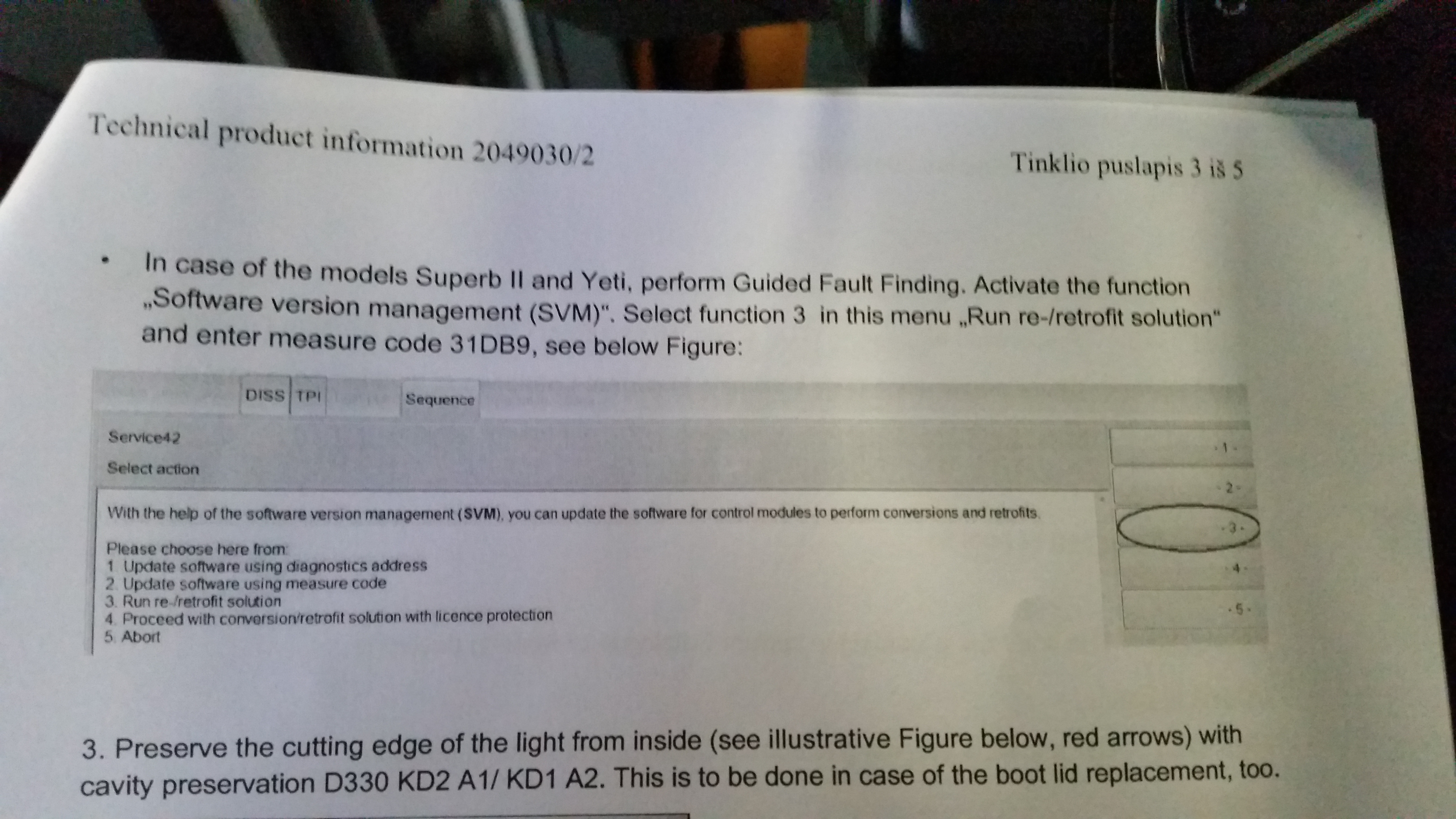

I did a reprograming a BCM and after what everything become ok.
After reprograming i did retrofit solution how to shown in the picture.
And now ewerything ok.
