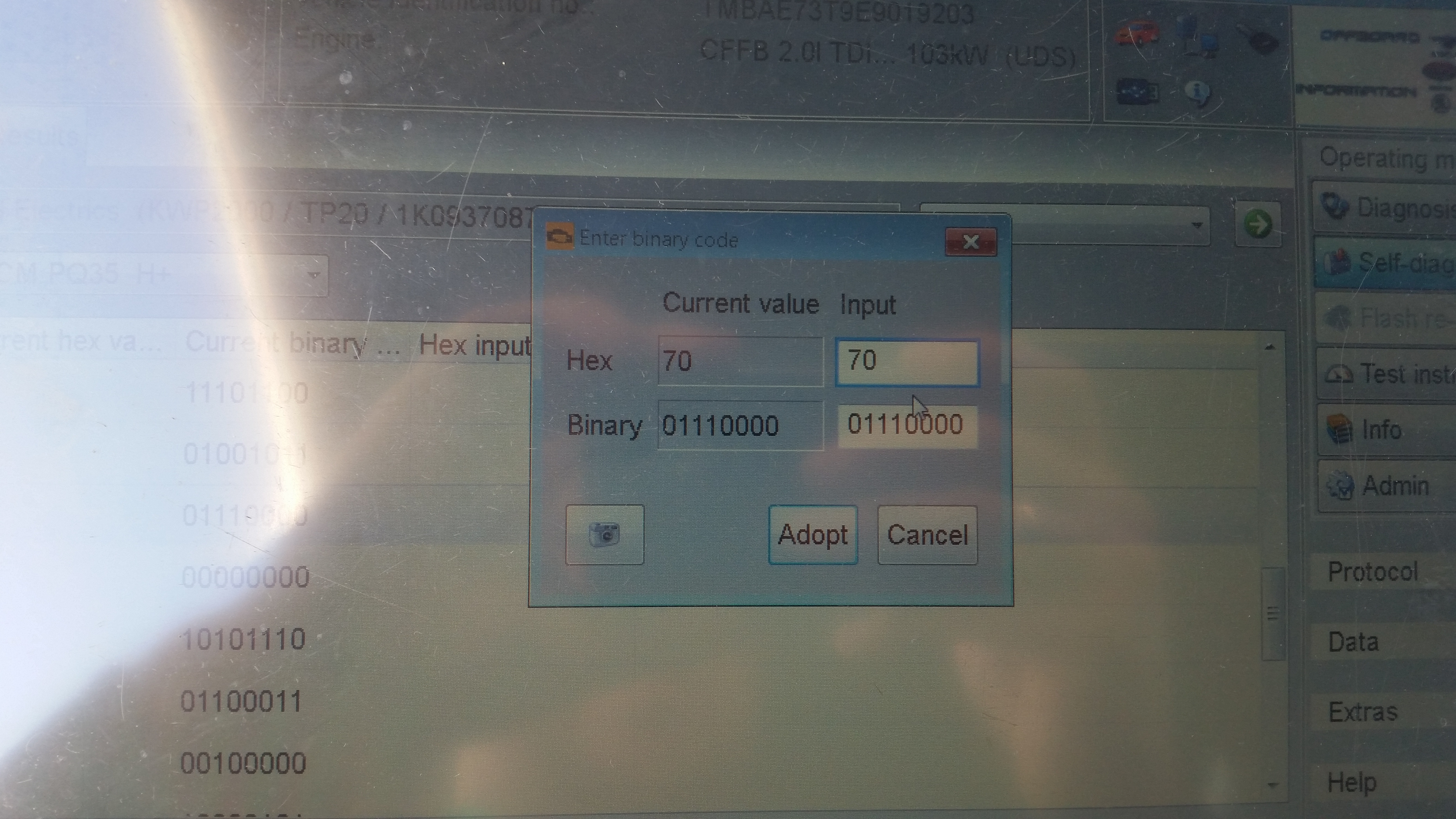

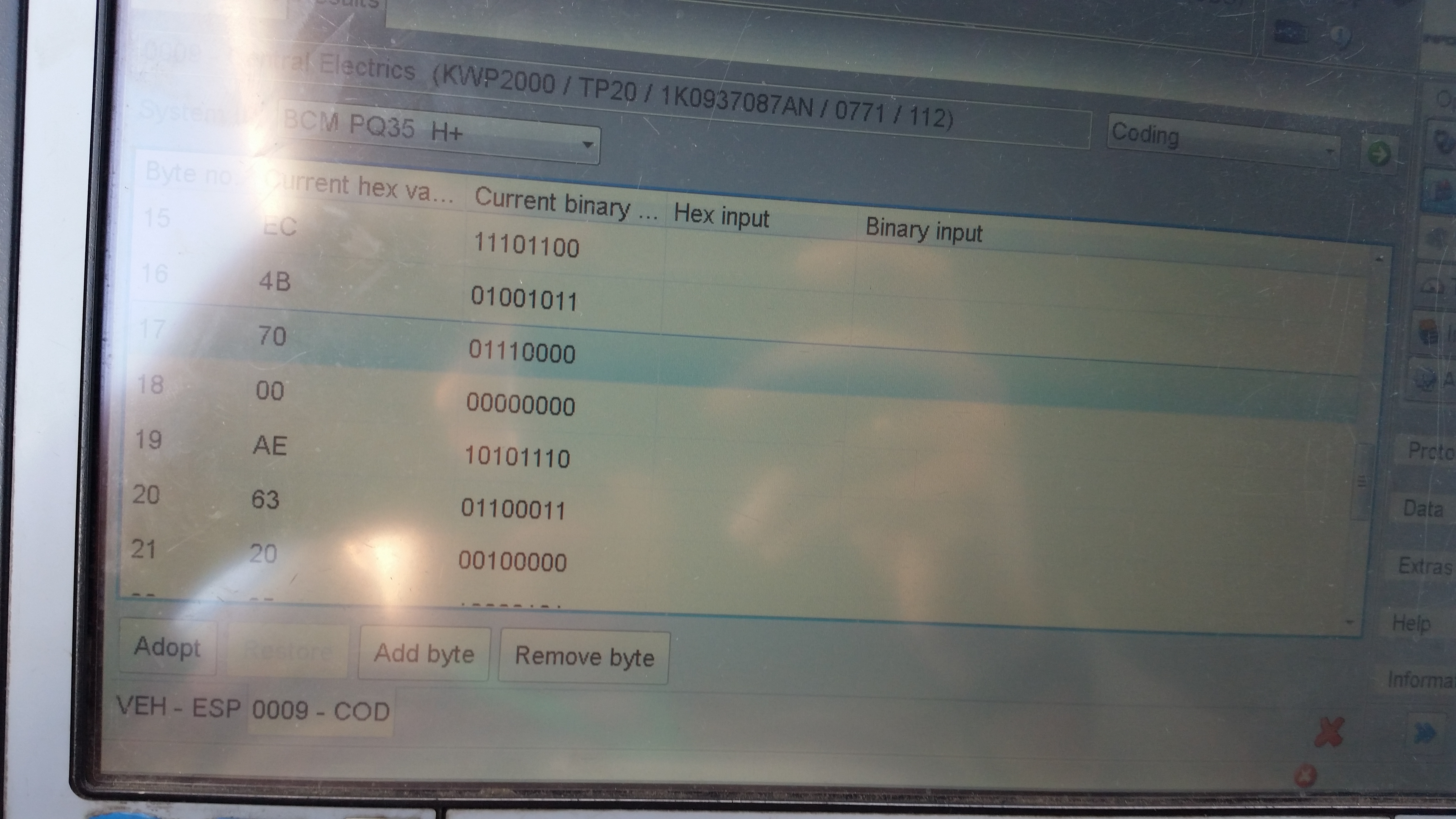

Initial value of byte 17 is 70. like a picture.  I tried to change to 07. But nothing changed.

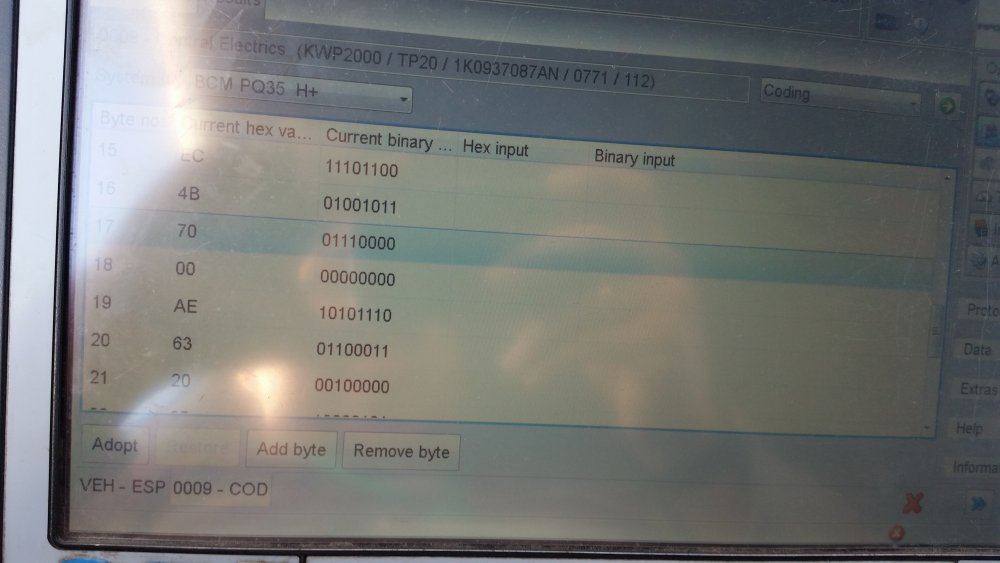

When i do a little mistake and add a new byte between 17 and 19. It is byte 18. Shown in picture 2.
Then i deleted this byte and then happened problems.
Firstly, you should learn about decimal, hexadecimal (hex) and binary numbers.
The original byte 17 in hex was 70, this translates to 01110000 in binary.
In binary, they are shown in highest to lowest (bit 7 to bit 0) so changing bit 7 will change 01110000 to 11110000.
Translating 11110000 back to hex gives F0 for byte 17.
You used hex 07 which is 00000111 in binary so you actually changed bits 0, 1, 2, 4, 5 and 6.
Secondly, when you added a byte I expect you change byte 18 from 00 to some other value (07?).
This is probably what's messed up your DRL and maybe some other lighting too. Byte 18 controls the lighting configuration of the car and if it's set to 00 it means it's not possible to restore the lighting configuration by changing byte 18 back to 00.
