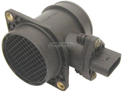

**EDIT** Yeah like some prize muppet I was looking in the right area but wrong part......see attached pics. I thought it plugged into that pipework as opposed to being part of it. Am I right? This is it circled in red? post-94874-0-88568200-1345707017_thumb.jpg And this is the replacement part? post-94874-0-01555200-1345707026_thumb.jpg

Part being delivered tomorrow, to be fitted myself Friday night....MOT disaster averted! All for the princely sum of £72 delivered! Winner winner chicken dinner!
Thats the one, the bit with the wire should have two screws which hold the sensor in the housing (tube bit)
Where have you ordered from as the non genuine ones arn't brilliant, better off with a real bosch one than a copy.
