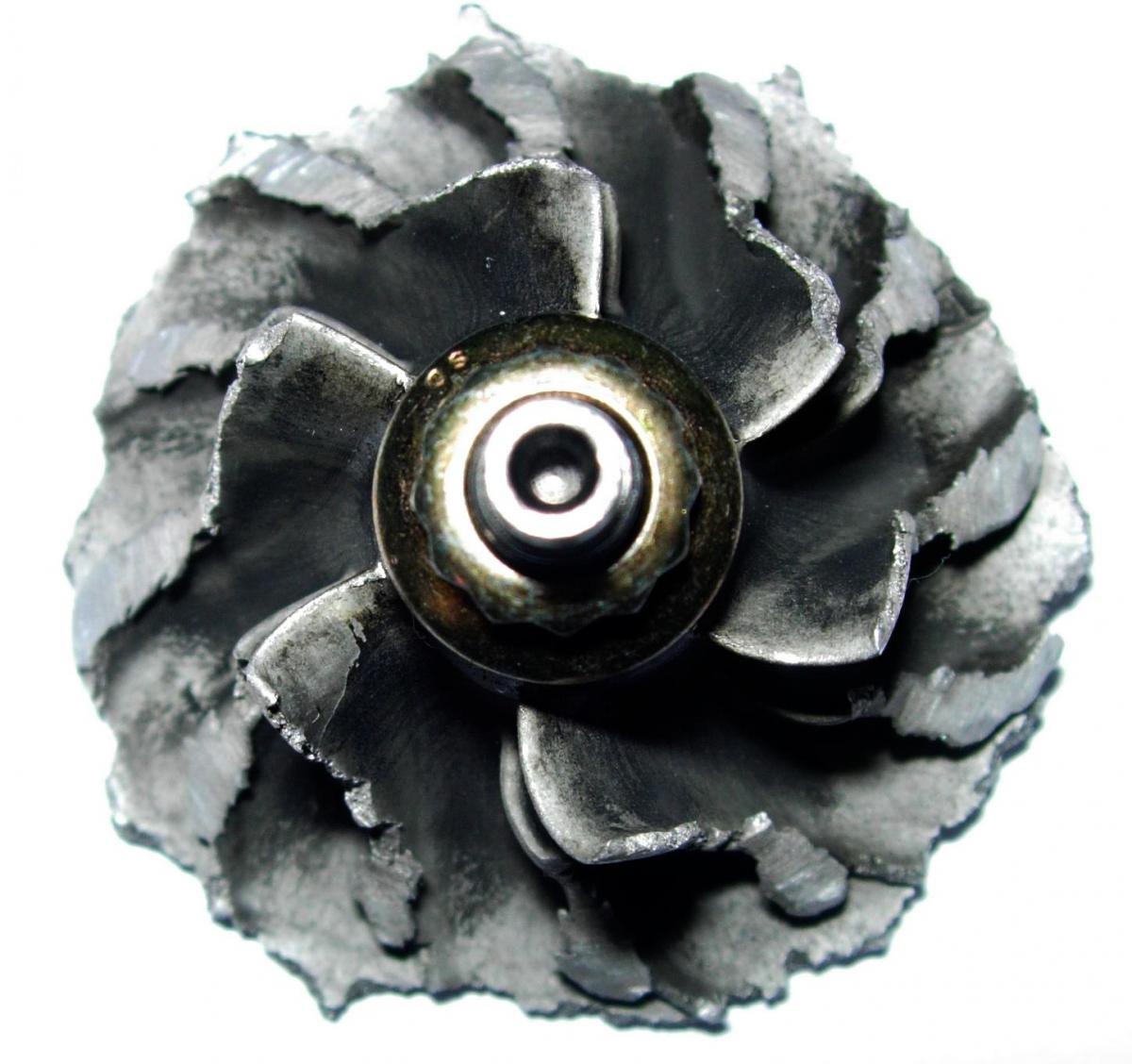

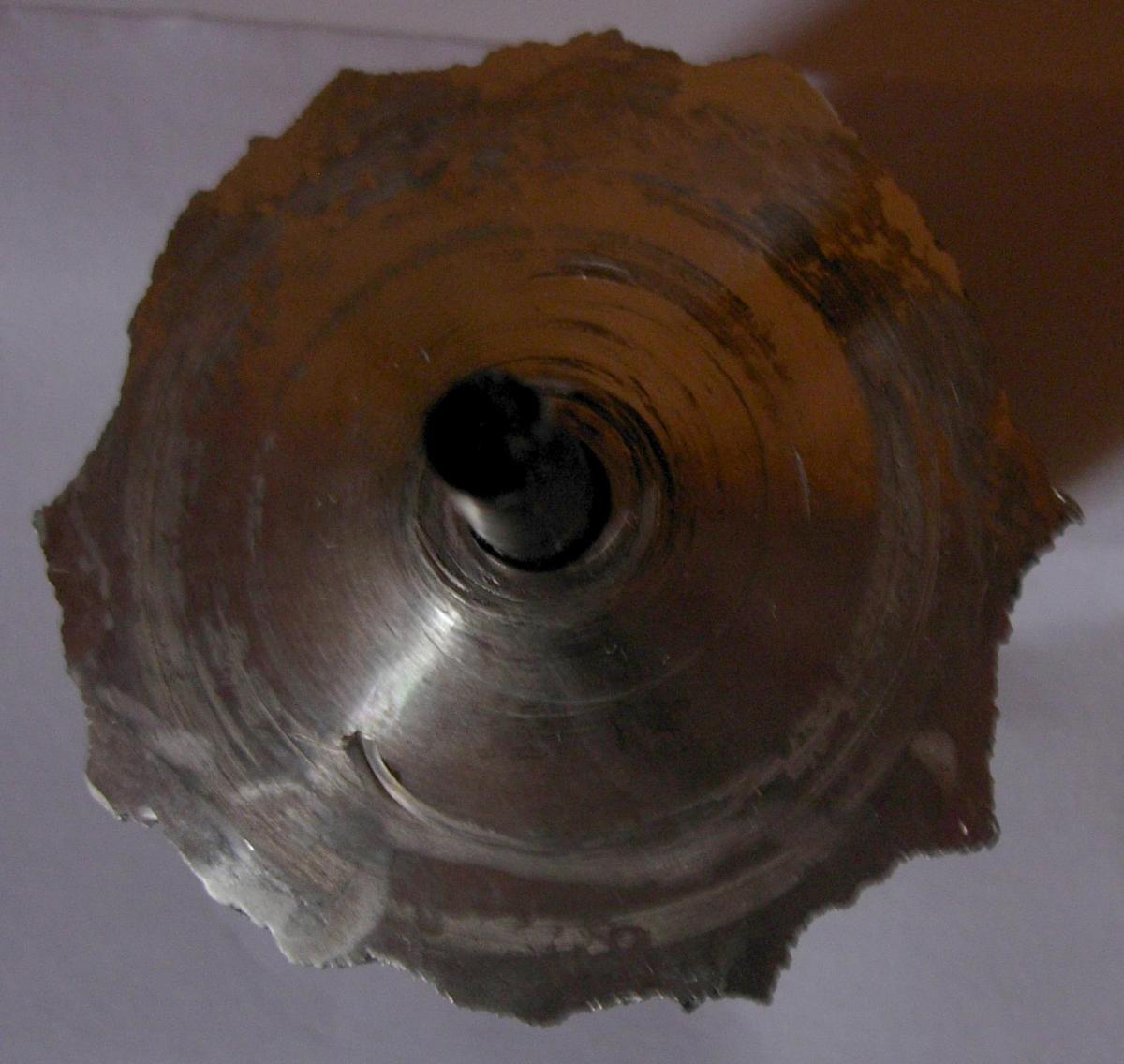

Just to update on the engine. A new one has been found, beit a little older and has been fitted, fairly smoothly. Im no expert but the turbo looks fine to me, maybe we need to take it off and take it aparts but here are some pics.
Im a bit confused - is this a picture of the new motor?
Just looking at the nice big hole in the crankcase... :sweat:

The photos show the compressor part of the turbo, the shaft broke and it ran on its own oil. We had the car up and running earlier this week with a used turbo and all seems well, despite the initial copious amounts of smoke from the oil left in the exhaust.
This is the one we took out. The new engine has already been fitted.
