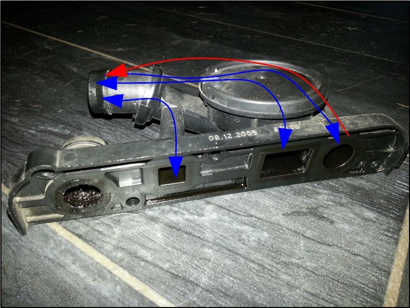

I checked the PCV valve and frankly I don't know how it is supposed to work, but I have attached a picture. The blue arrows are where I easily can blow air through and the red one, is where the valve blocks air passage.
With regards to the fault codes, there are none, but I guess the DV can be faulty or loose (?) without any fault codes appearing?

Hi Guys
For some reason I didn't get notification on the topic :blush:

A faulty PCV wont bring up a fault code, does it rattle when you shake it? If so and you can see that the metal flap inside is dislodged then its had it. Anyway its off now you mite aswell replace it with the revision.
Edited by 07 vRS Taxi
Was actually thinking of replacing with a can system after I saw all that residue going into the engine... I have to take it of again to see if it rattles - I just mounted it again - but perhaps your are right.
