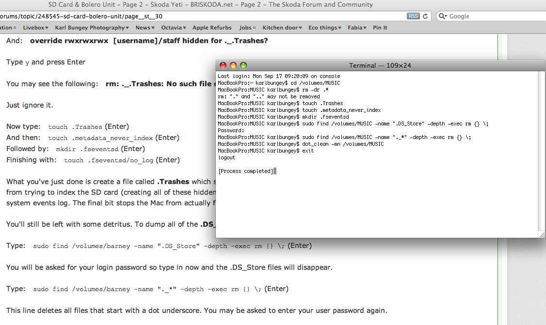

I've just run through this comprehensive set of instructions that darrenm2001 posted earlier and can now feedback that it kind of works...
While no new ._* files seem to be being created, it hasn't removed any of the existing ones.
At this point:
Type: rm -dr .* (Enter)
You may get the following message: rm: "." and ".." may not be removed
And: override rwxrwxrwx [username]/staff hidden for ._.Trashes?
Type y and press Enter
You may see the following: rm: ._.Trashes: No such file or directory
I got the first error message, but not the second or third and I didn't have to type 'y' and press enter. Reading the instructions, I don't think that this is an issue.
Where did I (or the instructions) go wrong with clearing out the existing ._* files?
At this point:

Thanks for the update and I appreciate your efforts, but I've tried it again and it still doesn't clean the ".*" files from the SD card!
I tried just the new commands initially, then went back to the beginning and followed your modified instructions adding the new "sudo" command after the one you initially suggested.
All the ".*" files are still there...
Any other ideas?
Any other ideas?

I'm really not sure what's going on here as I've followed my instructions to the letter and they work just fine.
Two questions:Is the SD card write protected? (Check the little sliding tab on the card.)
Are you typing the commands exactly including all of the upper and lower case and specifically all of the random looking backslashes and semi colons on the two 'sudo find' commands for removing the .DS_Store and ._* files/folders?
It's not write protected - worth asking though - and I can add or remove files from the card.
Yes, I am typing the commands exactly as you put them (including the ' \;' at the end - but not the (enter) bit). And I've tried about 8 or 9 times so far. (See attached screen shot).
I can't have typed it wrong every time!

I'll give that a try but am confused as to why I can't get your main instructions to work...
I had to ask about the write protection just in case - it's the IT support guy in me trying to look for the simple and complex solutions! :happy:
Many thanks for the screenshot - I can clearly see you are typing it exactly as I've shown (with the obvious change to the SD card name).
It's a shame you live in Herefordshire and not Hertfordshire as we could have met up as this is really beginning to bug me! I'm going to try my instructions on a different Mac tonight (and a different SD card) just to make sure it's not a fluke.
