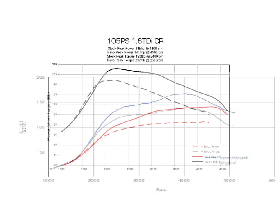

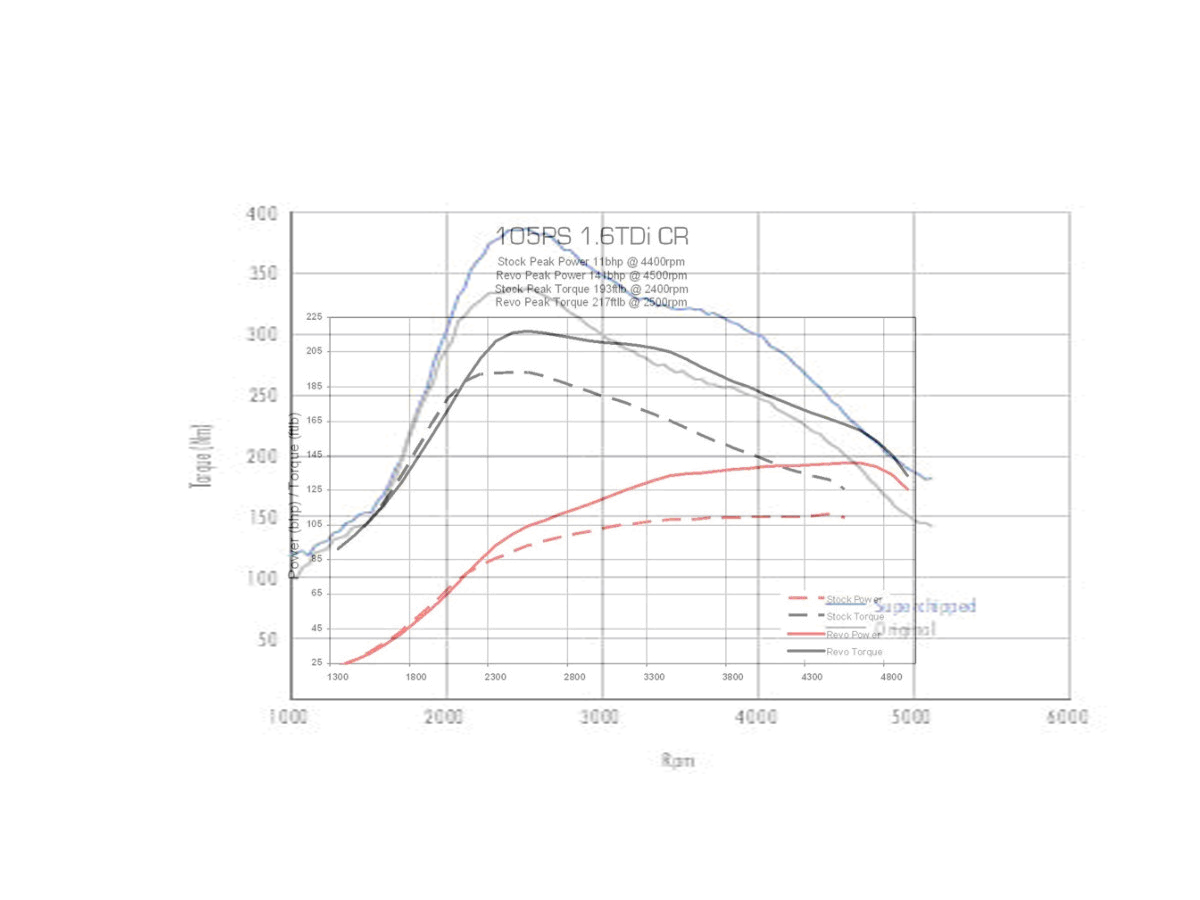

For interest, I have overlaid the Superchips before and after power and torque curves onto the before and after curves for the Revo 1.6 CR Tdi map.
Key:
solid red - Revo uprated power 1.6 CR TDi
dashed red - Stock power 1.6 CR TDi
solid black - Revo uprated Torque 1.6 CR TDi
dashed black - Stock torque 1.6 CR TDi
Solid Blue - Superchips remapped PD130
Solid grey - Stock PD130
The remapped 1.6 CR engine is getting quite close to the fiqures for the old PD130 engine. As you can see, the Revo remap torque figure is still slighlty down 217lbft (294Nm) compared to 337Nm or -14.6%. However, as expected for the CR engine max torque persists over a wider range than the PD engine.
If this is a reliable map it could make the Monte Carlo a proper succesor to the Mk1 VRS.
