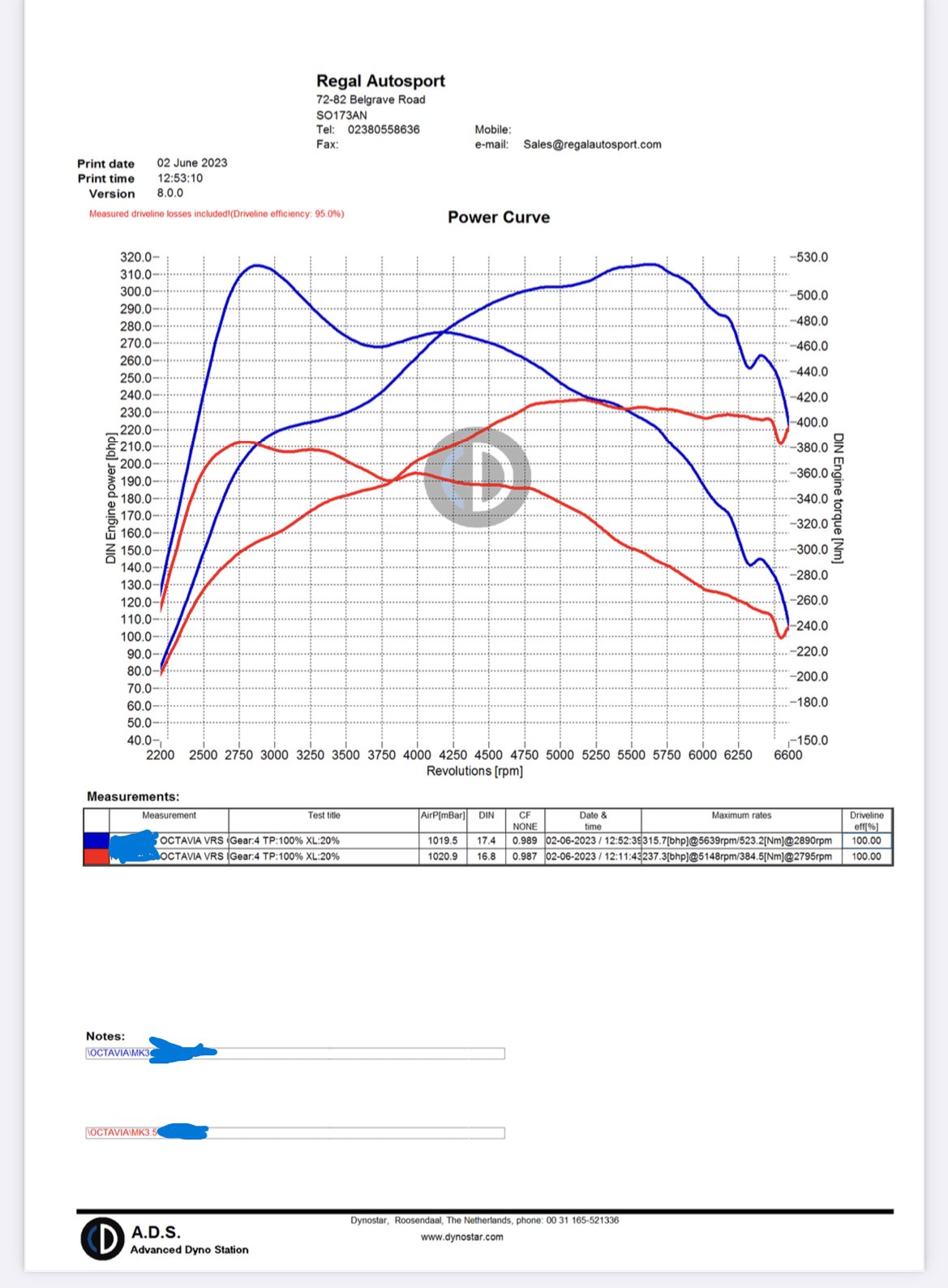

Just had mine flashed with Racingline
There is something very very very wrong with that graph, am I the only one to see it?
Maybe I am misinterpreting it, is it supposed to be the before and after power & torque curves from the same vehicle?
Edited by J.R.
red before, blue after, same vehicle. Stock in red, Racingline in blue.
Make sense?
No, I'm even more confused now, I wrote in more detail in the other thread.
The graph is a little confusing because both the power and torque are in the same color, so with two lines in each color and two different sets of values on the Y-axis - one to the left and one to the right - it becomes hard to read.
If it makes it a bit easier to understand, the line that peaks early on is the torque curve, the one that peaks much later on, is the power curve.
Nevertheless, congratulations @RoddersUK! Was it a hub or roller dyno? If it was the latter, did you experience any wheel spin? The curve has a few more dips throughout the rev range than I would've expected.
Edited by TagEldinAhmed
I've not really booted it that much, lots of traffic around, but off the line I put my foot down in second and the TC kicked in.
Was a roller dyno
Edited by RoddersUK
Was a roller dyno
Yeah, I just meant on the dyno to explain those minor dips throughout the graph. These cars really struggle to put the power down from a standstill when you're on the road. Hope you enjoying it!
Ahhhhh, classic miss read!
I wasn't there when they did it, as left it for tune and MOT
Edited by RoddersUK

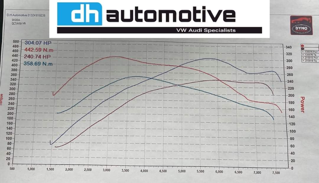

I had mine remapped with racingline OEM+ this week...very different torque profile.
Yours follows the racinglines example nicely, not sure why I have that huge torque peak, unless they swapped my engine for a diesel lol.
440NM is around what they say you should see.
