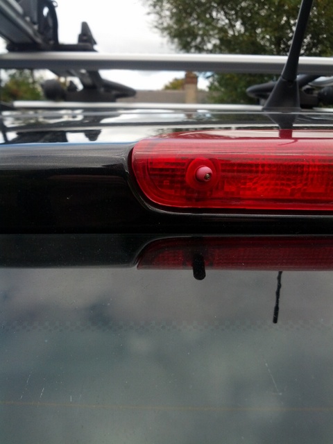

How is the high level brakelight screwed in, is it from the bottom? as mine seems loose at the jet end, do i need to remove the boot plastic lining to get to it?

The high level brake light is indeed secured from underneath. You need to get the top bit of the internal tailgate trim off to access it.
However keep your epoxy handy.....my high level light came loose at the jet end a few months ago. While examining it to try to see how it was attached the whole red lens assembly came away in my hand. Really a new light unit was required, but at about £35 for a replacement I thought i'd have a go at sticking it back on.
I got my epoxy out and put a bead of the stuff all around the fitting (to try to make it water tight) and stuck the lens back on. That was 3 months ago, and it's still stuck on there and the light still works with no sign of water ingress!
In my experience of using epoxy, if it lasts a week then it tends to last years......time will tell.....it may not survive the winter so well.
