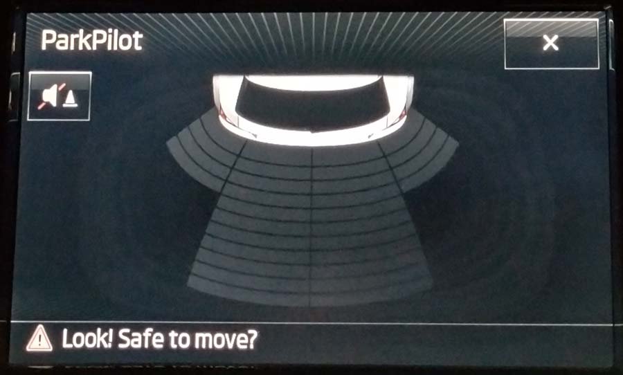

Thanks for your reply AG! That's great, when you're reversing, do you get info from the side angles, as well as the back? On my reverse sensors, only the 2 back ones are showing on screen, not the 2 smaller side angles. Is this normal?
Looks like this with nothing behind me.
Thanks.  AG Falco
Thanks.  AG Falco
Thanks AGFalco! I thought the side sensors activated sooner. It looks to be working OK!
