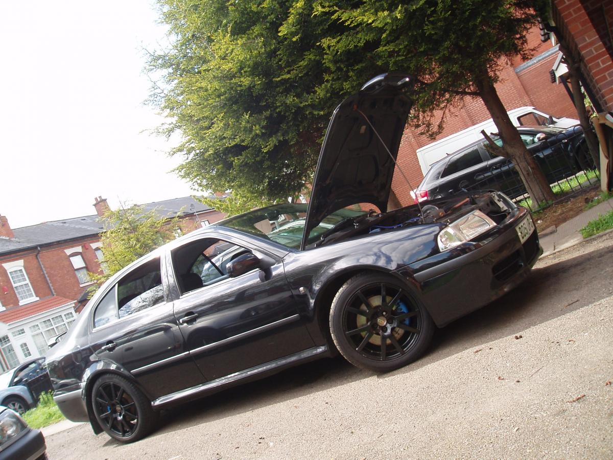

my car
my car
Has it been stolen? :giggle:
lol i cudnt get it to upload
Are you sure they are forged? Didnt think they were.
