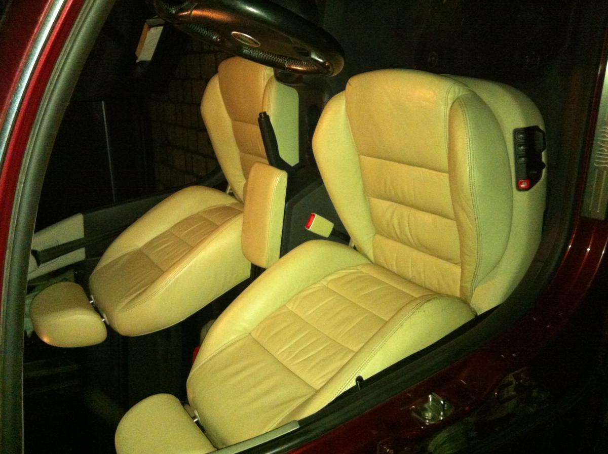

hi!just a bit of an update on the car!i have cut the gear stick by 4.4 cm,so is nice and short now,with a really nice momo gear knob!Started to do the carbon fiber inside,and have wired the seats in,so they going in this sunday :-) cant wait!Also i have a set of speakers coming,and i have the sub etc alos in the car!i will put some pictures up next week with the new interior!Thanks

Hi Guys,and sorry i have been off for a while!I have done a few things to my car,but since we have attended on the ultimate dubs this weekend,i have some more to do!So i will update now more often!:-) the seats are superb seats from an other one,i had to wire the electric and the heating in!I have bought the screens for the head rest,and the biggest think is going to be the wrap of the whole car!So please keep checking,i will update you all the time!!

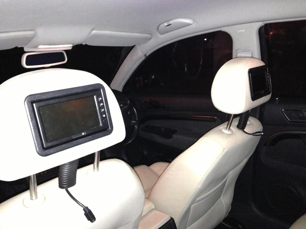

And my head rest screens are finally in :-) so happy with them!Next is the door panels and the speakers to replace!I am bidding on a 7" double din head unit as well,fingers crossed a few hrs and i will have it as well!

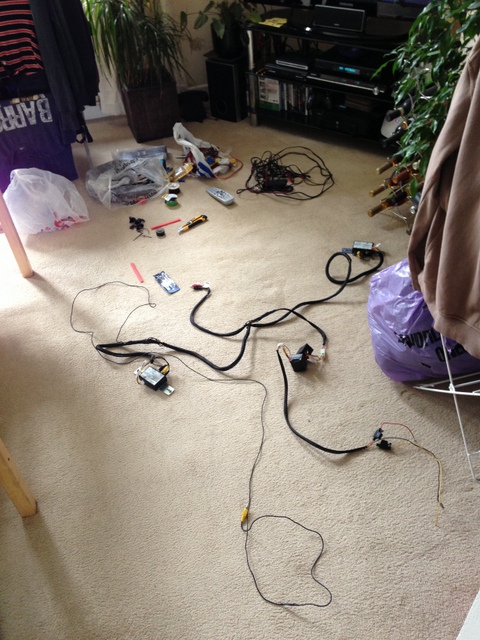

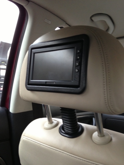

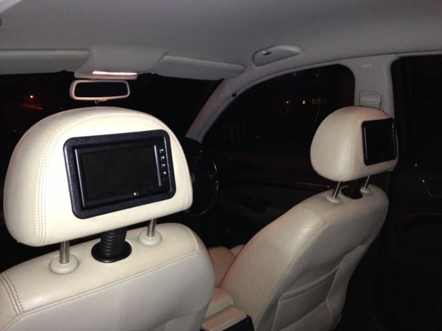

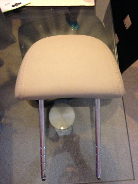

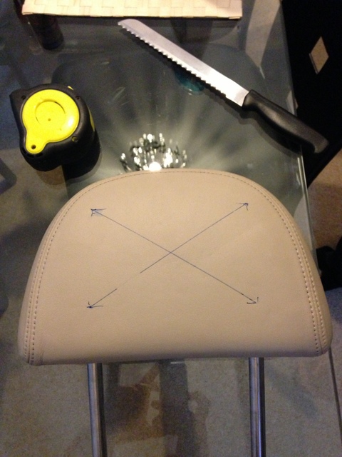

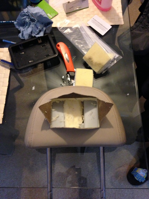

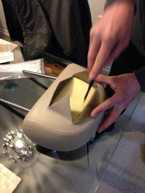

post-96153-0-42940800-1364898485_thumb.jpgpost-96153-0-90764200-1364898488_thumb.jpgpost-96153-0-48807400-1364898492_thumb.jpgpost-96153-0-64047000-1364898495_thumb.jpgpost-96153-0-65123100-1364898498_thumb.jpgpost-96153-0-72458900-1364898501_thumb.jpgpost-96153-0-67456500-1364898504_thumb.jpgpost-96153-0-93091200-1364898506_thumb.jpg

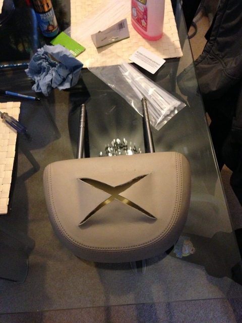

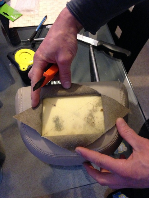

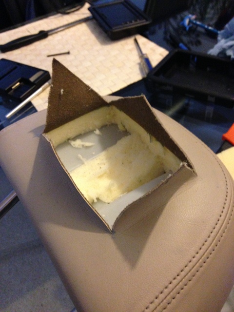

This is how i did my head rests,i was a bit scared to cut the leather,but after i have seen it on you tube many times,i thought what can go wrong :-) Well,i did work on it hard to achieve this look,but did worth on the end :rock:
I have put this all under the carpet :happy:

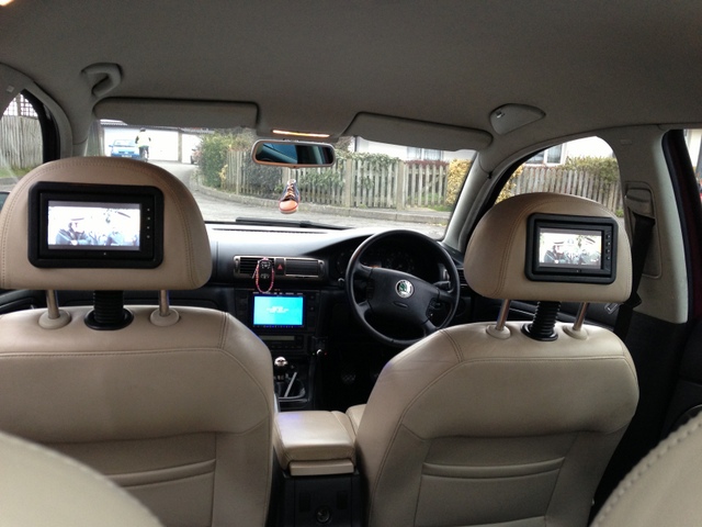

Is all up and running! :happy: Lets move on to the next project,the doors and the sound... :rock:post-96153-0-19635000-1365087816_thumb.jpg

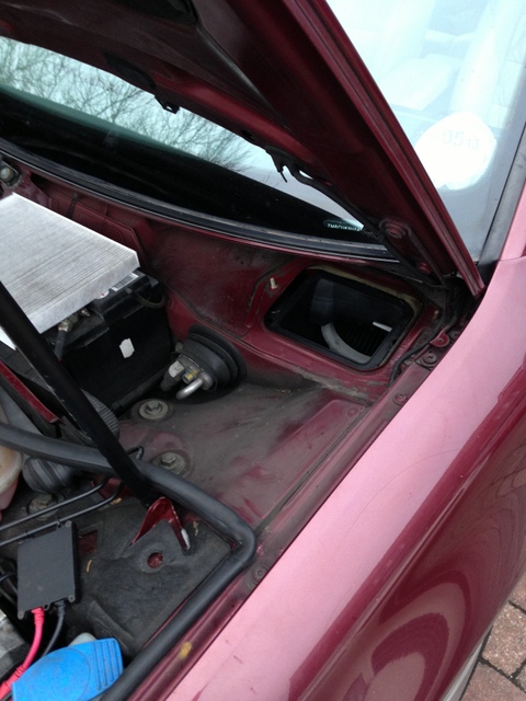

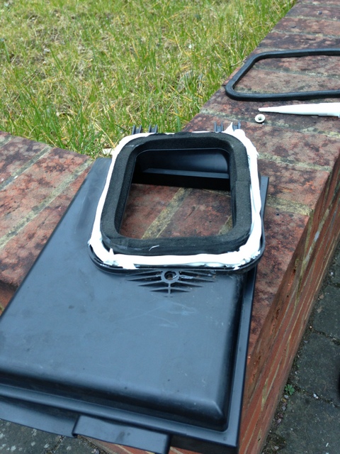

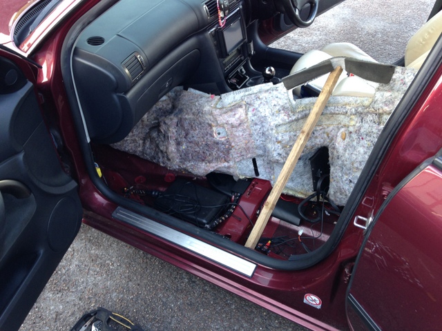

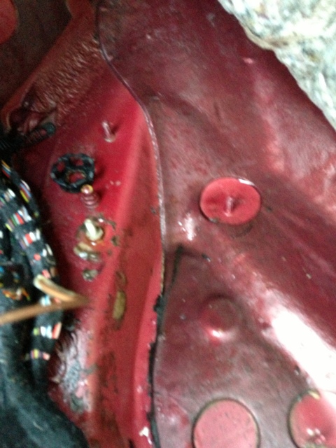

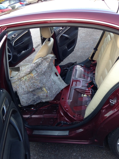

When i have fitted the screens,i have discovered i have some water problems under my carpet!I did not know how common this problem is,and thanks to this site,i have find out,what can be the reason,and it was!So yesterday i have removed the pollen filter,and re-sealed under the plastic stuff,cos the original seal was so bad,i could tell the water is running trough there!So here is a couple of pictures what i have done,and tomorrow i will try to dry the car out,and fix the cables to have all my door puddle lights etc back in work,cos i have them all converted in to led,and cant wait to fix them :-)
Hi,
Great job on the Superb so far.
I assume the white stuff is ordinary silicone sealant?

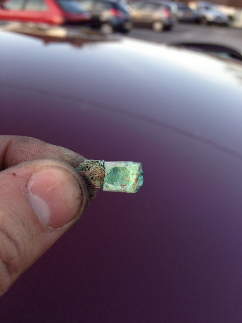

I have used no more nails,for external use!You will not have to remove it again from ther,if u need to get to the fan,is from the inside anyway!Today i have removed the front seat and the bottom of the rear seat to lift the carpet up!I started to dry the carpet and the floor as well,did not put seats back,cos i will carry on tomorrow:-) is not to wet,but it was wet enough to have a few wires corroded!Just before the rear seat you have about 10 red wires connected together!As i touched them,the end just came off,it was so corroded!So i have reconnected all of them,plus cleaned the earth wire positioned on the front,and voila,all my puddle lights are working,boot light and glow box light are working,and my mirror lights are working as well!So i have put the led-s in,once i have bought them a few weeks ago!Im so happy!Please find a few pictures attached again,to have some idea what im talking about :-)
