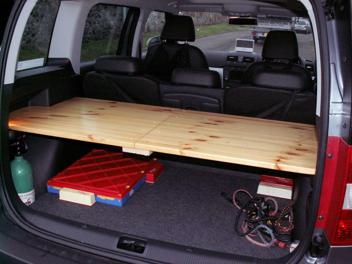

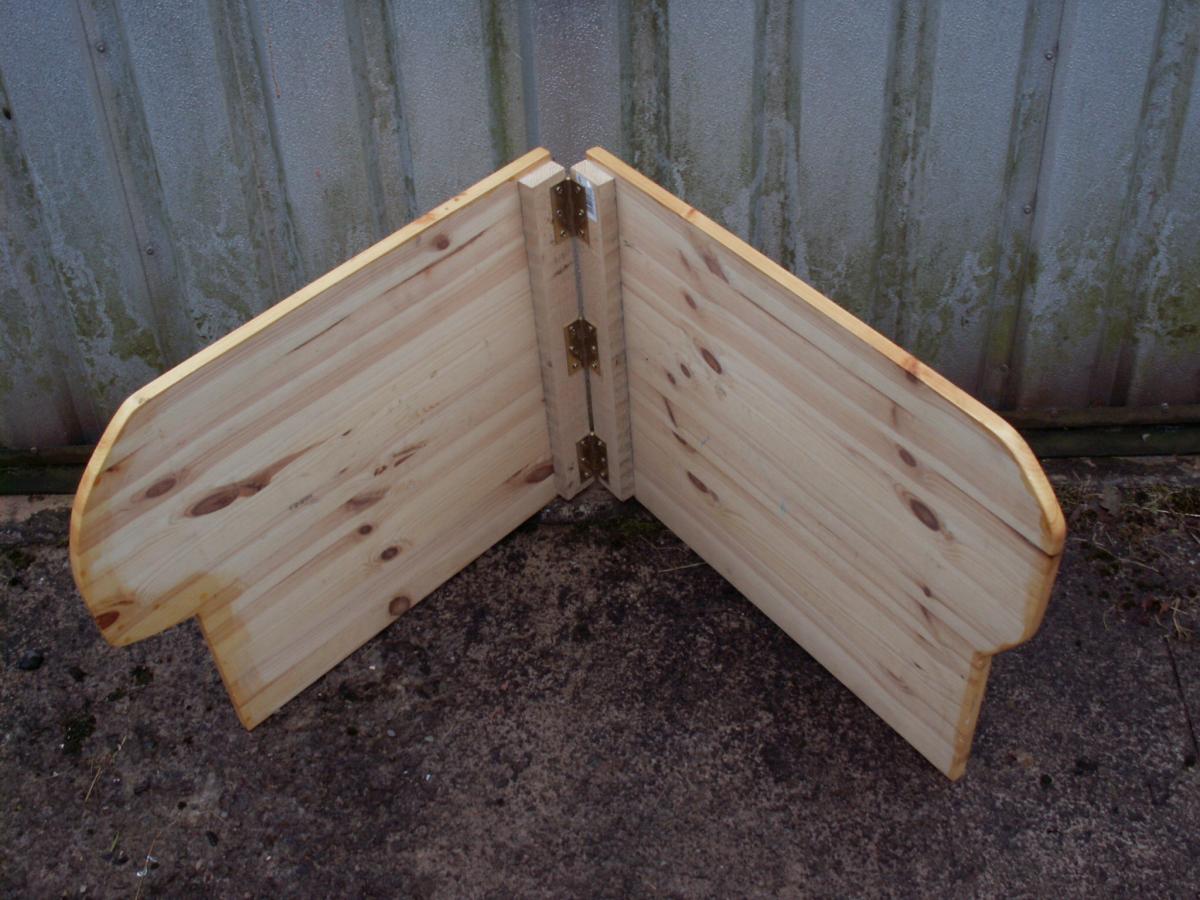

Okey-dokey, after a few weeks hummin & hawing, I came up with my own idea for a low level rear shelf. This suits my various needs for family use & occasional motorsport marshalling requirements. If you look at the photos, it's obvious what I came up with & as an engineer rather than a joiner, I'm not too dis-chuffed with what I've achieved. It folds neatly in the middle for storage in the garage or carrying on board & doesn't take up a lot of space either way.
The one I have is Mk 1, further mods may be to come, but at present, I'm happy with it. It will take the weight of a camping gas bottle with 2 ring burner, kettle, frying pan etc. the usual requirements for rally marshals in the woods at unsociable hours of the day. (Dry cure bacon & Stornoway black pudding the best roll filling!!)

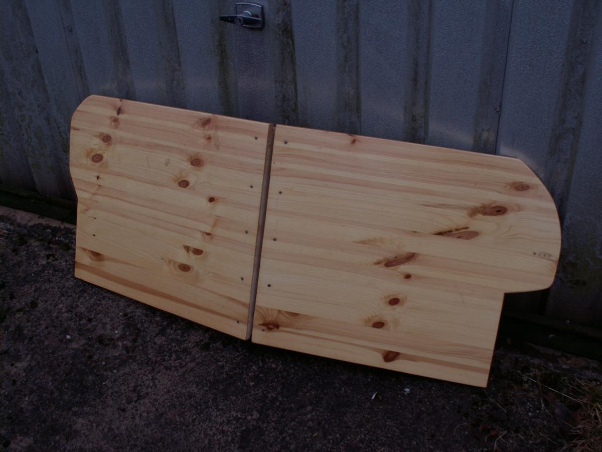

I made this from one sheet of pine & made cardboard templates to shape the bits to fit into the sides, then cut it down the middle, attached battens & hinges underneath to give it some strength. Quick couple of layers of yacht varnish & voila, a very useful mid-level shelf. It won't take a massive weight obviously unless you use "weapons-grade" material & hinges but it'll take anything I intend to load on it.
Mk 2 might involve battens on the top front & rear to prevent stuff flying off, so the shelf can be left in place, watch this space for an update.
Cheers.
I only use it when stationary, don't carry anything when travelling, sometimes leave it in place when moving, other times fold it up & stow down one side held in situ with bungies, it all depends what I'm doing that particular time/day. It makes a great picnic shelf when meeting up with the family, scads of room for the grub & if it's wet, we can stand under the open door. I leave the normal shelf at home if I'm taking this one.

very nice! The shelf you made shall surely hold much more weight than the higher placed original.
As 33Q stated,some felt lining on top will make it blend into the Yeti,unless you like the wood finish,which is great.
I hope that's not for storage when you are travelling - what will constrain the gas bottle (or other heavy objects) from hitting you in the back of the head in a sudden stop situation? - do you still have the standard parcel shelf over the top or use a cargo net?
Other than that - looks like a good way to add a layer of storage.

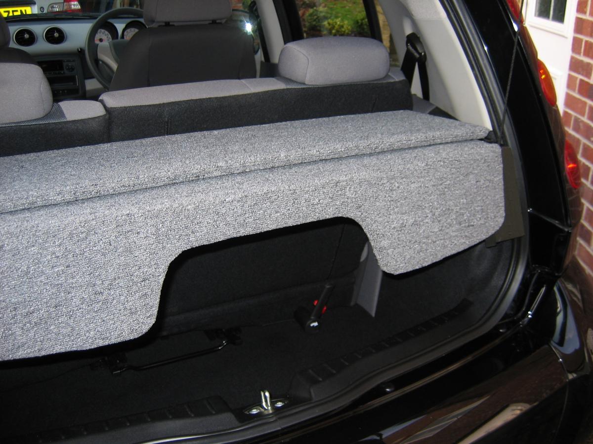

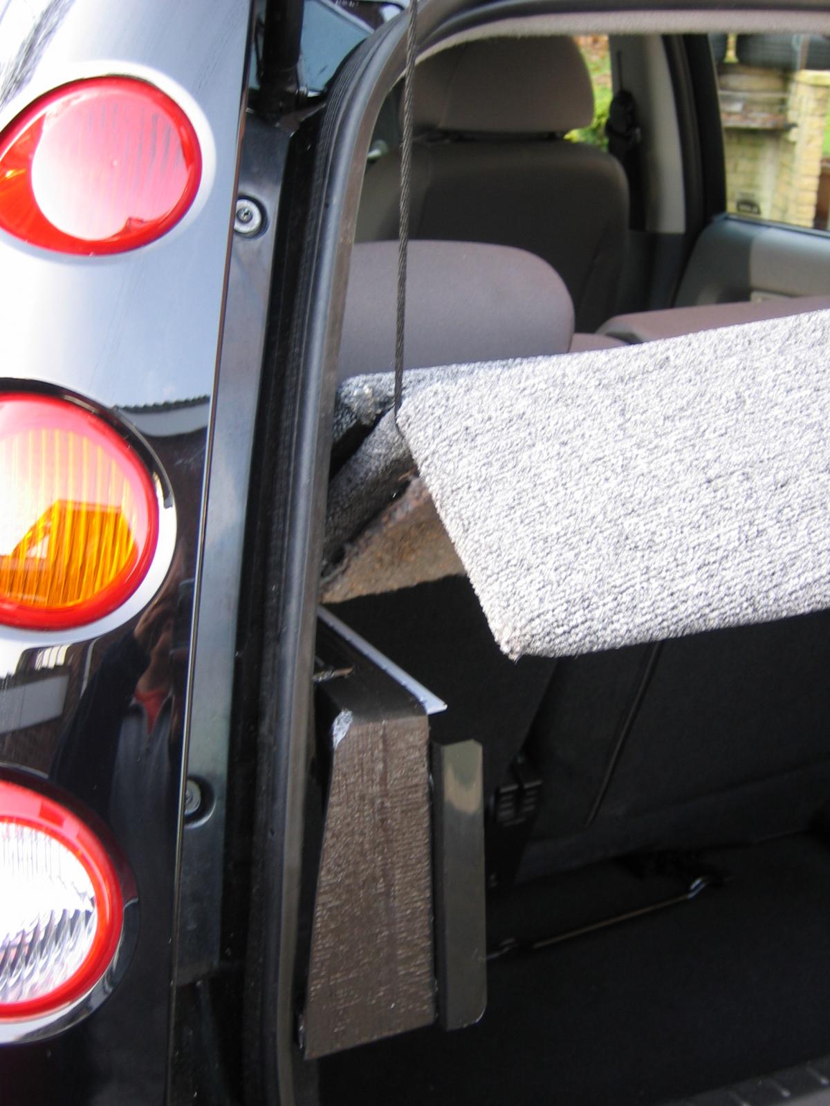

Here is a little of my handywork.
I had a Smart ForFour a few years ago and no shelf was supplied or available. Keen to keep prying eyes from what was mine I came up with this.
