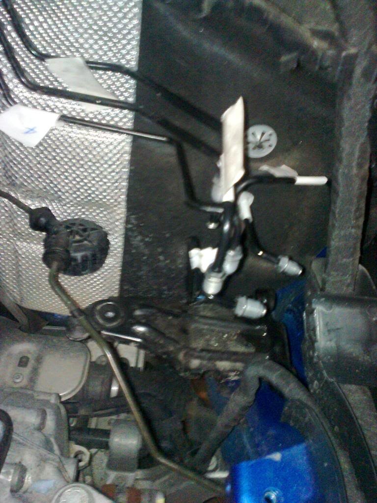

Got carried away today and changed my ABS pump :rofl:
Done the job myself too, so pretty pleased
this is how it looked
Edited by Eddie-NL
photobucket removal
Should add that I now have Hill-Hold
