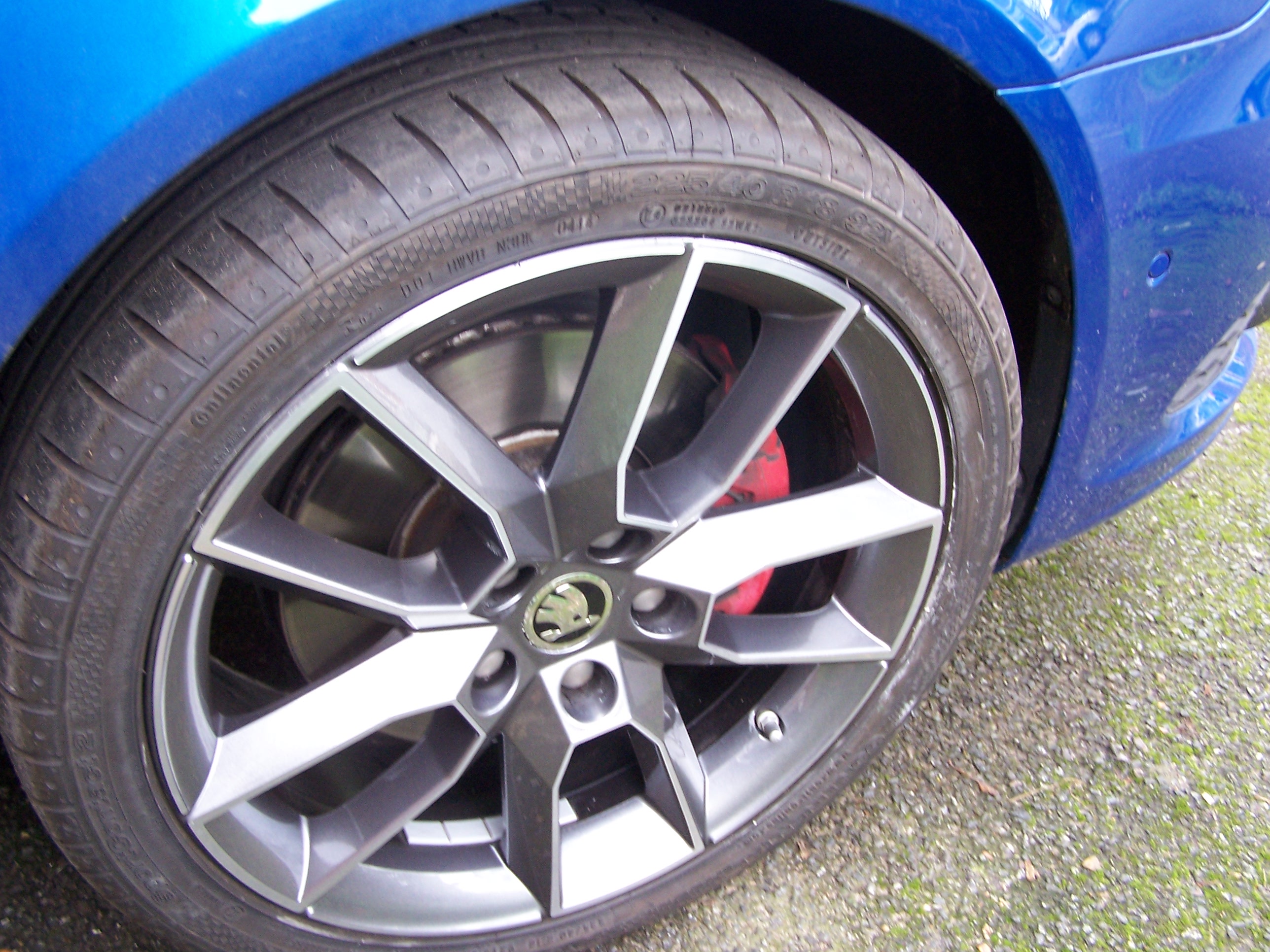

  • New Octavia 3 Gemini Wheels fitted today, will get a distance pic up when the car has had a wash       TPMS High Version also fitted   Valve   Maxidot display o

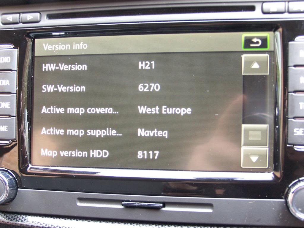

V11 map update, thanks to Golfman

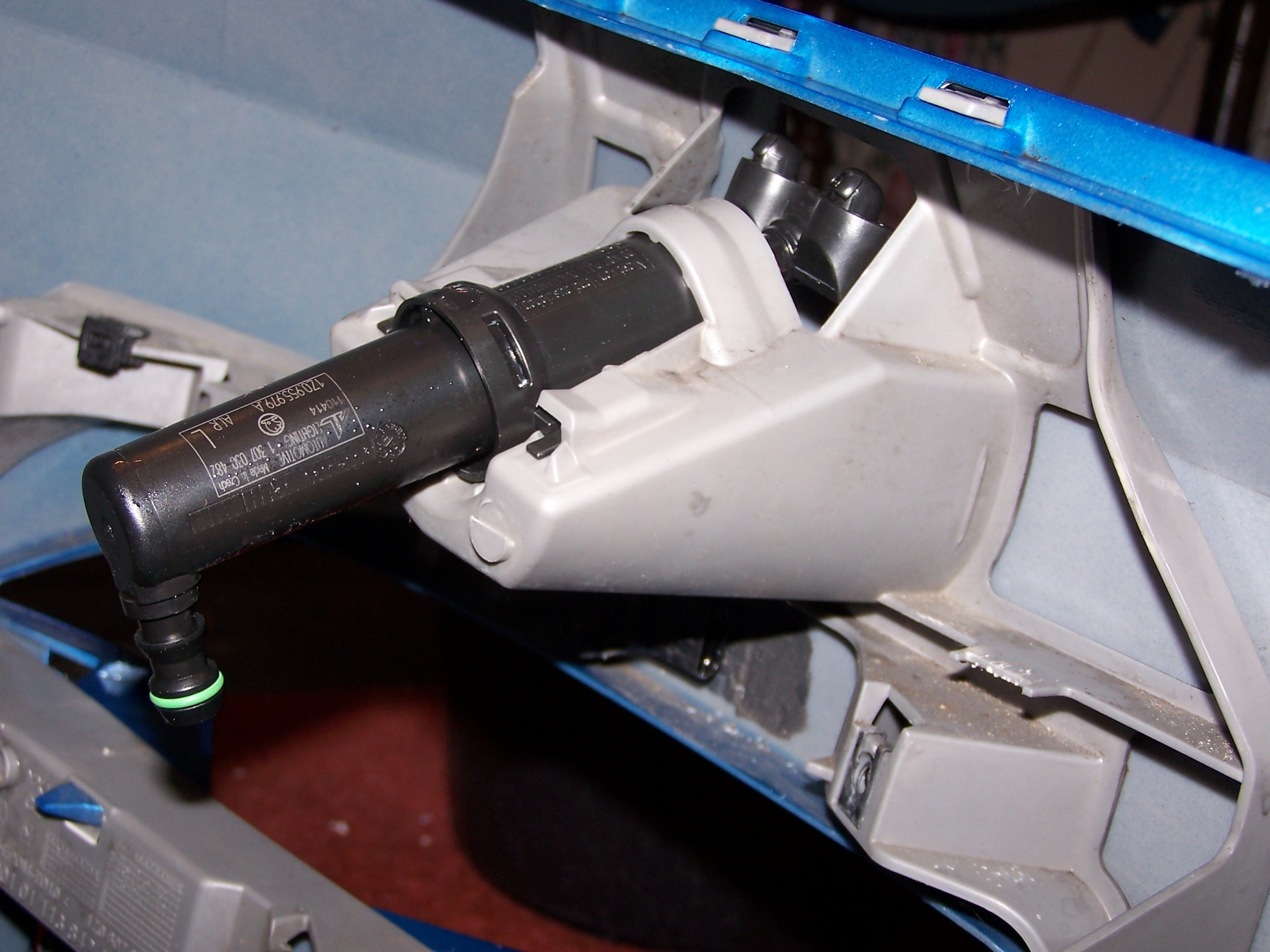

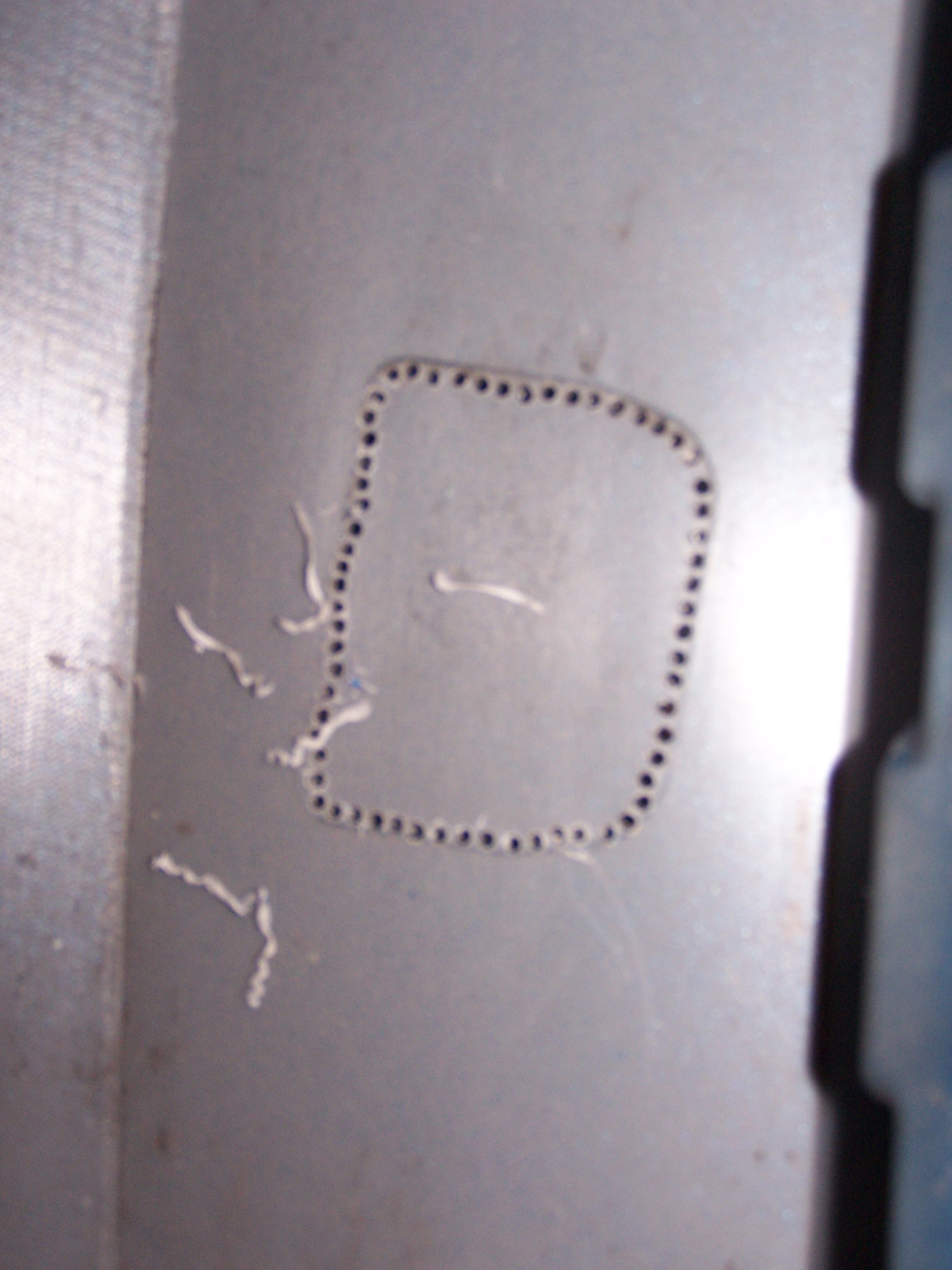

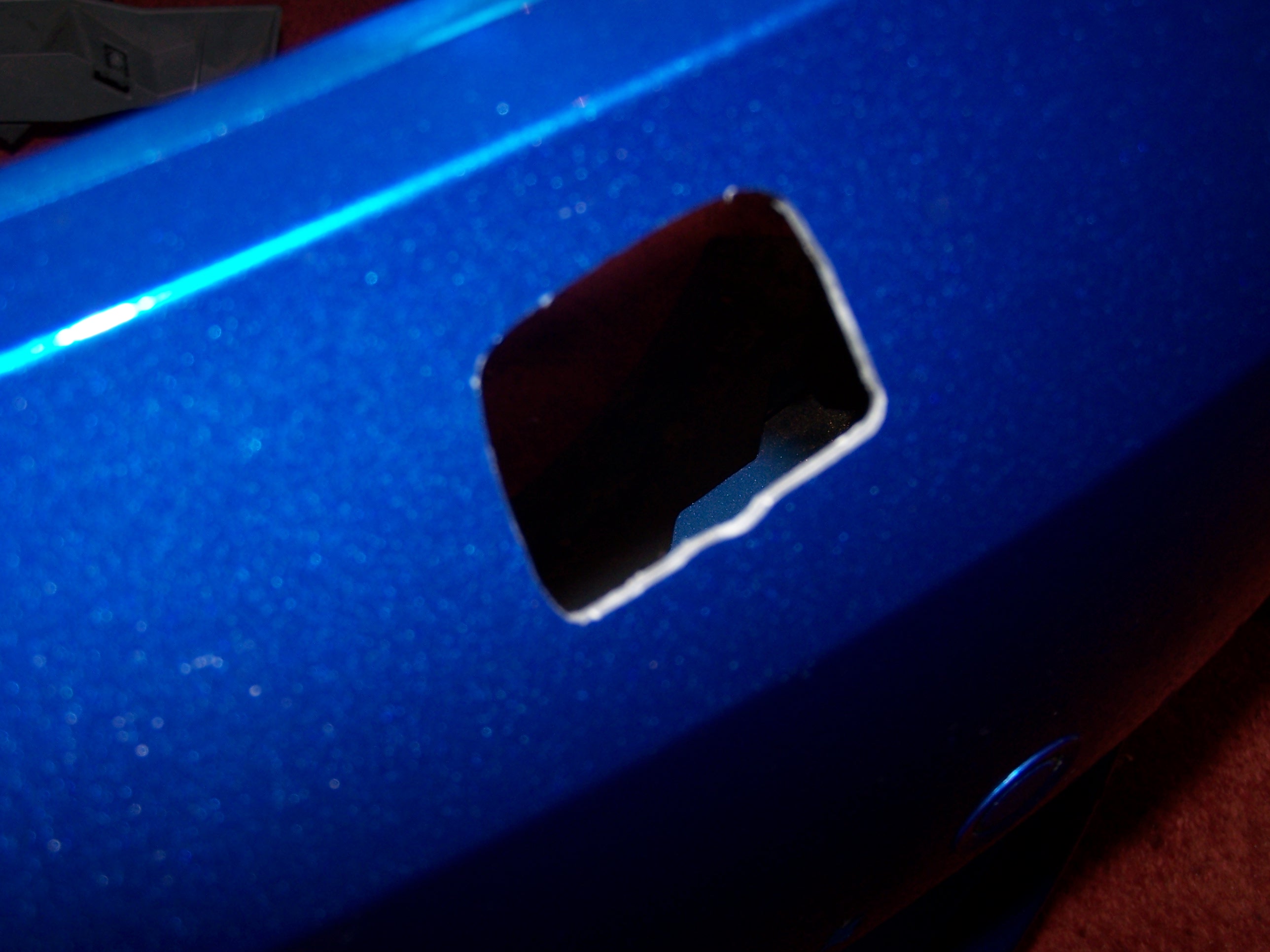

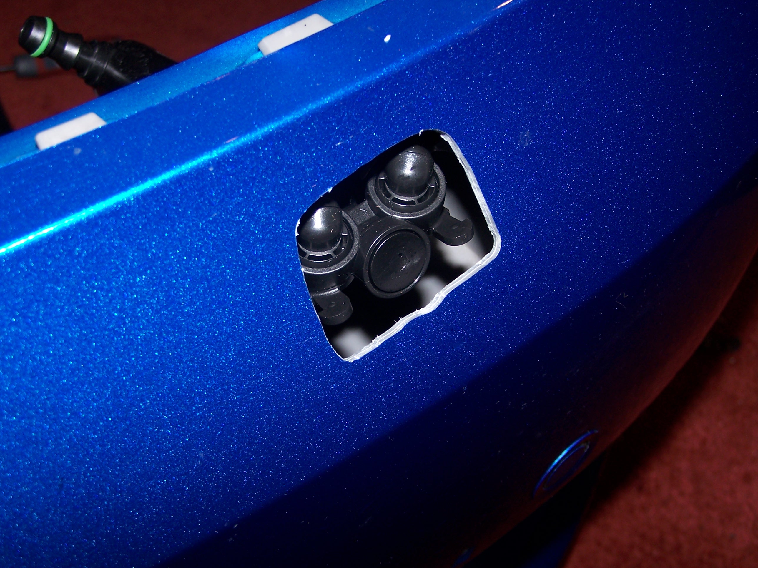

Headlight Washers all fitted and working, before I anyone posts "what is the point of these"
They will be required if I end up up retrofitting Xenons, which nearly came close as I bought 2x headlights, but unfortunately the Courier managed to damage them.
Anyway the markings are on the underside of the bumper, so I plucked up the courage to make some holes in my bumper

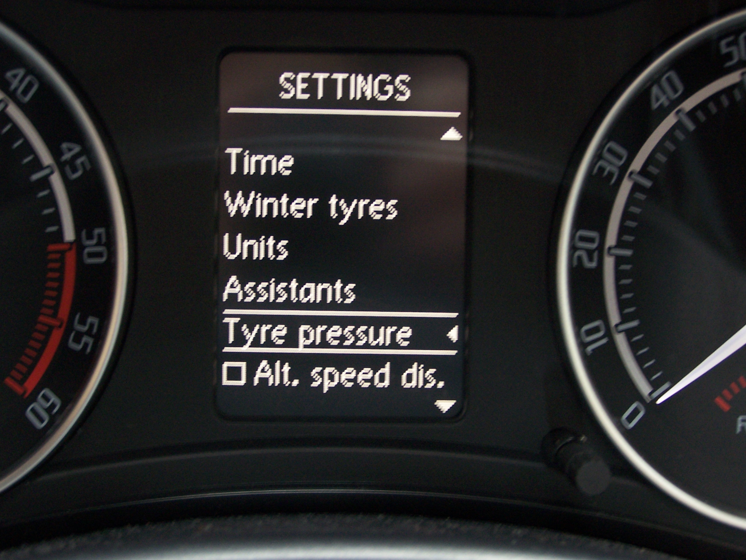

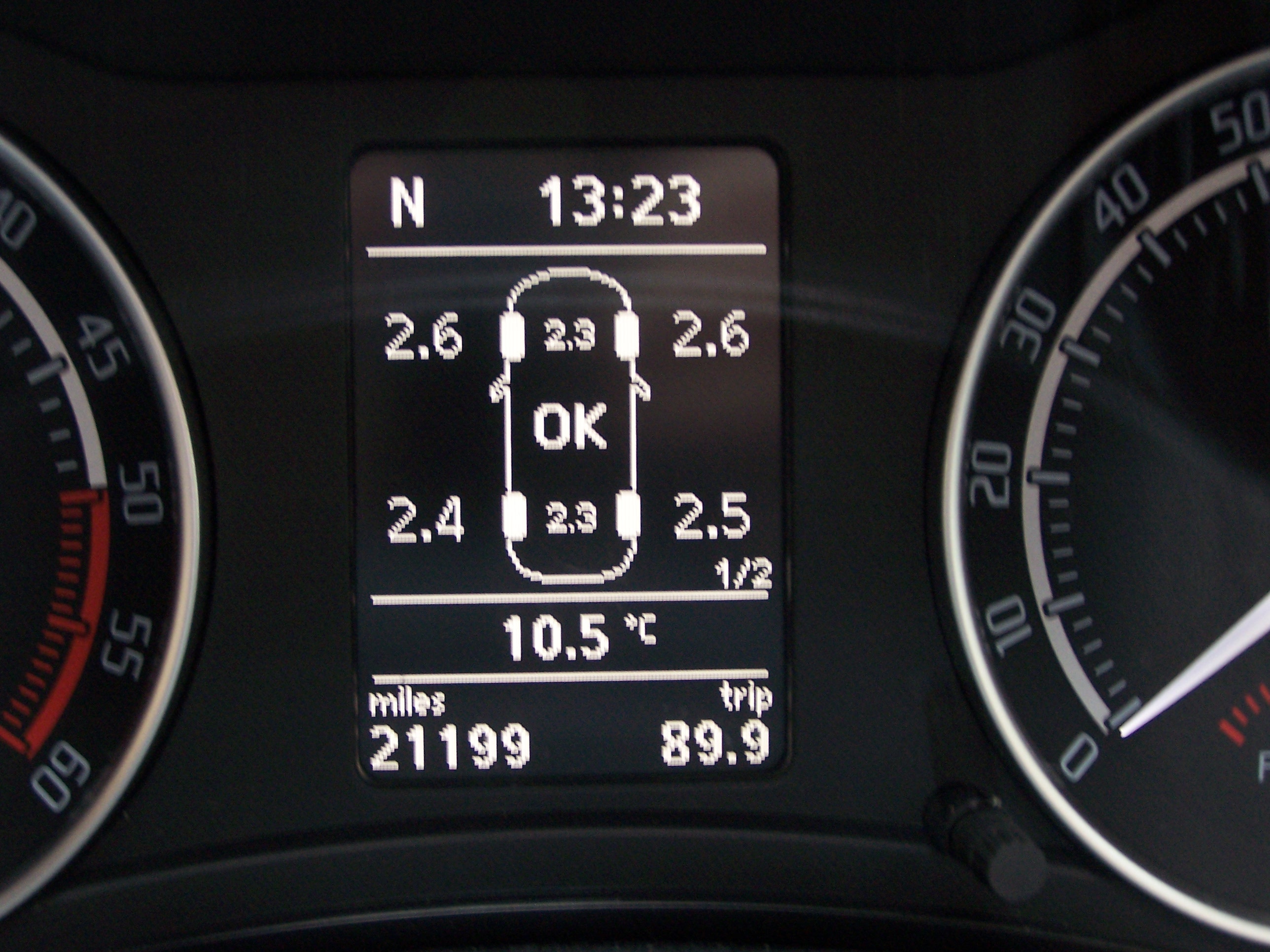

They look really good Eddie. What was needed to fit the full TPMS and was it difficult?
It is 4x Tyre Valve sensors and a module with a loom.
Fairly easy to fit the wiring, I got the garage where I bought my wheels from to fit the valves
