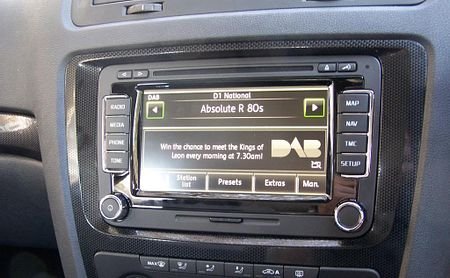

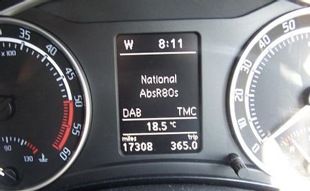

New Update
Changed the Roof Antenna and Columbus for a DAB version
Sounds clearer and I think the new unit is a bit faster than my old E version
Edited by Eddie-NL
photobucket ransom
Nice... Is it just the antenna and unit, or did you need additional wiring? Quite interested in doing this if I decide to keep the car long term.
I had to run another extension cable from the roof antenna to the radio, which was easy.
Hardest part was getting the columbus back in the radio cage with all the cables that are behind it. I ended up cutting some of the radio cage away
Another nice mod Eddie.
Your new Columbus doesn't say "Columbus" on it?
Well spotted, hadn't noticed till you mentioned it.
It has the newer start up screen logo
Just had a look on ebay and some units have columbus and Skoda Auto on the top and others don't
also had a look at the 3x FL Superbs that my local dealer has for sale, none of them have Skoda Auto or Columbus on them
Thats nice. Does it do am/fm too?
it does have them too
Then its a tempter for me too. Was the dab version much more expensive than the standard one?
