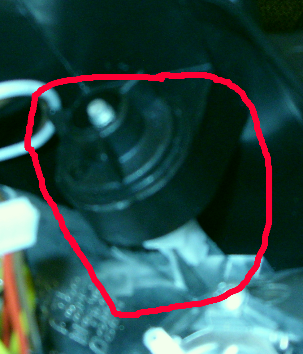

Got one niggle, to fit the motorised beam height adjuster I need to remove the fixture that came with the Lamps.
Diagram states turn to clockwise or anti-clockwise depending which side Lamp it is, and when I have, I cannot remove the blinking cap & bolt. !!

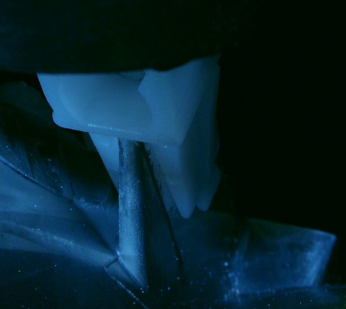

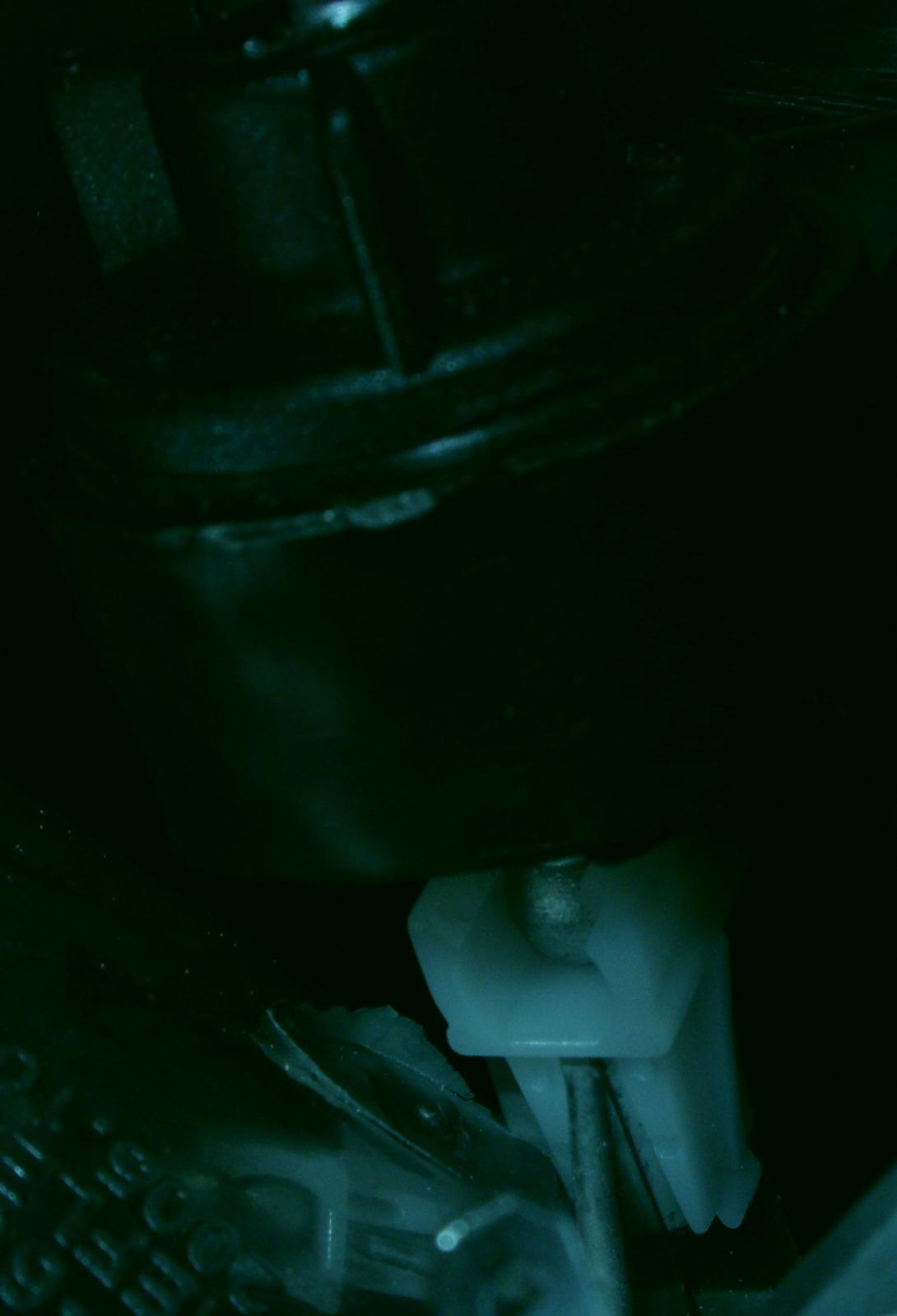

I am having trouble to remove the fixture headlight retainer cap and bolt, that is fitted when received ,in order to fit the motorised height adjustment units, from original headlights.
Seller simply said, turn caps either clockwise/anti-clockwise (depending which side headlight,) to an angle of 45 degrees and remove rounded head bolt from it's white headlight white retainer clip.
I have trouble doing this, owing to the fact the rounded headed bolt does not want to simply slip-out of the white retainer slot.
If you read this, having had the DEPO headlights how did you manage, or did you not bother and just fitted without bothering to fit motorised height adjustment units?

Yes. Turn the caps either way until they are loose then I found that using pliers to pull them was easier. They are hard. But don't be worried about pulling them. Don't have a tug of war just enough to ease them out. I had the bumper and both headlights off in the amount of time it took to get the motors out.

I admit (as above, see photos)the fight you will have, to get the fixed headlight retainers/keepers out.
Agreed, they ARE a right PITA to remove. I broke a part of the white plastic off in the process (some bodgemanship fixed it)
John, all I can say is be gentle and patient when swapping the manual adjusters to the motorised ones. They look great when on though :yes:
