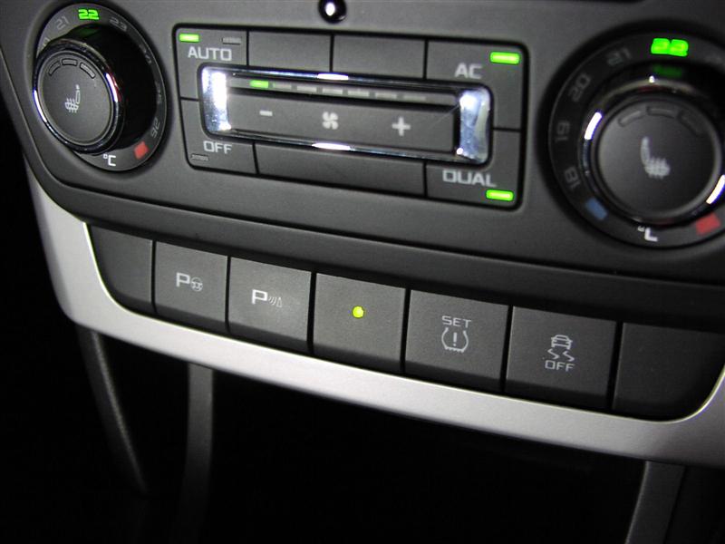

So that I know what the state of my battery is. I fitted a 3mm Tri. coloured LED driven by a small circuit that indicates the state of charge on the battery - Green = Good (+13v) - Amber = OK (12/13v) - Red = Battery low (-12v). A fairly simple circuit. I think something similar is available commercially now. The LED is fitted into one of the spare switch blanks in such a way that (according to the dealership that services my car) it looks like a factory fitted option. If anyone wants the circuit details etc, PM me and I will help if I can.....................Tony

photos?
Really sorry for taking so long in sending this.......... :sweat: :sweat:
I chose to mount the 3mm LED in a spare switch blank. Measured the LED and drilled the hole 0.1mm undersize. This enables the LED to VERY firmly wedge into place without any holder and the top of the LED is flush with the surface of the blank.
Happy Christmas ALL.......................Tony
Edited by Great Yeti
Looks very neat.
