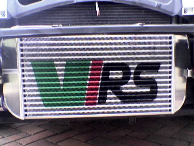

Got the forge one on mine and it's a great bit of kit,may be pricey compared to the others but a quality product,modified the crash bar on mine too for more airflow and I also stencilled on a vrs logo which isn't to everyones taste but it's different
But then it got neglected and a bit tarnished so i painted it black and re did logo
