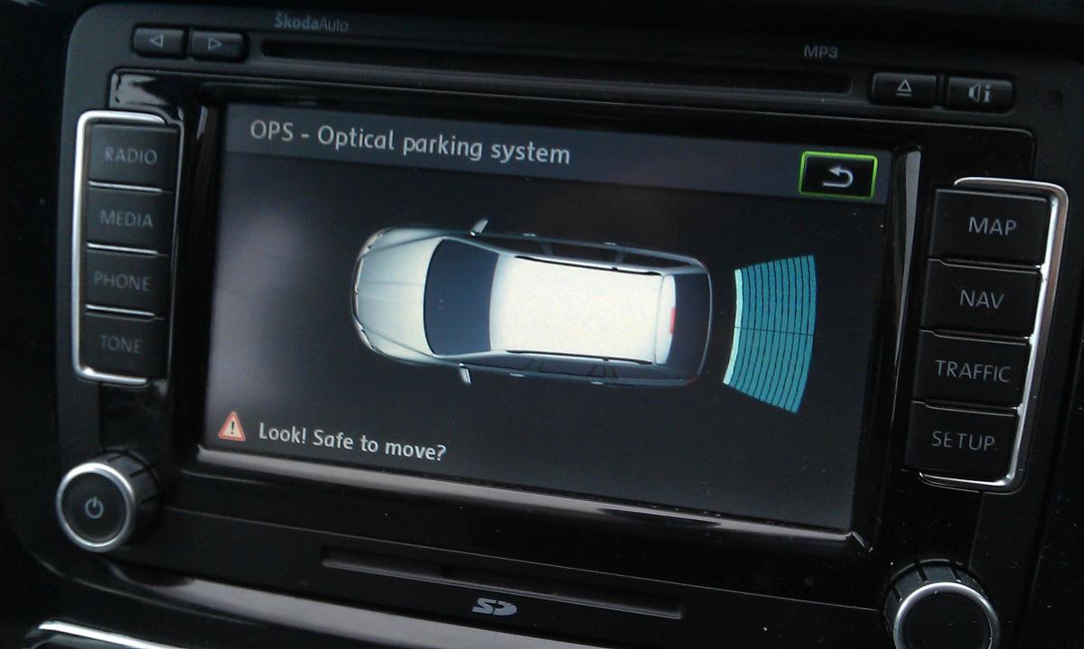

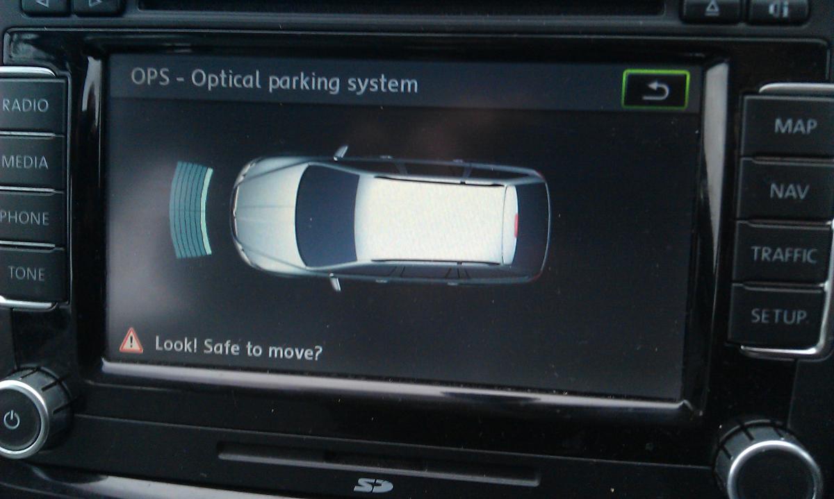

Looking at the pictures of it in action, do you have an estate then? I hadn't realised!
Yep an estate, and much prefer it to my previous hatch....

Does the OPS display 4 point distances for each end (Front/Back) or 2? From the Pics I can see it displays 2 for each end of the car, shouldn't it display 4?
Yes 4, just coincidence with positioning at time of taking pics.
I wondered about that too, glad it shows 4. Makes me wonder about doing the front, lol
