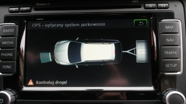

Hello,
i'm trying to implement software translation between old PDC and new OPS system.
I have a question - is OPS active (car picture on the screen)  when ignition is on BUT engine is not working yet?
Thanks in advance.
Yes it is active with the ignition on but not the engine (once the Columbus screen fires up!).
Adam
Thanks Adam.
Now it's clear.

Can i ask someone with VCDS and working OPS on Columbus to do following tests?
Test 1:
-Select 37 Navigation
-Select "Coding"
-Select "Long Coding Helper"
-Tick "Parking Aid/Park SteerAssist Monitoring inactive" on byte 0.
-Press escape and save new coding
-Exit VCDS and reboot Columbus by pressing < > and star/mic button simultaneously.
And then after reboot check if OPS is still working.
After that untick this bit and save the coding again.
Test 2:
-Select 19 CAN Gateway
-Select "Installation list"
-Untick "10 - Park/Steer Assist"
-Press "Save coding"
This will let me save a lot of time with my PDC to OPS experiment.
Thanks.
Majonez
Test 1: Yes still worked
Test 2: No didn't work
Adam

Sorry for reviving this topic, but i want to say big THANK YOU to all who supported me by answering my strange questions ;) Finally (some time ago) i managed to emulate OPS by my Atmel MCU device. Obviously it would be much easier to just swap PDC ECU to newer type, but...  the joy of experimentation is most precious thing! :)
