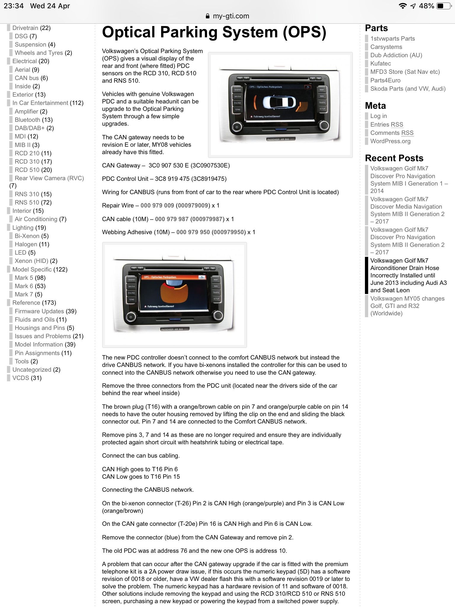

Hi I am going to have a Columbus fitted into my pre fl Octavia mk2 2006 and I currently have stock pdc rear parking sensor system and I believe that it is not compatible with the Columbus so I need to upgrade to ops.
The module ops module I have been told to buy is 5J0 919 475 A as I only have rear parking sensors 4K
I have found out the address for the module is I have is 76 and has to be changed to 10 by VCDS.
The article which applies to me is this
https://www.my-gti.com/739/upgrading-of-volkswagen-park-distance-control-pdc-to-optical-parking-system-ops
The only thing is the wiring I sort of understand what the article said I have to do by taking out pin 3, 7 and 14 from the orange connector which goes into the module and taking out pin 2 on the can gateway.
Then I use 000979987 twisted data wire can connect CAN high to pin 6 and CAN Low to pin 15 of orange module connector T16
(Do I remove the current wire in these pins and replace)
Then connecting the other side of the data wire to canbus gateway connector (T-20e) which I believe is the blue connector in the attached picture that plugs into the can gateway CAN high is pin 16 and CAN low is to pin 6.
Then remove pin 2 from the same can gateway connector.
Then code the new parking ops module to address 10 with vds
However once that is done what do I do with the wires left so the pin 2 from the can gateway connector and the pin 3, 7 and 14 from the module connector (orange aka T16)
I believe they need to be insulated so would using electrical tape work and if not will butt connectors work.
Also so in the items list on the mygti website it has a repair wire in the list 000 979 009. What would I need this for ?
Thank youFA62D64B-ED42-43DA-B11D-A16C215883B5.thumb.png.7af8f50bedf27230e1576d9427fce1ad.png9CB20659-5A20-4D3E-B93C-465339959765.thumb.jpeg.e6d8ee3805f1f0ca59c87359e22f47cb.jpeg

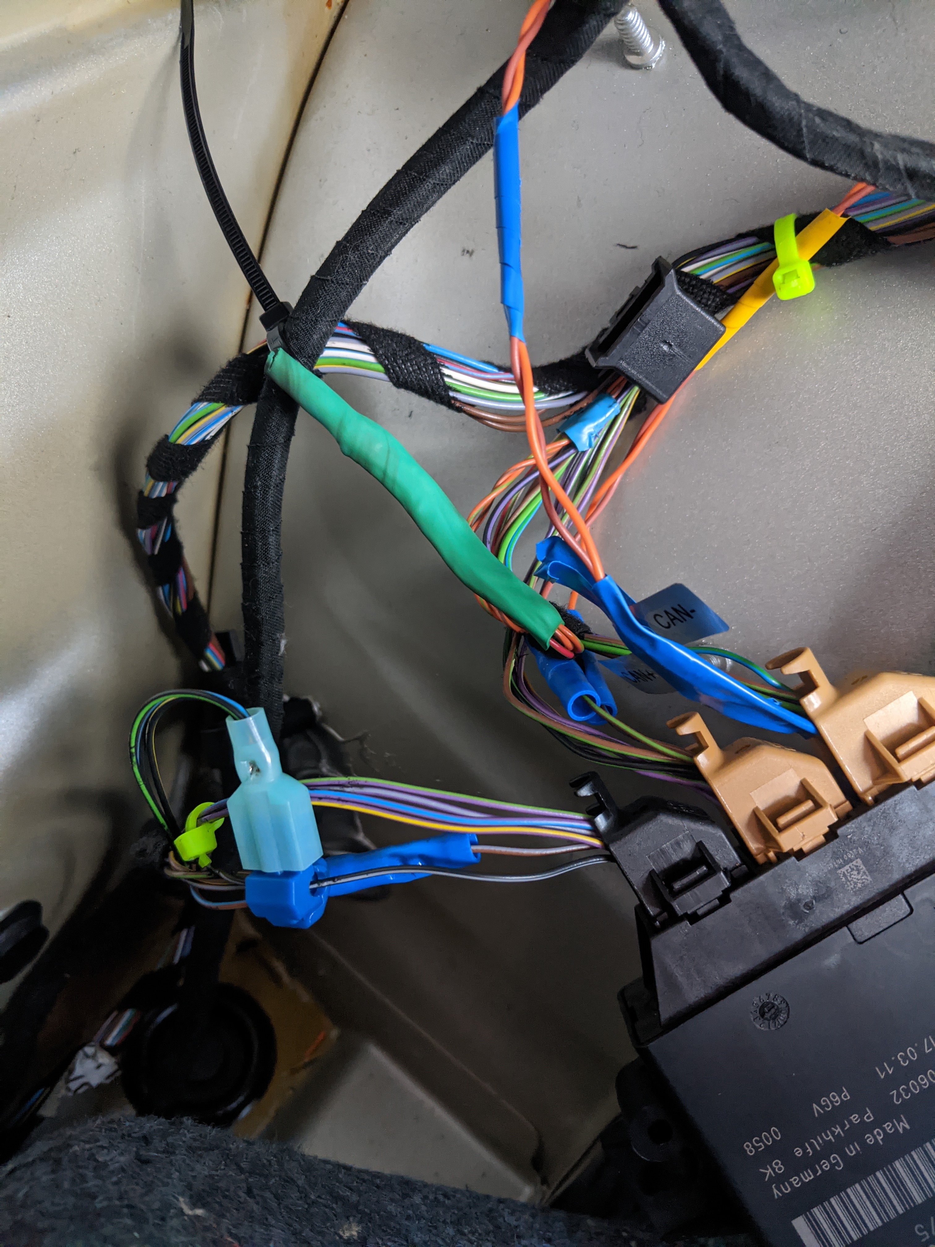

Now turn the attention to the back of the car and strip away the trim from the left side of the boot. I started by taking the centre trim of the rear sill away (three plastic nuts by spare), then the lower d pillar trim (screws and clips), then the c pillar upper trim, and then the luggage cover support. You need to remove caps from the hooks to access the screws and also there is a screw behind the big hook. Then I pulled the rear seat bolster off at the top (just a good tug), and unscrewed the side trim. The rivet things by the cd changer (if you have one) pull out easily with a long nose pliers applied on the centre pin. This is for an estate, a hatch will be slightly different I imagine.
Now you can see the controller on the inside of the wheel arch, with three plugs, one bigger 16 pin brown plug and two smaller 12 pin (brown and black) plugs for the sensors. Pull them all out and take off the old controller (two nuts), and then put the new one in its place. On the 16 pin plug, take the cover off and extract pins 3, 7 and 14, these are no longer needed, so insulate them off and cable tie them to the loom away from the action. The CAN wire you attached to CAN high should go into pin 6, and the wire you attached to CAN low should go into pin 15. I soldered a small piece of repair wire onto the end of each wire to provide the terminals.
If you have front sensors the new controller requires a second pdc buzzer to be installed (the old one managed with just the one). If you want OEM, the other loom you ran earlier needs to be connected to pins 3 and 4 of the smaller brown plug (they will be empty), and the other end of the loom is then run behind the dash to the speaker which is attached to the ledge just to the left of the steering wheel, and accessible from the hole the top box sits in, or from the hole for the stereo (you needn’t remove the stereo, but its easier if you do). Again you use the repair wires to provide the terminals and solder them to each end of the loom.
The old controller had separate outputs to each of the rear sensors , but the new combines the positive and negative of all four to a common pin. So take the eight positive (blacks) and negative (browns) pins out of the black 12 pin plug, cut the terminals off, join the four positives, join the four negatives, and then solder a terminal onto each join. Plug into pins 8 (negative) and 11 (positive).
Finally you need to get someone with VCDS to code the car to tell it to use address 10 on the gateway, not 76. Then code address 10, I used 100001, but the long coding helper will give the options and you need to choose the relevant ones.

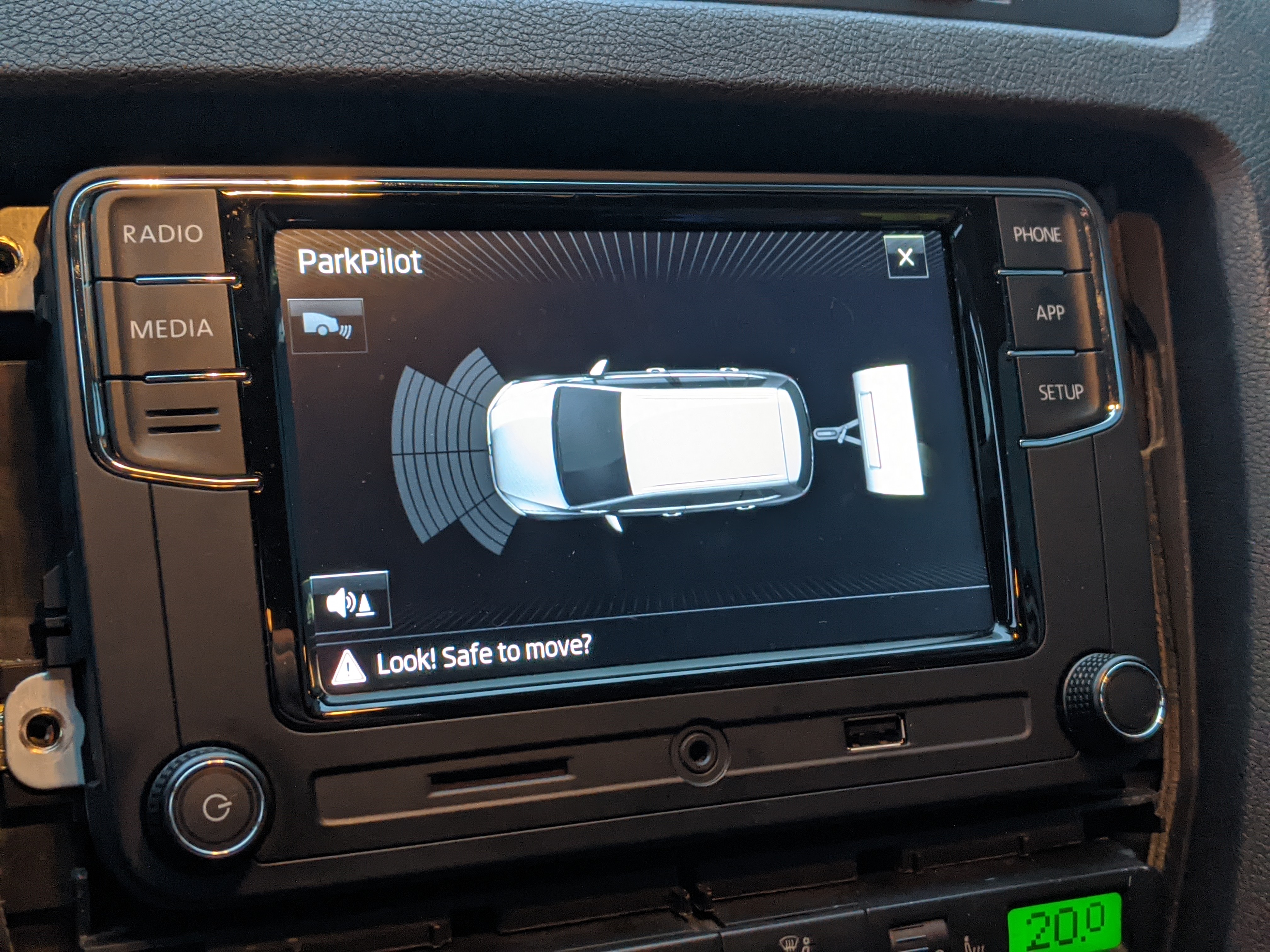

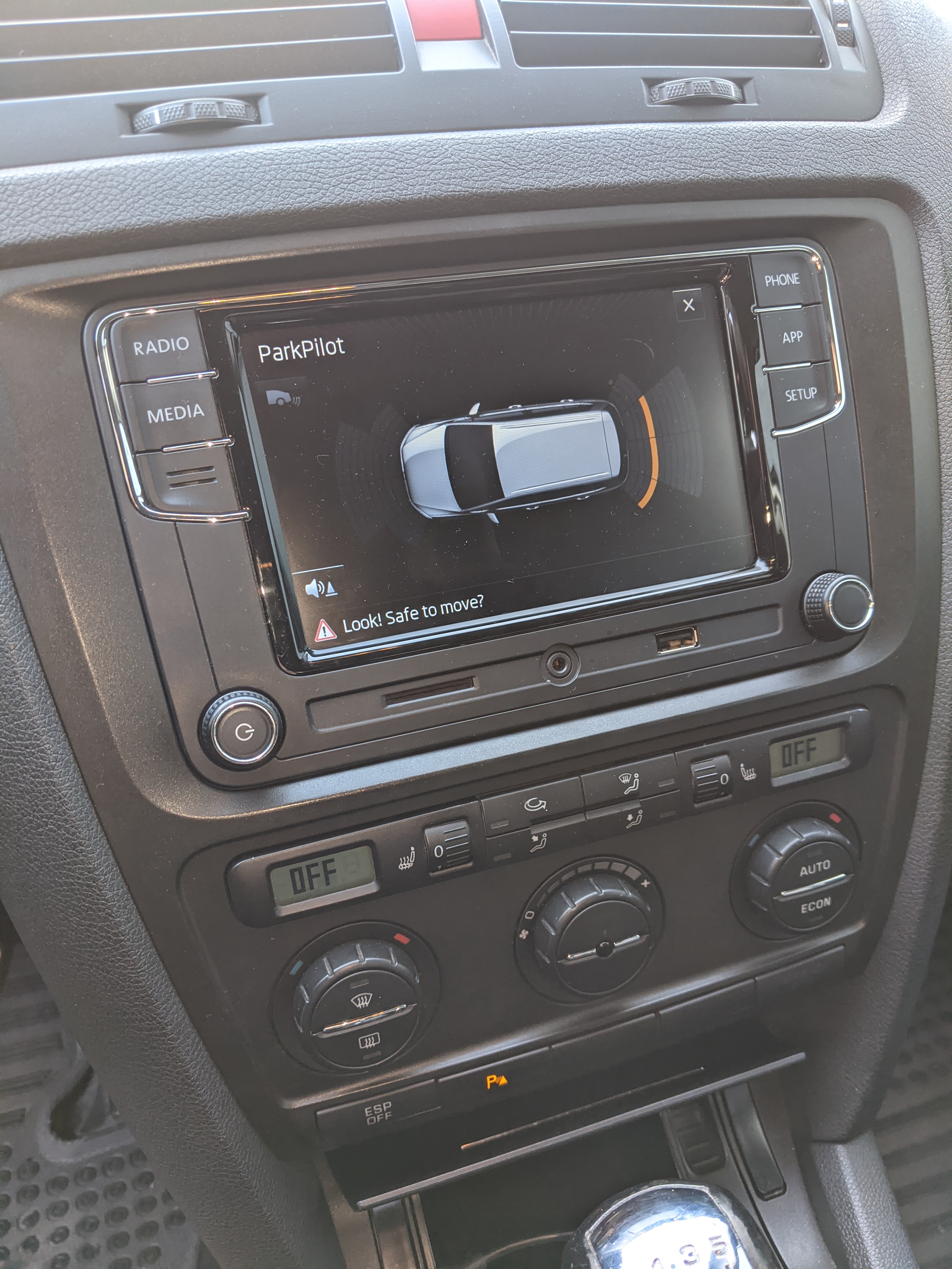

I have just done on my 2007 Octavia with front and rear factory fitted sensors and it works brilliantly. What I can add to the existing knowledge here is:
  • No need to find a Golf OPS module, one from an Octavia with the same sensors setup (front & back or just back) as your car will do. I have used 1Z0919475E
  • If you can't find new wire terminals to solder everything into a single termninal like the guys are explaining, simply reuse one of the existing sensor wire terminals.
    • Example: Remove 3 of the 4 sensor wires, carefully cut away some 20 cm of the wiring loom textile cover, solder or use connectors to join the wires at least 5 cm away from the termination of the 4th one. This way you reuse the termination of one of the 4 wires when joining them.
  • If you are doing this alone, se a chair to test the sensors and the beeping while watching the display.
  • Remember to code your new OPS unit for trailer support if your car is equipped with an original tow bar. Find a trailer to do a quick test and ensure the car goes into trailer mode and rear sensors are disabled while the radio shows the right animation with a trailer.
