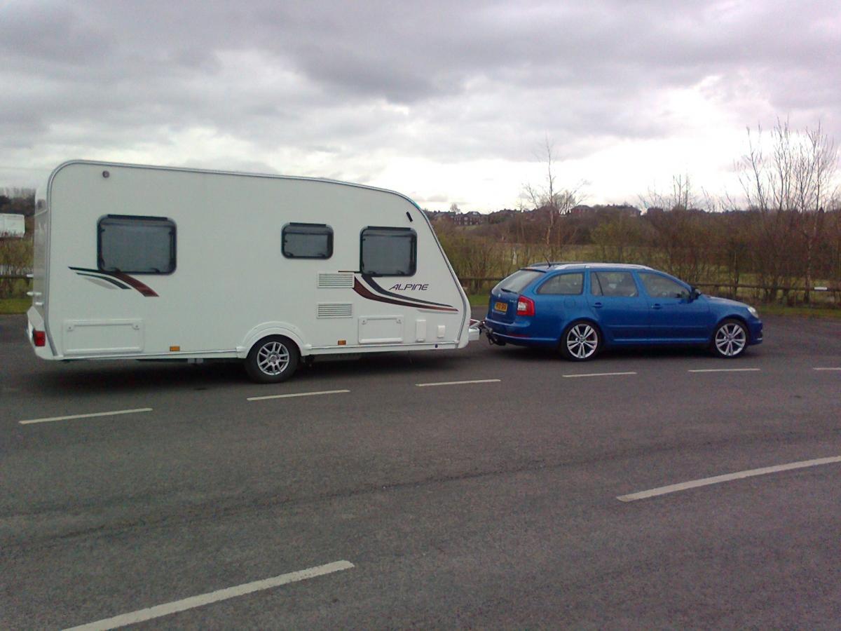

Many thanks for the advice. I went for a Westfalia detachable with electrics to match the car. I'm now thinking about the MAD air suspension assisters to give a bit of help to the rear springs although it doesn't seem too bad right now.
Here's the outfit, as they call it.post-92896-0-05148400-1366576075_thumb.jpg
