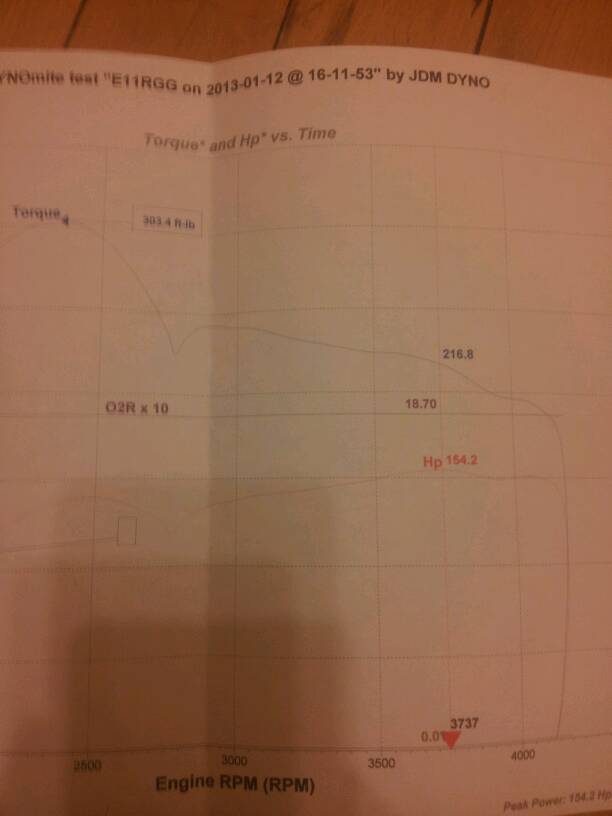

Ah right, ill post a pic of the printout in 5 mate, gonna get it VAGCOM'd asap
Not a very good picture :/
Sent from my GT-I9100 using Tapatalk 2
Ok that's a terrible picture, but it looks like there's a massive dip in the torque?

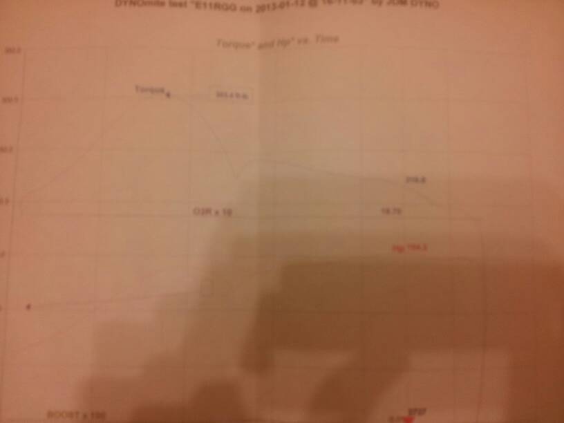

Haha didnt realise it was that bad, this one is slightly better
I think you need to find out whether that dip in power and torque is due to the map, or something wrong.
Can you feel it drop in power?
Nope i cant mate, if i get a vagcom reading and it comes out alright then will it be down to the map?

torque is healthy @ 303lbs/ft but then drops badly.
