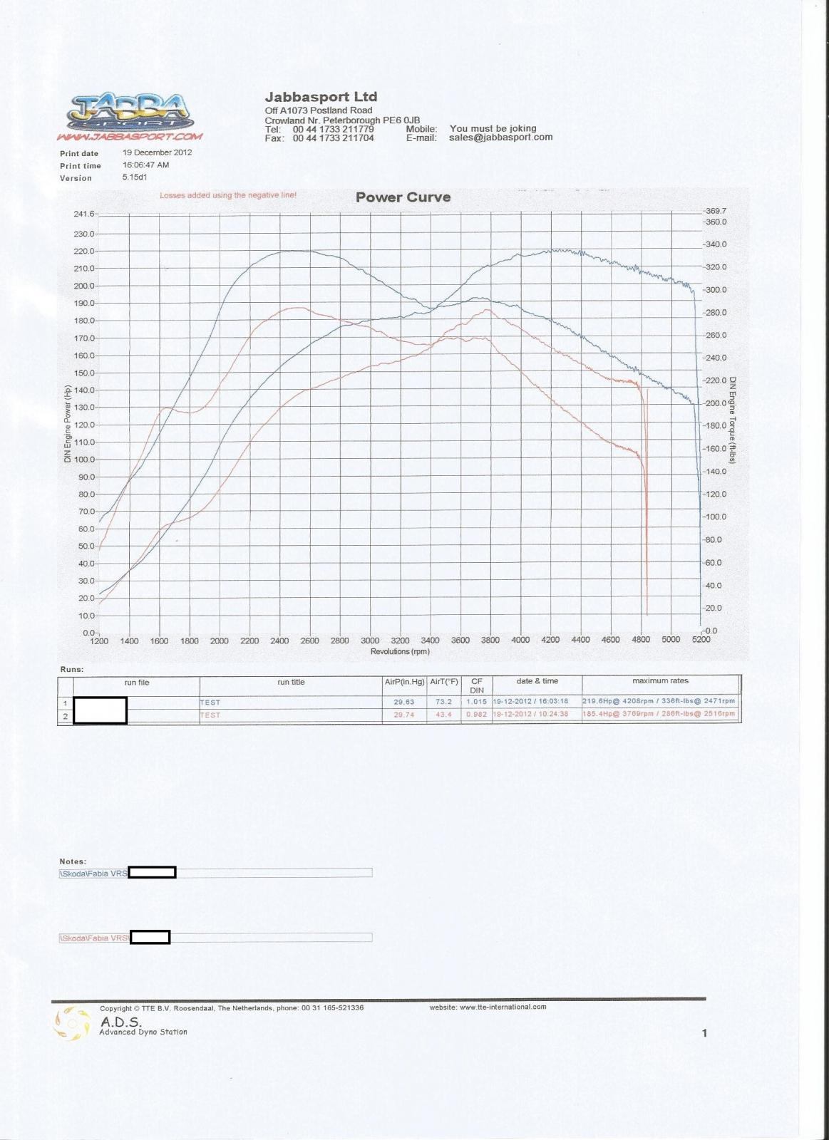

Had the fabia on the dyno today.
Standard apart from an AWESOME GTI remap and a homemade decat with K&N panel filter.
I was quite happy with the results!
What have you had with similar mods?
Same, however the figures above are nothing to write home about because we don't know what it ran standard likelly around 140-145BHP and we can't see the rev's.
Edited by ajs_vrs
Each column = 500rpm at a guess.
Not bad dude :) sharp old torque spike but must be fun to drive :D
There were a couple of threads on bhp figures if you can find them, like a leaderboard type thing.
Possibly a bit out of date though, but may give you an idea of figures and mods.
That tourqe curve looks abit sharp to me. Also you might want to try hide your number plate better, its on there twice.
Well spotted Joe!
Not too fussed about that really as I know I have uploaded photos of the car with the full plate before.
Yes I did think the same with the torque. I could barely hold it straight before i swapped for the powerflex bushes!
Very sharp at the bottom end but it has resulted in a noisy DMF.
Just thought i should warn you :)
