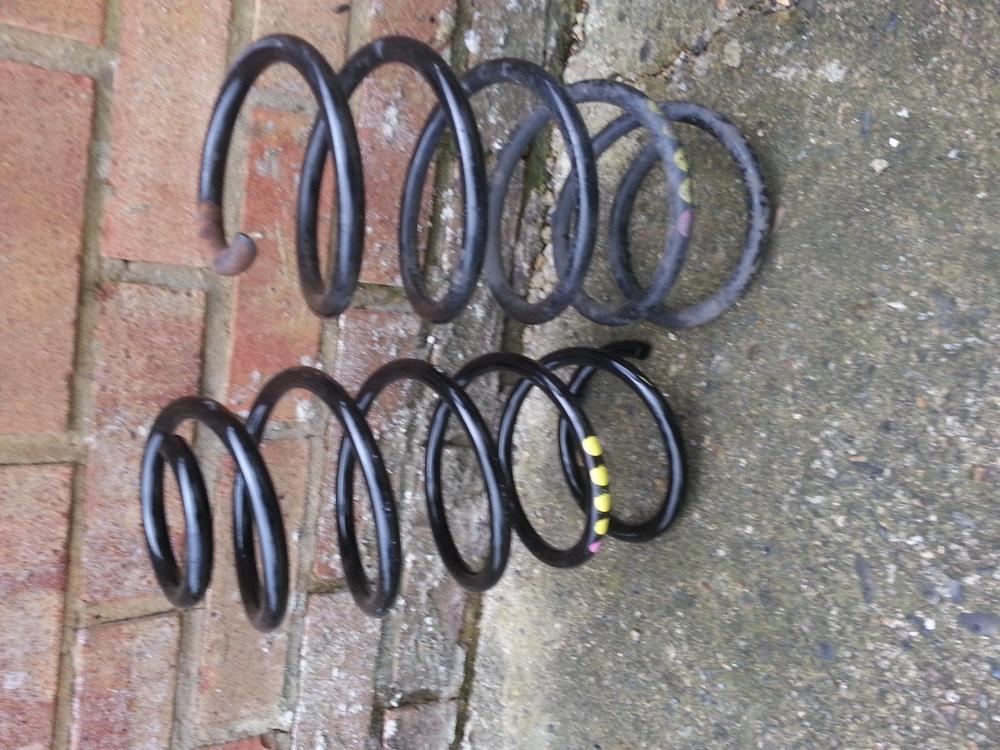

My front offside spring has broken right at the top, causing a bloody annoying 'KABONG' when turning the steering. I know this will involve at least changing both front springs and seeing the price of genuine springs I'm wondering if it's worth investing a little bit more into a cheap(ish) coilover kit? Can anyone recommend a cheap(ish)kit, I'm not after lowering the car as I use it daily to ferry my 9 month old boy around and tbh the front is low enough as it is. I have seen some sub £200 kits on ebay and don't want to buy sh*te. I am quite capable of fitting the units myself so just need advice on whats good and whats pants please.

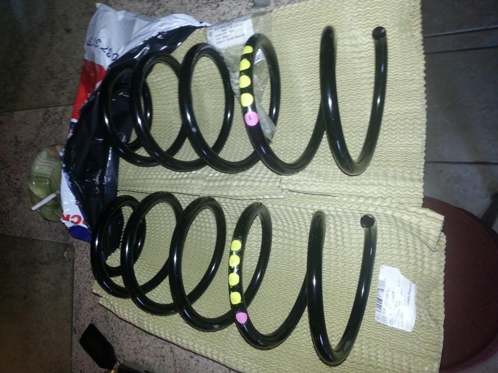

After a long think and counting my limited pennies I have gone with new standard VRS springs from http://www.skodaparts.com/ came to £166 delivered. Thanks for all the input but it seems like unless I have £400+ to spend then it's probably not worth the aggro of the cheaper kits. Seeing as I saved a few quid overall I bought myself some Osram Nightbreaker Plus H4 lamps for the front so I might be able to avoid some of the feckin' huge pot holes that constitute English roads....

Thats just for the front two, can't add pics from my mobile cos I is a numpty I guess but they have one pink and four yellow spots on them...

New springs fitted, along with top mounts and bearings and the car is handeling like it should do again, except for my terrible cheap and nasty front tires which are next on my list...You can see where I'd lost a bit of the top of the drivers side spring Or you could if I could upload pics...meh -.- This is a pic of new springs
