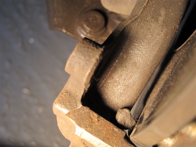

My wife has now covered 18,000 miles with her front drive Yeti and is constantly having problems with small aggregate dropping into the inside of the front cast callipers of her car?

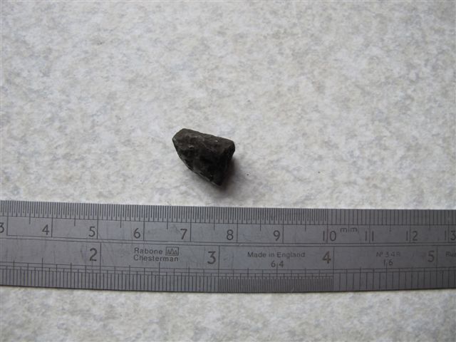

I have now taken off the kerbside wheel twice and the offside wheel once to dislodge small nicely polished stones that drop into the calliper well and stay there to slowly grind away the disk and the stone.
She drives on normal highway roads around Norfolk and does not go off road.

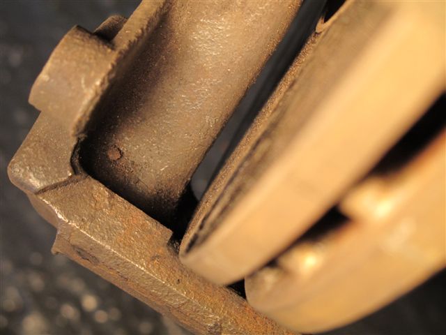

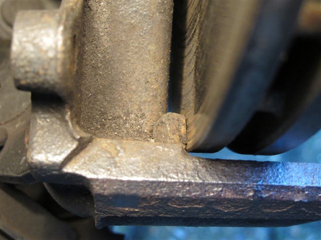

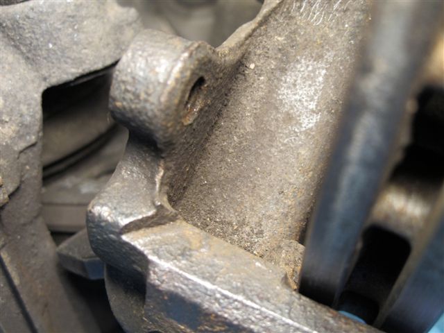

I have looked very closely at this problem and taken close up photos of the offending item plus the stones that drop into the inside well of the casting.
It appears that the design of the castings instead of being flat at the end so that stones just drop off or spin out they fall into a nice large hollow between the disk and the casting at the front and of course stay there?
Anybody else finding this problem or should I fill the well up with “Devcon F” to fill the void. Kidding folks but I am getting fed up taking off the wheels to clear the stones out.

The backing plates looked ok to me without any twists or obvious bends on the plate.
Callipers are free to move in and out without any binding on either side and have never come across this problem on other makes of vehicle.

The front calliper used for the lower powered engines is VAG's long serving FSIII with 280mm discs for the TDI 110. Have the same callipers on our Fabia I.2HTP and TSI 86. However I've as yet not experienced issues with stones getting caught in them, only issue I have had is sticking pads on one of our previous Fabia's.
Main brake problem I've experienced has been with the current Yeti's rear brakes, were sticking pads is a real problem, along with very uneven wear rates between the inner and outer pads. These Bosch rear callipers are a very poor substitute for the Lucas units on the early production Yetis.
Would further suggest again my personally experience, that Skoda should have used the FN3 callipers and 288mm discs as used on the 140 for the 110 also. Obviously not helped by the less than effective rear brakes but our 110 takes some slowing down.

Jacked up the wife’s Yeti and took the wheel and calliper off and behold yet another black tarred piece of aggregate from the Norfolk highways jammed in the dreaded Bosch FS III calliper well?
This is getting to be a real pain as it continues and in my recent correspondence no other vehicle we have ever owned has had this problem or my motorbikes. Unfortunately as I have not come across this constant problem I cannot compare other calliper castings to see if this particular design is suspect to stone gathering.
This is now the 4th stone picked up and its winter so the aggregate thrown down on the roads by May Gurney should not be sticking covered in tar?
