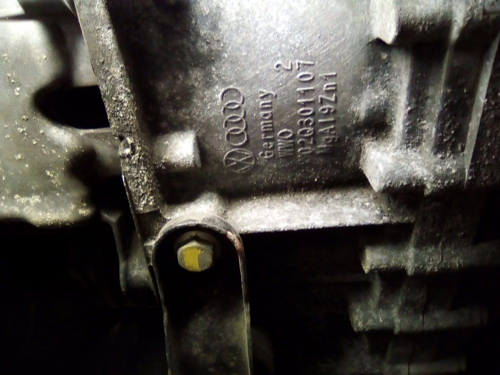

update:   once you can get past the lass on the customer helpline switchboard to technical dept'   as opposed to getting fired back to the local stealers,   I found a very helpful fella called Steve, despite having all the usual info' to hand,   it came down to the number "engraved" on the bellhousing at the time of manufacture  ( seems to be a date)   bellhousing is a little misnamed as it appears to  be an extension of the block which extends under the clutch housing to which a conventional tin sump is bolted  ( custom made by FIAT to judge by the quantity of rust at four years old)  anyway after several consultations he came up with an answer     thanks Steve   someone out there does care!!!   p.s. there is also a paper sticker on top of the bellhousing

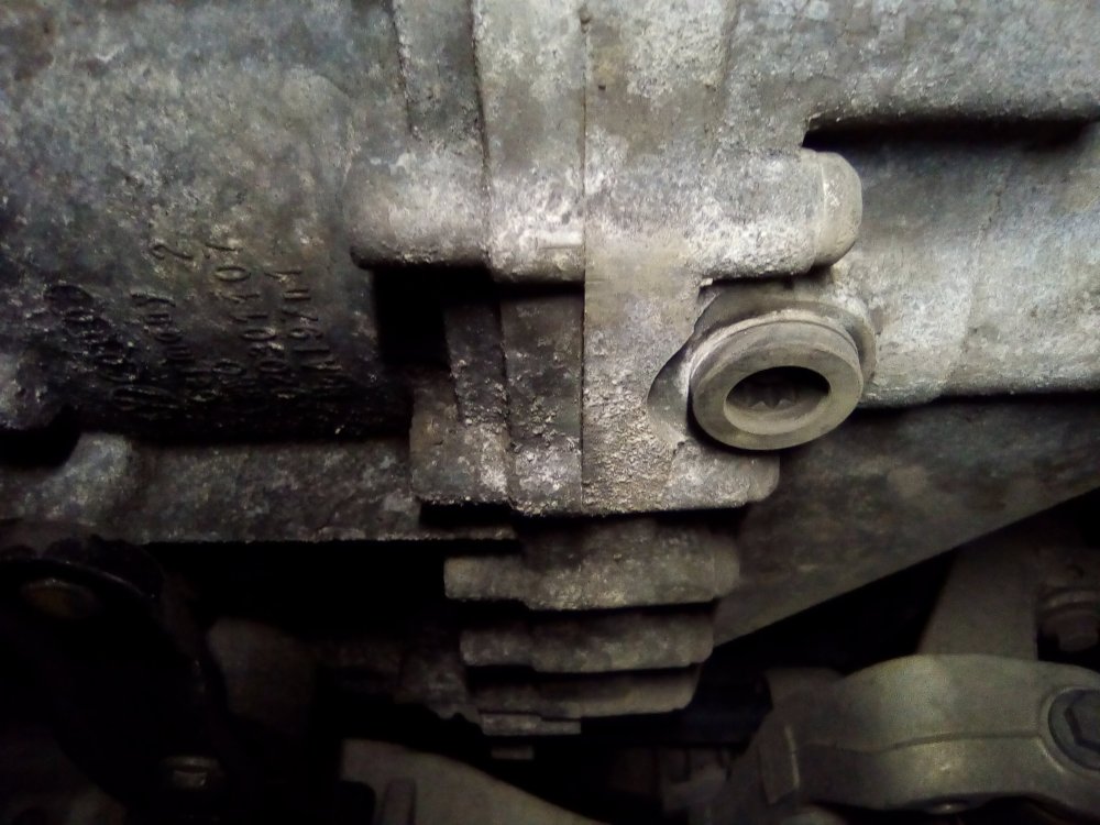

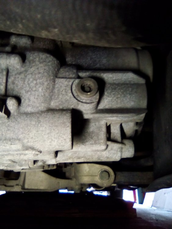

Anyway, I'm picking up from here. Already bought the FEBI product and renewed the oil. Btw, the filling and drain plugs (on my car) are the 12-point-star, anti-tampering style (with central pin accommodated by a corresponding hole of the socket - an overkill, if you ask me) - yours may be different, e.g. Allen wrench - check before proceeding. Both are reasonably cheap and widely available in the common 1/2-in socket guise.
So far, no sticky shifting, but temperatures are already higher where I live (around 5...10 deg C in the morning), so I'll know better by next fall.
You can see the three photos - sorry for the out-of-focus.
Hope this clears the desk for those of you who have had doubts similar to mine; thank you once again for your contributions.
