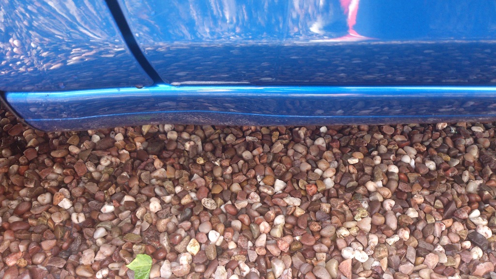

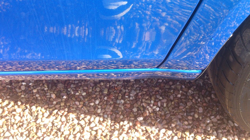

I have just come in from starting to give the fabia a deep clean after the salty mess of Winter. Last thing to wash were the sills and then realised the front two jacking points on both sides were caved in and buckled (passenger side actually flares out slightly and rather noticeable).
I've taken my wheels off twice to clean and wax them using the provided lifting jack, used in the correct jacking positions looking at the online manual and in car handbook (also the arrow indents on the sill). I was just about to use my new trolley jack today but now I don't want to further increase any more damage.
Any ideas on what can be done?

Ouch! Did you use the jack directly on the sill?!
it looks almost as if you've had the jack too far out from the actual seam?
I use a trolley jack with a block of wood combined with an axle stand, also with a block of wood, never had anything like that happen.

I have always made sure, double checked and triple checked its been in the correct position on the seam.. but I really don't know how this happened :(

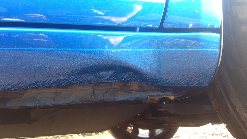

crikey, give that a couple of years and the sills will be rotten, you can see in one of the pics a couple of indentations where the jack has contacted the outer sill panel, sadly it looks like the jack has been used incorrectly or possibly its slipped.. that will need proper attention from a bodyshop to put that right
Yeah the drivers side sill is totally gone.. paint rippled etc.
Making me sick looking at them!

Grrrr, not a lot else to add that hasn't already. When I jacked mine up to change wheels with the supplied jack, it did slip off the seam but onto the inside as I was winding. I quickly unwound and as the car had hardly risen no damage. When I put my fingers under to feel why this happened I noticed lots of excess mastic (or similar) that had prevented the jack tying onto the seam. Looking at the first picture I notice square creases on the outside. Either the jack slipped and you didn't notice or it was placed wholly on the outside of the seam. I feel your pain. I think it needs repairing sooner rather than later to save rust etc.. I'd be speculating if its structural or not.
Oh my god :( soooo sorry looks terrible as above you need it looked at properly as long term damage will occur, get it seen to sooner than later as all this rain and especially the salt on the roads will create havoc, once it starts warming up the salt will react much more with metal, go to a proper body shop with good reviews

Have you spoken to an independent body shop? They will weld there keys on and use a slide hammer to pull that back out, then a simple application of paint etc job should be a good un.
I reckon a couple of hundred quid should sort that out. I know a place in Widnes called R&L motors, they repaired a roof on a BMW 5 series for me and they also repaired a mates 206 that had bumper and head light damage, works was good an cash worked wonders....
Let me know if you need contact numbers etc.
It can be repaired , they will weld a rod on the area and pull the dent out with the slide hammer and then repaint , not the end of the world but goes to show what can happen if you arent really careful
Well dexter some really comforting posts for you, so shouldn't worry too much
They proberbly look worse than they are, it should be a simple job for a bodyshop to pull that damage out as mentioned above. Don't accept replacement panels or loads of filler as neither are required in this case.

Again either way if it has tried to have been stolen, the stupid minded idiots have cost me at least £630. (From 5 independent body shops and that was the cheapest with mates rates discount)
I'm going to have a very close look to see whether its just the sealant that has split, if so can just get some sealant and some race blue paint and touch up the areas, to then just have to deal with the damage.
