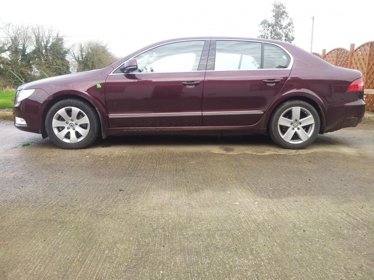

Having just gotten the superb, i am torn between which alloys to go with, the standard greenline 16" alloys, or the 17" monte carlo's from my old passat
Any idea's
Monte Carlo all the way!
I'd keep the skoda one's on keeps the car original and looks better to me personally
with skoda center caps ??
that is going through my mind, but does the car need bigger alloys than 16"

If they will fit, I'd put the skoda ones in. The Monte Carlos fill the wheel arches by a deceptively greater amount than you'd expect 17s to do.
