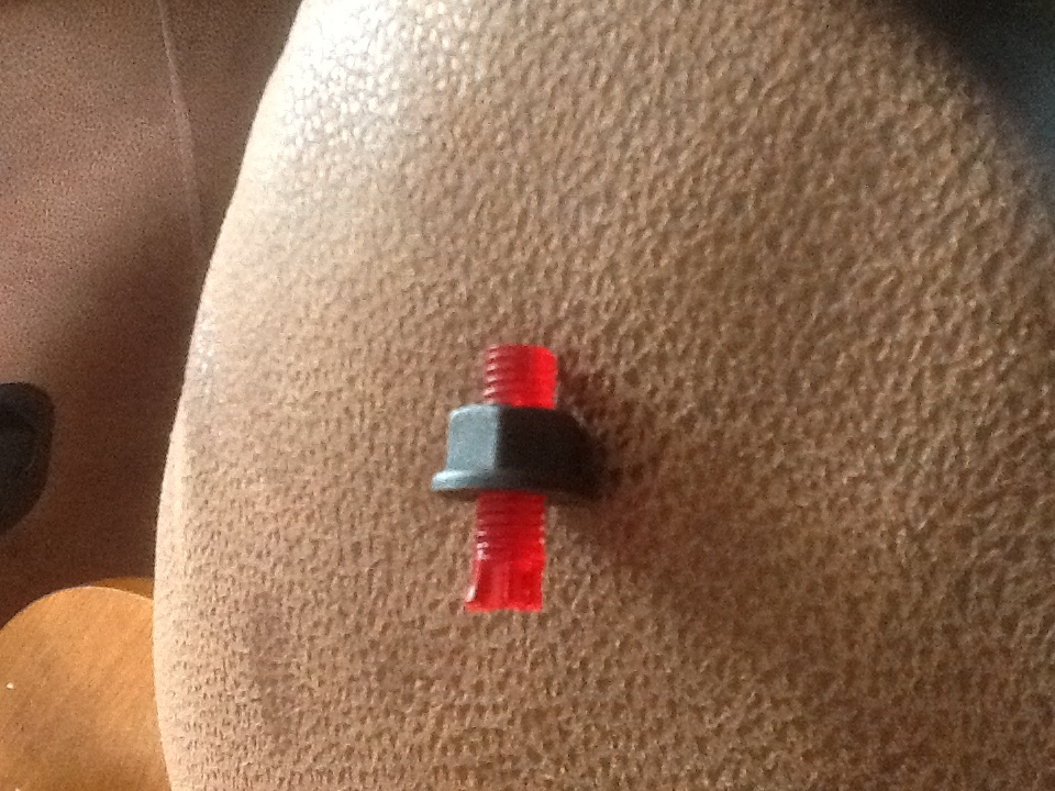

I noticed an annoying rattle from the rear of the car, it would seem to roll around as I cornered.
Turns out I too have one of the three studs sheared during the fitting of the high level brake light.
My question is now do I just ignore the fact the light is held on with 2/3 of the desired fittings or take it back to the dealer for a new light?
It depends on how much of a perfectionist you are. If it's held firm you could leave it, but personally I'd have it replaced (as it's warranty & to avoid any similar issues later).
Glad you got it sorted, that's exactly the same piece of plastic i pulled out from mine.. :)
The brake light seems to be fine with one missing stud - i'll mention it to the guys when it goes in for the first service but tbh i'm not fussed about replacing it - it seems fine as it is.
Had exactly the same thing in my Combi.
10 minutes spent stripping the panels off and finding the culprit.
Job worth doing.

A rattle in my brand new vRS turned out to be one of the plastic studs and bolt that holds the high level brake light in place - it had sheared off (guess over tightened during manufacture) and was rolling around inside the plastic trim on the inside/top of the tailgate.
Drove me nuts for 3 weeks before I found it!
