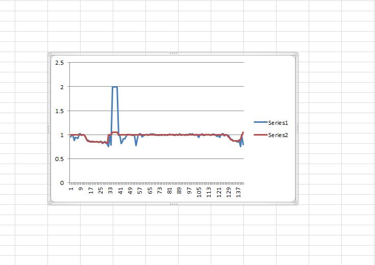

Should I be logging rpm in with this as well ??
Heres block 31 on it's own under normal driving traffic
LOG-01-031-xxx-xxx.CSV
Looks like the actual and spec are slightly out too me !!
post-8833-0-43450300-1367415750_thumb.jp
Shouldn't they be equal ???
They should be overlapping each other if you use Vag scope, also log rpm because it`s essential. AFR falls from 15ish to 11ish as rpm increase. Don`t log crap,push start when you are in 3rd gear and immediately stop as you hit 7000rpm.
Also don`t take your foot off the pedal, it MUST be pushed all the way.
Edited by Gonzaga
How do I get rpm to show on the left of the excel graphs ??

It logs in lambda not volts ;)
