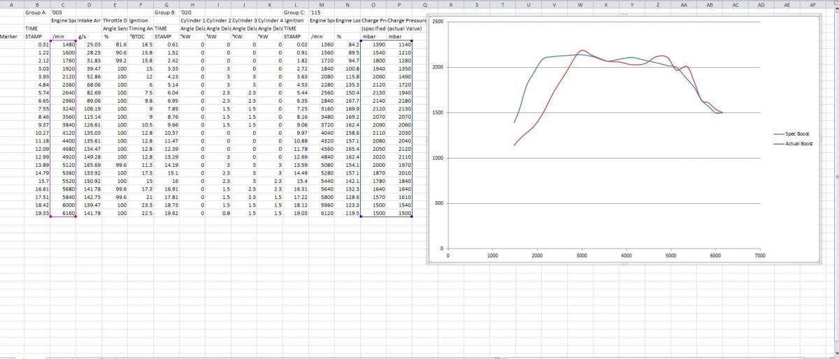

Boost and timing
post-8833-0-23890500-1368231652_thumb.jp
Timing looks spot on according to what I read, most mappers aim for 3 degrees of pull on an SUL map.
Obviously the boost is an issue, but as I can see there is no relation to the timing pull, unless I'm missing something.
Funny looking at that and knowing how the car feels I can almost see it happening on the graph

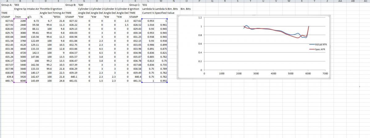

So I think I have a boost leak again, did an AFR run too and got this, think it's ok, graph makes the numbers look bigger, but if you look at the figures it ain't out by much.
AFR and timing
post-8833-0-02298200-1368231948_thumb.jp
Check out the timing pull, it seems completely random.
Get boost sorted and come back and look at timing, if the ecu is controlling it it shouldn't be a problem..... Hopefully

It's going lean at 5500(ish) rpm so at that time it drops the boost off (which it will do by closing the throttle).
Is that why the throttle angle is dipping slightly to 99.6% I take it the lean is the blip on the AFR graph up the top end ??
I got get surging all the way through from around 3.5k
Do you like my graphs, lol
It's possible thats why block 3 is reading 99.6% but if you look at block 060 (I think) you should see your asking for 100% and it will be closing it, to force the boost to drop and the fueling to go rich.
The boost fluctuation looks to coincide with timing pull (remember mine was doing the boost fluctuation thing too), but it doesn't seem to be going lean at that point (and neither did mine), but I guess the ecu could be doing other stuff in the background to try and compensate somehow (purely a guess).

Whats now confusing me even more is that timing pull is minimal on the WOT run, yet on normal driving its still all over the place.
So what causes laen at high RPM I wonder.

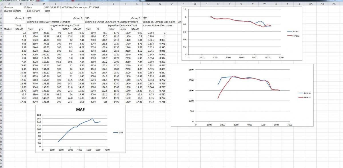

You have maximum air flow 166g/s@5200rpm which imho is a little low down. It should be around 5600-5800rpm. And according to this data you have roughly 207hp (crank).
This could be a problem with MAF sensor, showing less air flow than actually flows through the TIP or your fuel pump needs to be upgraded.

Fourth and fifth,well I let the file tell the story
Boost maf O2 2003.xls
post-8833-0-91691400-1368478961_thumb.jp
It's still leaning out above 5k, but I notice the MAF is dropping off at roughly the same point. So is it possible it's drawing unmetered air which would lean or have I got that wrong ??
