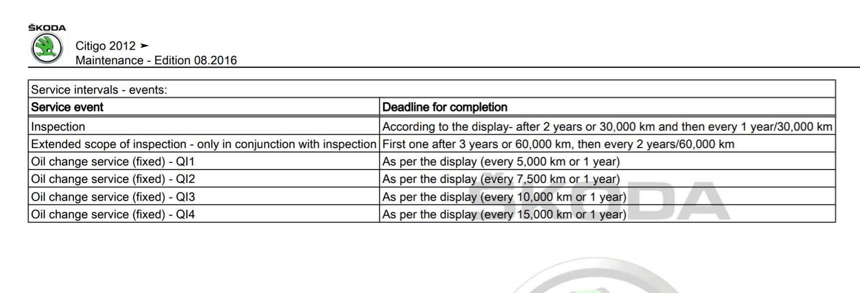

Extended scope of inspection

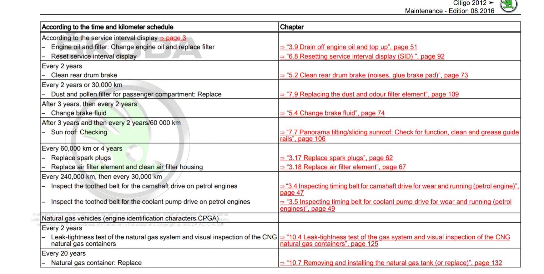

And finally any additional work/inspections...

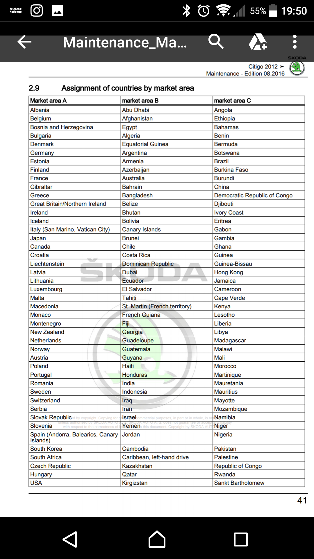

Please note, that inspection intervals very from market to market. Values from the previous posts apply ONLY to countries from band A (includes Cyprus - not shown on this page). Groups B & C are NOT complete on below screenshot. Other groups may have different recommendations.
Sourced from 2016 Skoda Citigo Workshop Manual.

I've just booked our Citigo in to our local Skoda dealer for a minor service, brake fluid change and MOT. It will turn 5 years old in early October and we've owned it from new (to a factory order). We bought the car from this dealer and have been very pleased with the service they've offered throughout, both pre- and post-sales.
When I called, the guy on the service desk was quite insistent that our car is due a cam belt and water pump change at 5 years. Even when I challenged that, saying that I have read the official service manual and it is only due an inspection at 5 years, he stood by his original recommendation. I've left it for now. It does seem though, that Skoda UK are not correctly communicating the schedule to dealerships, or at least it's patchy. Shouldn't the dealerships themselves RTFM though? See the 5th post in this thread:

For the sake of a couple hundred quid (independent) I had my wife’s car done at 5 years or thereabouts, even with only 11k miles. We have owned it from new and want to keep it till it dies; no point messing around. Was told by Skoda dealer 5 years or 160k miles, which ever comes first.
No need for water pump as it’s the other side of the engine and on its own separate small belt.
