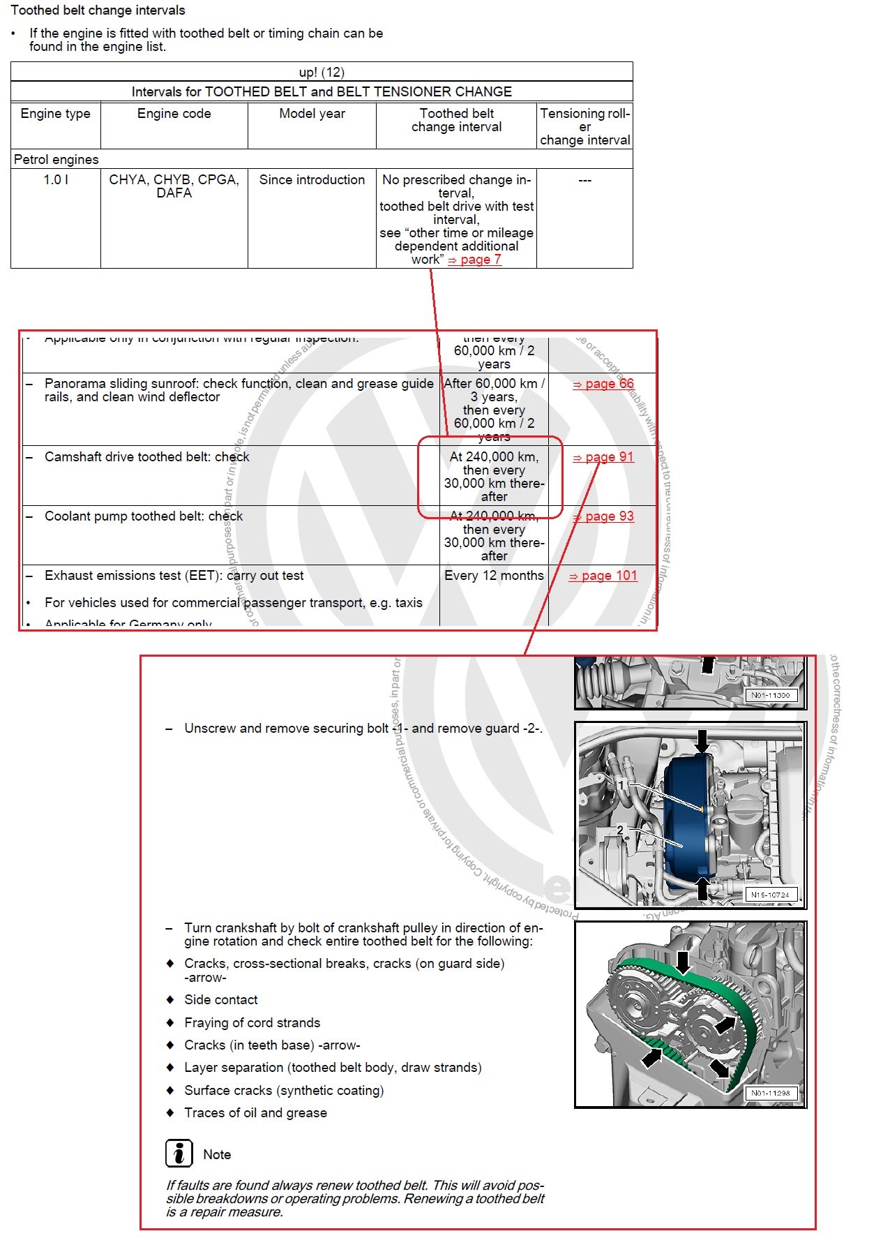

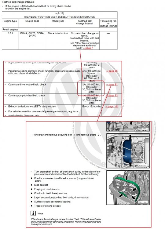

This file from the VW Up! owners site regarding cambelt servicing.
240k km (149k miles) and no specified time limit.
All information from the VW Up workshop manual.
Edited by Snaefell
And it is same for Citigo. I have workshop manual for Citigo but I don't have rights to share it.
