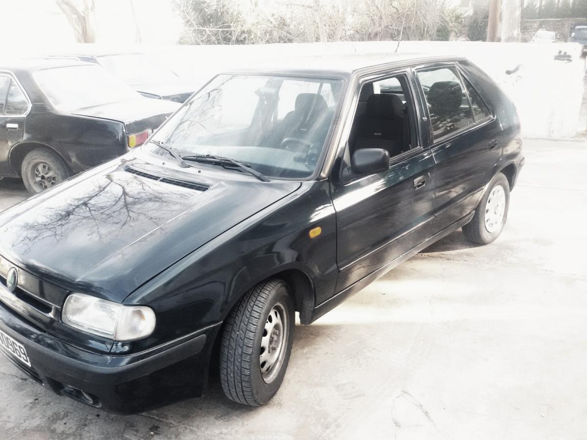

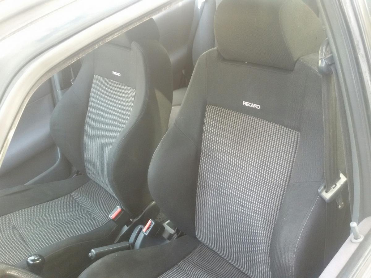

Here is my rocket in pocket 1996 GLX
Like the seats :)

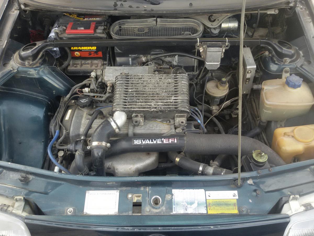

Hello Omar, can you tell us more about the engine? I can see Toyota on it but it looks very compact. What size is it? How easy was the swap and does it include the gearbox as the gearstick I can see in the interior picture doesn't look standard either.
Sure ...
This engine is from Toyota Glanza V it's 4e-fte 1.3L turbo charged engine
The following link is for engine full specifications from Ehow site
http://www.ehow.com/list_7491981_4efte-engine-specifications.html
Okay about my swap it was a little bit difficult to be honest because I make custom mounts without making major modification in Felicia engine bay I make only three 8mm hole's in gearbox side & four hole's in the chassis in other side to fit engine mount & luckily Skoda rear gearbox mount fit in Toyota gearbox after lengthened with spacer
Ohh yeah I remove the rear seat heater duct to place gearbox stick mechanism & make small slot in car floor to pass shifter cable's
Sorry if somehow my english is bad
Edited by Omar Sako
Okay, that sounds interesting. You could do with a decent set of wheels to handle all the extra power. The standard wheels can barely handle the power of the original engine. Or maybe the roads in Jordan are all straight.
Dont worry there's nothing wrong with your English. I'm often amazed when we get people on here from all over the world talking to each other in English when it's not your first language.
Also, that looks like an Opel Ascona behind your car in the last picture. I haven't seen one of those for years.
Mr yoss
Sorry for late  ...
I'm planing to change the original wheels with bbs 15-inch rim's with 195/50 tire's sit .
I like the car when it's look like standard and had aggressive engine on it most of Jordanian people do body modification with big rim's and keep engine standard , that was the main Idea .
Note that most of the road's in jordan are corners and mountains .
hhhhhh you could recognize my brother's favorite 1976  Opel Ascona B ...?
Hi Omar, I have 195/50 15s on mine and they work well. Are the BBS wheels like the VW Golf ones? That sounds good, they will improve handling greatly but still look sort of original. Or at least they will suit the age of the car.
Be good to see some pictures when you do.

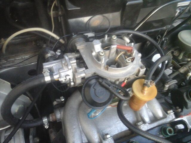

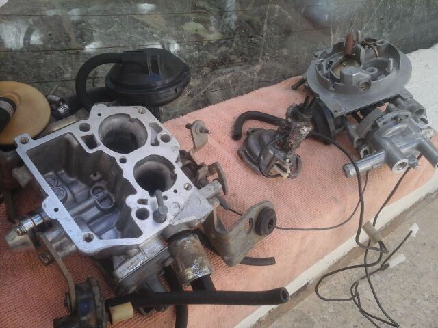

this is my lovely 1.3lx carburated felly, which i greatly take care of. most of the work on it done myself including last project was strip down and rebuild of the carburator as shown in pictures :)
